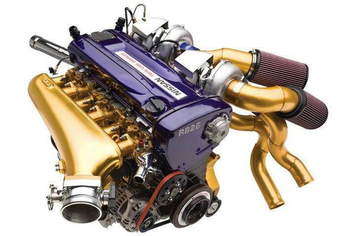

Hey Sam. How's the RB going? Look anything like this yet?

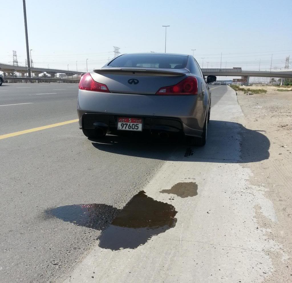

Here's a summary of the past two months. It all started when my driveshaft started vibrating. I was daily driving my G so I figured I'd take it to the shop after work. I didn't make it to the shop:
The driveshaft snapped and tore a piece of the gearbox with it, it also made a nice hole in the floor. I got replacements from the salvage yard and put everything back in. Took the car out of for a test drive and zero driveshaft vibrations thankfully. The gearbox however was making all sorts of clicking noises. The gearbox I was sold was a POS basically. So my mechanic opened both gearboxes up and used the best of both parts to make a great gearbox. Everything went back in and the car ran great.
I then took it to the dyno to tune it (hoping to share some good news on here) and someone had stolen the AFR sensor from there. So that had to wait. I drove back home and the next day, I realized the engine started acting up, felt like it was misfiring at a certain rpm. AFR gauge started showing a very rich reading and the car was blowing black smoke even on idle. I hooked up my laptop and it turned out the MAP Sensor reading was frozen and wouldn't respond. Babied the car back to the shop to see what's up. My mechanic called me this morning to tell me that the MAP Sensor hose has come off the intake manifold. So the plan is to go to the shop on Saturday and hopefully tune it. Whoever's out there casting all these spells on my car, will you please chill?
