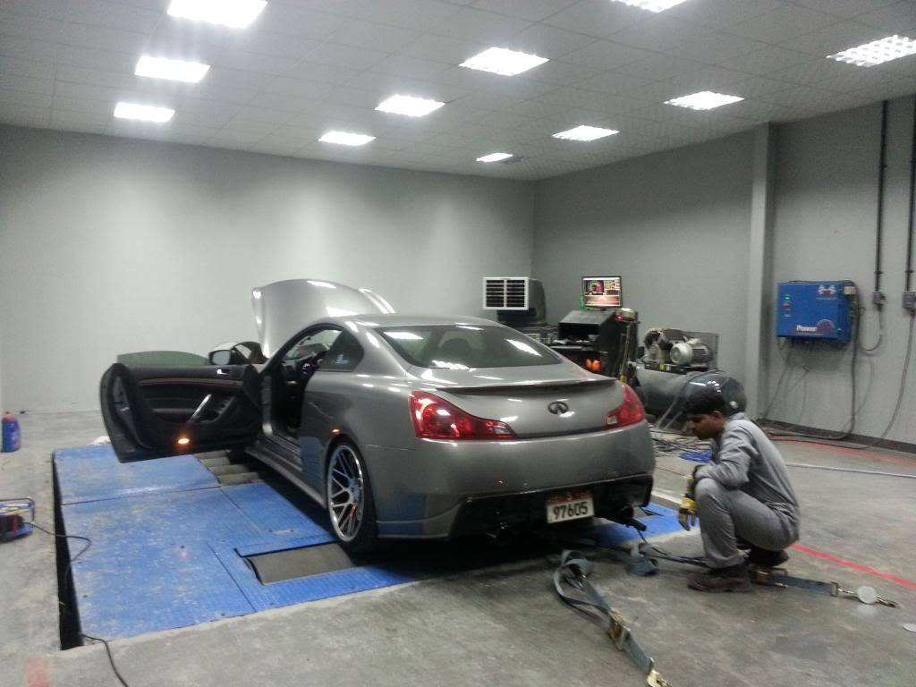

Old Oct 18, 2013 | 04:20 AM
  #595
G37Sam's Avatar
G37Sam
Joined: Aug 2008
Posts: 12,173
Likes: 244
From: Doha, Qatar
It feels good to have the car on the dyno finally (and not blowing up haha) I had to stop before I maxed out at 9psi due to the fuel pumps overheating and dropping in pressure from all the heat soak. On the road it was rock solid. I'll be back soon, enjoy this video in the meantime

isn't 320whp @ 9psi kinda low?
What numbers are you shooting for?
As I mentioned, I had to stop early because the fuel pumps overheated, so even the conservative 9psi of boost was not maxed out. The 6266 was not designed to run below 1 bar anyways, I just didn't want to run it on 2 bars from day one.
