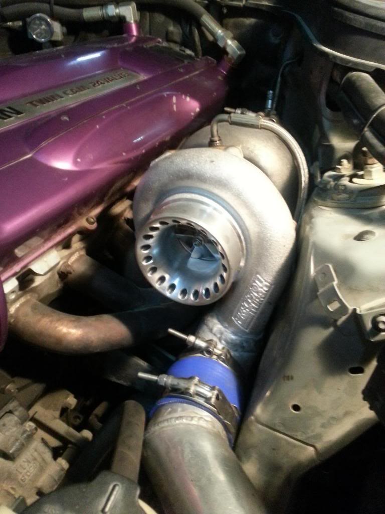

I was hoping to update this thread with a dyno sheet but unfortunately, that didn't happen. What did happen though was that the ECU kept cutting at full boost at around 5000rpm. My AFRs and fuel pressure looked fine. I hooked up the laptop to try and figure out what was causing the cut but without any luck. The ECU cut one last time and the engine died. Deja vu. Parked on the side of the road in the middle of nowhere, I start the car praying in every religion there is out there that the engine is fine but no luck, there was a party in my crankcase. An episode of Top Gear later, my flatbed shows up.

On a positive note though, that 6266 turbo is one hell of a beast! I saw positive boost almost instantaneously, and at around 4k rpm, 19psi! Don't get me started on how awesome it sounded too! Can't wait to get it up and running.
