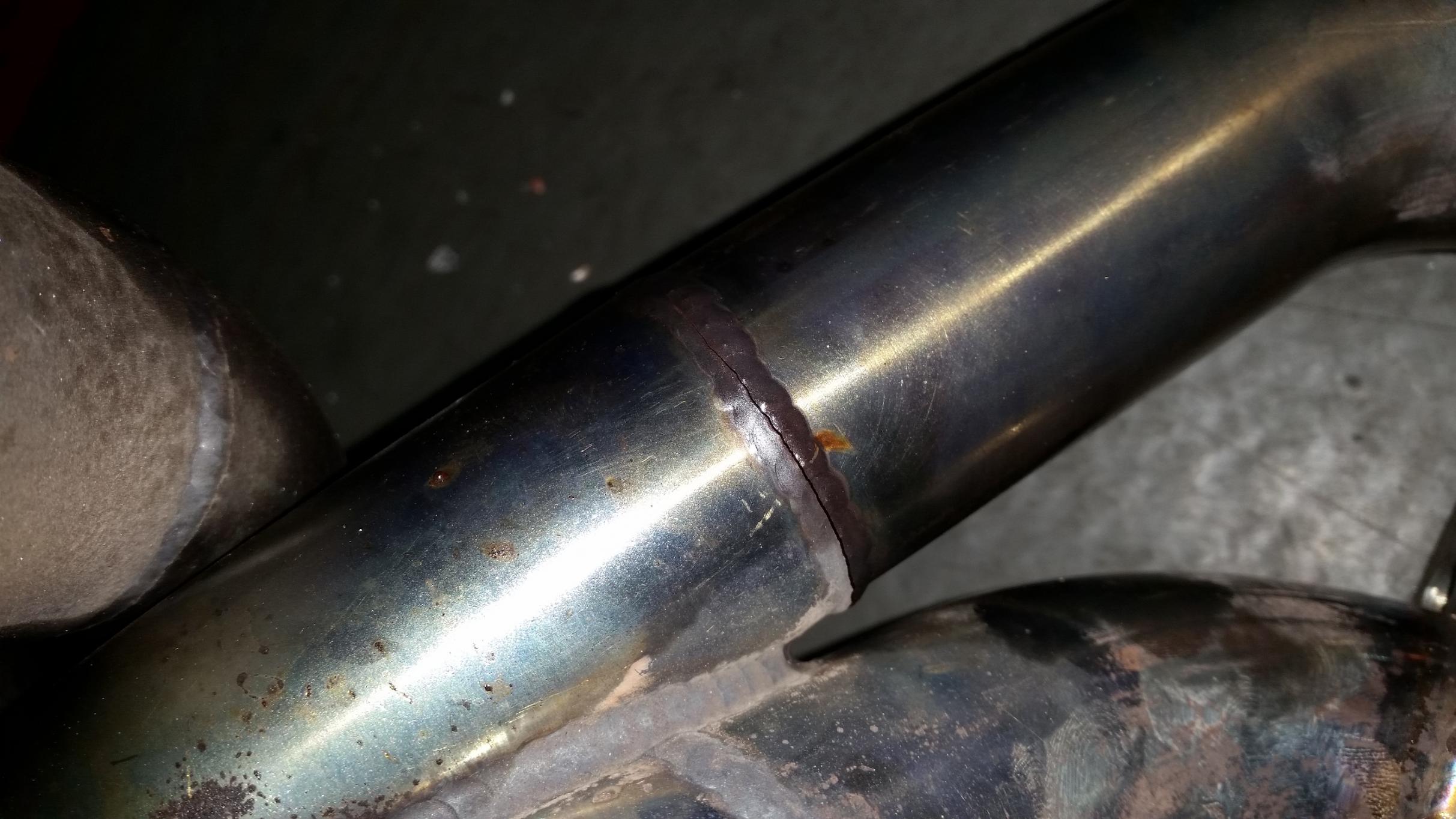

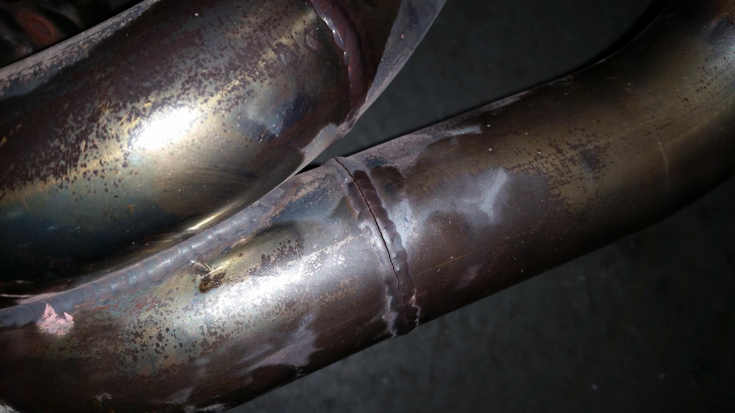

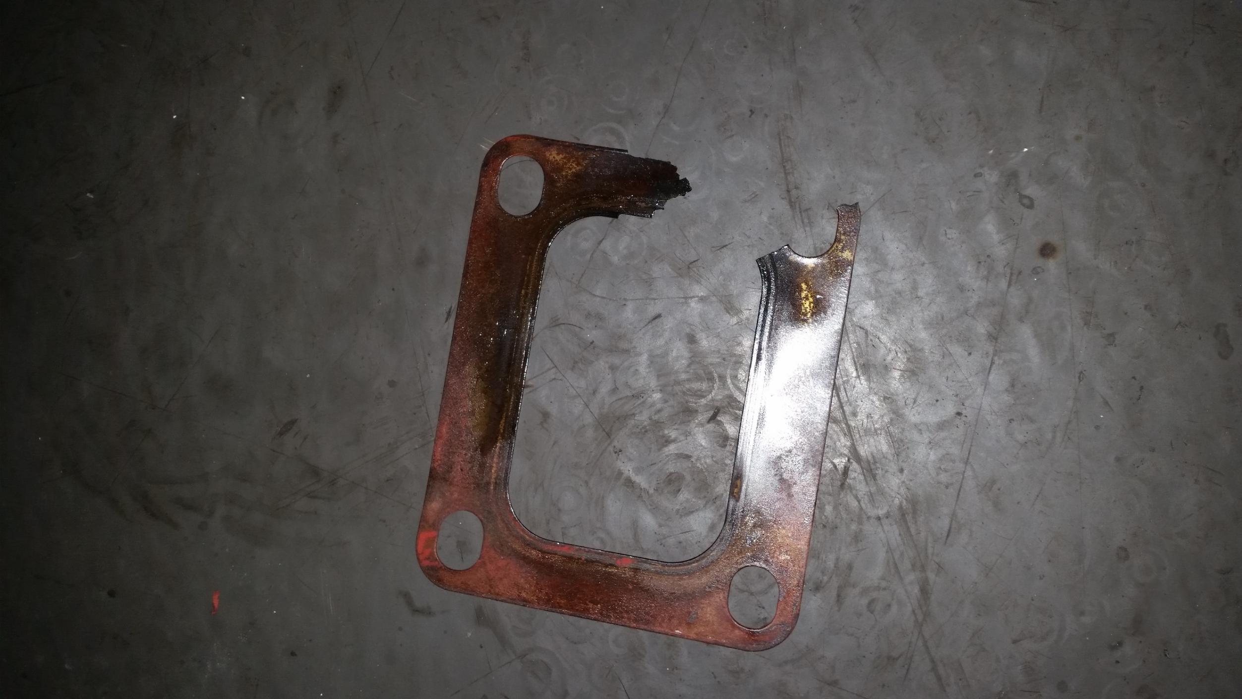

So I've been raping the car a little ever since I got the high boost tune done. Notice a little coolant leak and the exhaust sounding a little funnier.
Sent her in for a check and surprise, the water pump has taken a dump. There was also a crack in the turbo manifold.
Lesson learnt, never cut corners. I bought a replica turbo manifold locally for $220 because I didn't want to spend $1500 on a decent crack-proof manifold. Two manifolds later, it definitely proved it cannot withstand the heat. The used water pump I had in was a gift from a friend who wanted to support my swap. Going with a Nismo N1 waterpump now. What doesn't kill you only makes you stronger eh!

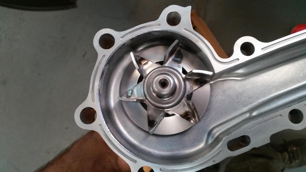

RB26 N1 waterpump:

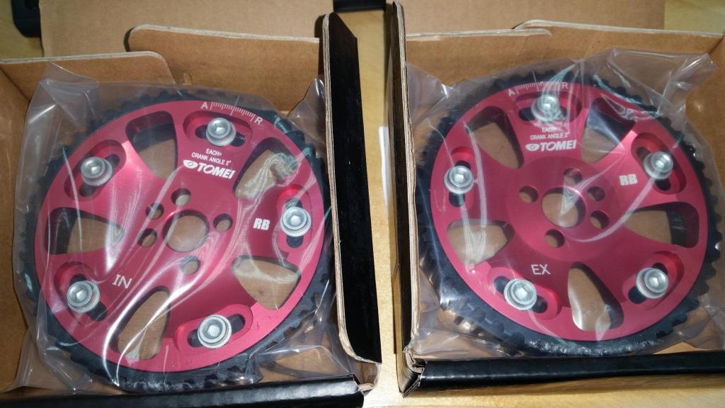

Figured I'd throw in some adjustable cam gear goodness from Tomei while the timing belt is off

And here's what an RB does to cheap Manifolds and Gaskets

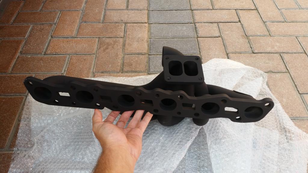

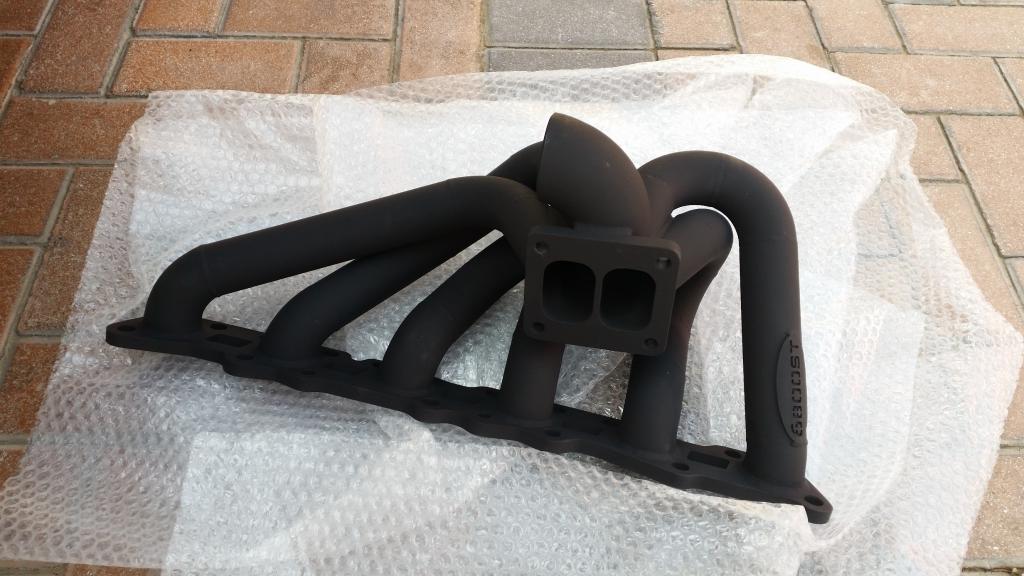

And of course, the manifold is too big for the G37 engine bay. Going to have a look to see what'll need to be modified otherwise that piece of art will be sold to one lucky son of a gun.

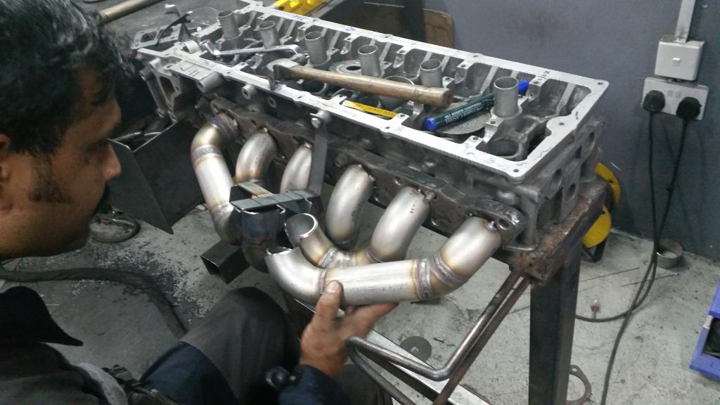

Custom Manifold in the making!! Lets hope this will be my last one.
