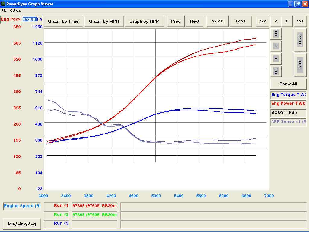

I'll spare you the long intro's. The weather's getting nicer and I decided to put her on the dyno see how she'es doing:
She put down 485whp @ 0.9bar (low boost setting) and 615whp @ 1.6 bar (high boost setting). The car actually saw 1.7 bar when I datalogged it on the street. NOT COMPLAINING
Here's a screenshot of the High boost run. Was too excited to adjust the Torque Axes Scale but you get the picture.

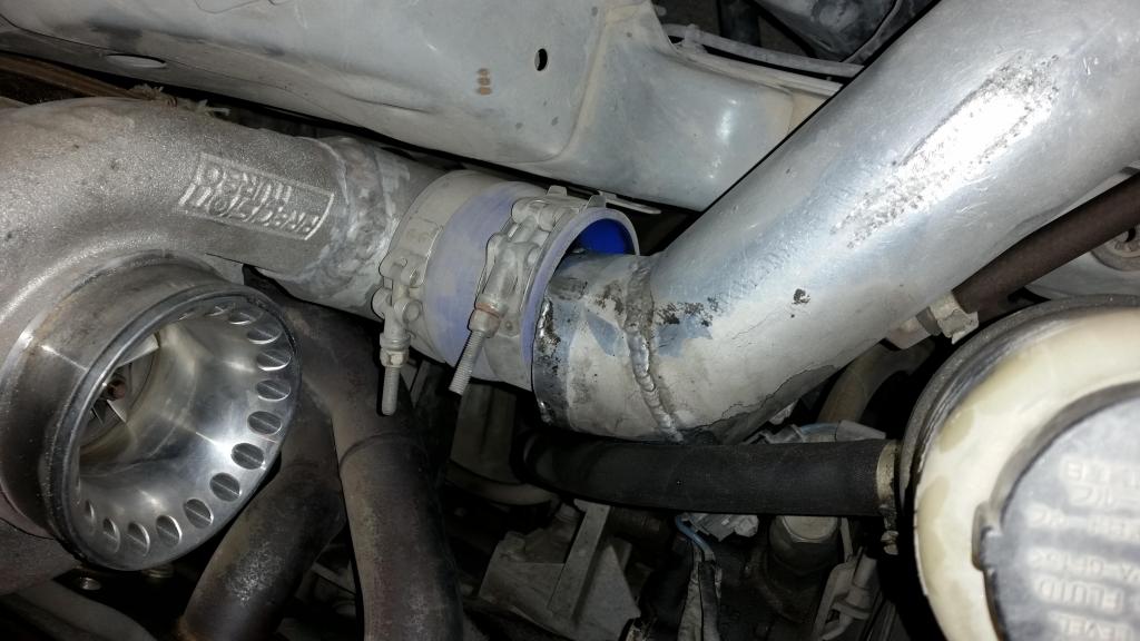

I got too excited on the road and with all the boost the charge pipe eventually came off, thinking of just welding that fcker in:

What a smooth power curve. ...

Took a few runs and countless OCD haha

Try scaring the end of the charge pipe or weld a lip on so it doesn't blow off as easy v clamps ftw tho

Forgive my ignorance but what do you mean by scaring the end of the pipe?

What i did for my boy's car was i took a grinder or a dremel and made the end pipe surface rough so it won't be smooth. Gave the coupler a harder time coming off.

That's probably not the best idea because you're reducing the total smooth surface area for the coupler to grab. If you keep the pipe smooth and spray something sticky on the pipe and coupler (like hairspray) it will hold better but really the best solution is to tack weld some raised spots on the end of the hard pipe for the clamp to butt up against so it cant slide. Or even better a bead roller. Here's a google image search showing a few different solutions and even tools to do the job: https://www.myg37.com/forums/**************/5G22o1
The vice grips is one i've heard many people using in the past to make their own pipe beads.

Yeah I think that's what my shop is doing as we speak. He's putting a 2bar guarantee too haha
