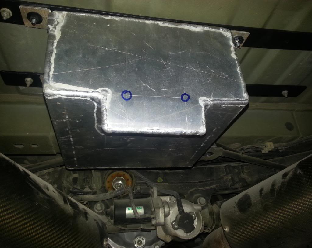

Surge Tank's coming along nicely:

If you guys don't mind me asking, what's the purpose of a surge tank?
Glad to see the build gathering momentum, can't wait for some videos/times.
Old Sep 16, 2013 | 09:03 AM
  #583
G37Sam's Avatar
G37Sam
Joined: Aug 2008
Posts: 12,173
Likes: 244
From: Doha, Qatar
The factory fuel mount assembly only accommodates one pump and so far, there are no aftermarket solution to mount two pumps. CJM has one for the 370Z's but I don't think it will fit our tanks.
Another problem is on tight right handers, all the fuel jumps to one side of the tank leaving your fuel pumps starving. A surge tank prevents that since it is always full.
Ok, so it is an alternative to having two fuel pumps in order to prevent fuel starvation. Thanks for the informative reply!
You can have two pumps in tanks, the GTR has them OEM. It's just not an option for us yet.

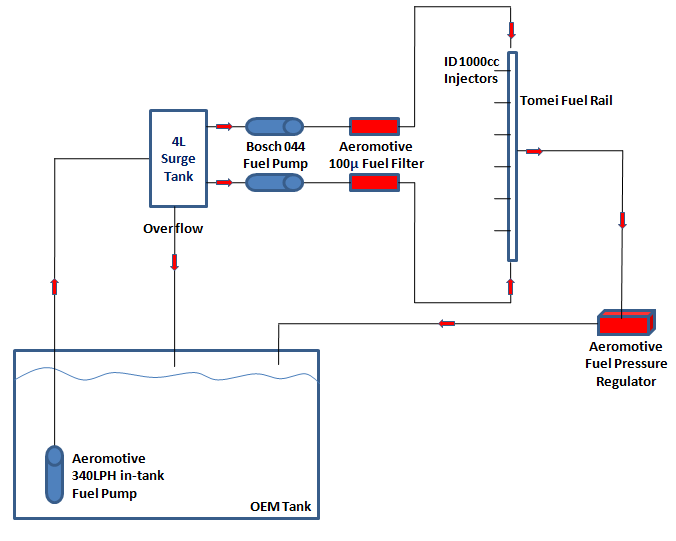

Here's what my fuel system looks like to give you an idea:
