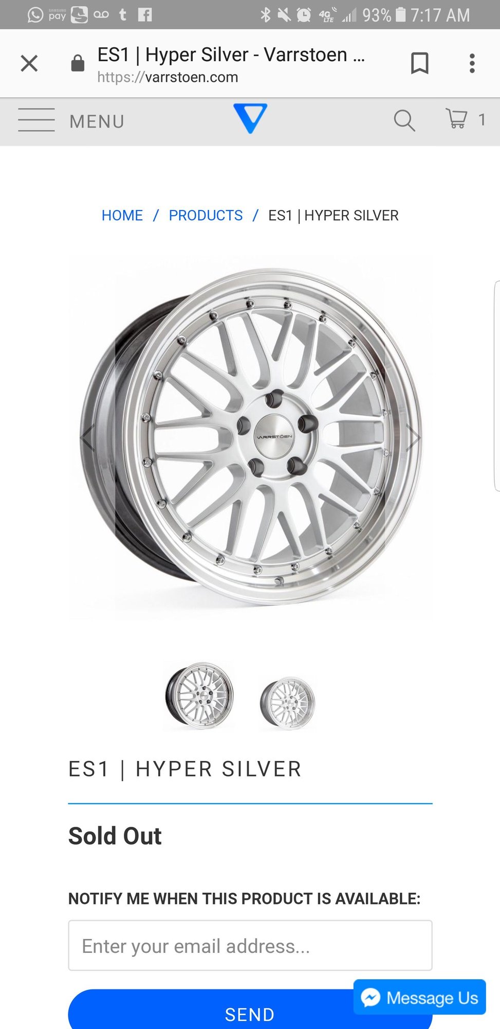

Asking for a friend
19x9.5+22, 10.5+22
2011 awd sedan
Stock height
Does that work and what tire size is recommended?
