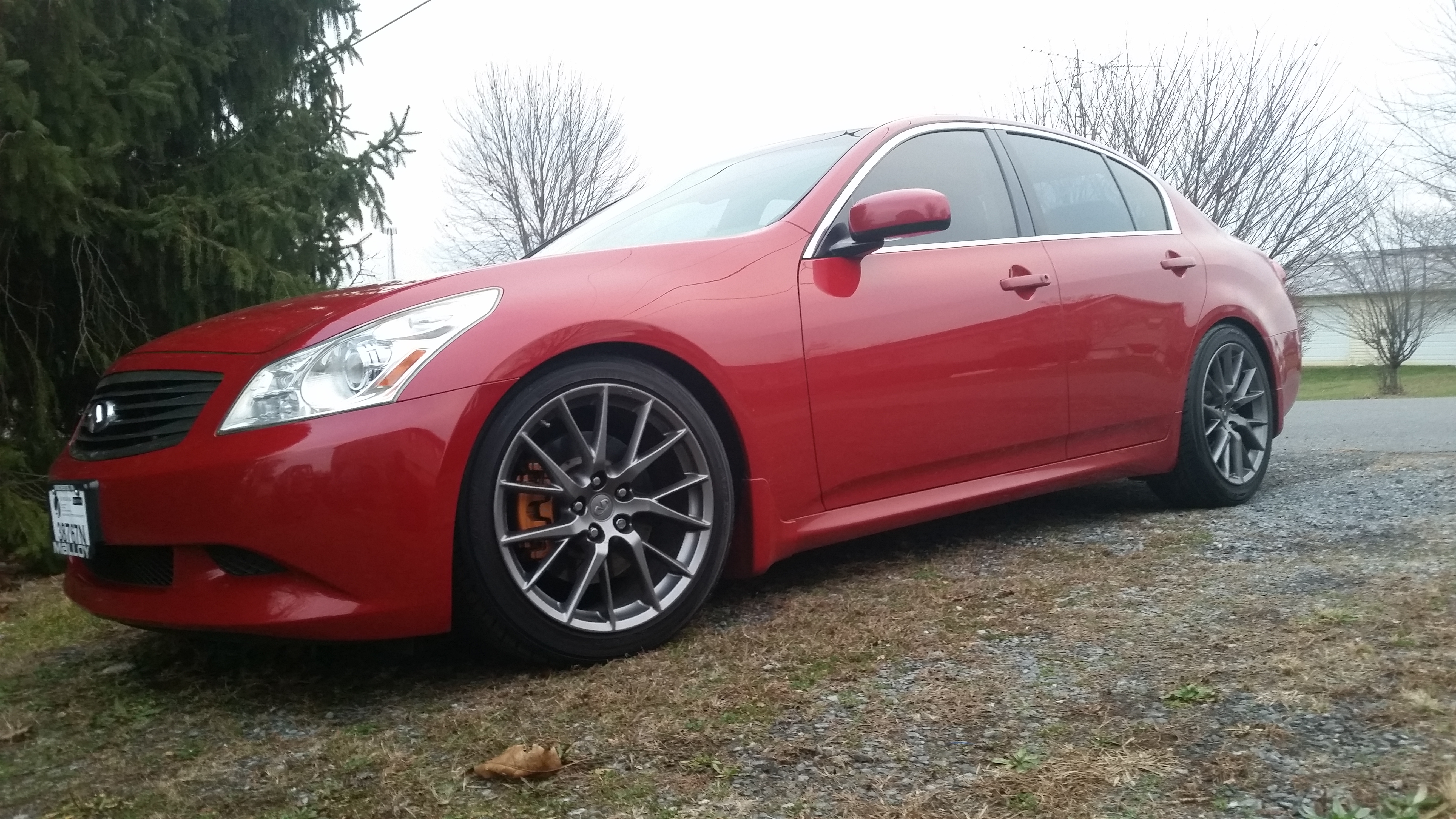

  #2223
DzMiniz's Avatar
DzMiniz
Joined: Jan 2016
Posts: 9
From: WV
2008 RWD Sedan
right now on IPL's
Swift Springs
F - 8.5 +43 255/40
R - 9 +45 275/40
Looking at ESR sr08
I'd like to keep my tire size or close to it. Nothing stretched.
Just looking for a bit more width out of a wheel, something flush.
Would the 10.5 in the rear be too much? +15 is what they have listed on the website. Some other close wheels, I saw +22.
Should I go with 9.5 all around?
or just buy spacers for the IPL's and go with them?
Attached Thumbnails The OFFICIAL "I have a wheel offset / tire fitment question!" thread-20151216_074944.jpg
Old Mar 16, 2018 | 09:10 AM
  #2224
I'd get spacers and keep your IPLs, a higher quality wheel and they look really nice on your red G.
On a sedan, a 10.5 +45 is typically a flush fit, the much less positive offset for those wheels will really be poking big time
Thanks
I was looking to maybe get something non-oem.
Still up in the air, lol
f- 10mm
r - 5mm
spacers ya think?

15mm front and 10mm rear will get you nice and flush w/ the tires you're currently running.And if you do decide on aftermarket wheels you should be able to find the exact offsets for the perfect fit without having poke or fender issues.

Originally Posted by DzMiniz
2008 RWD Sedan
right now on IPL's
Swift Springs
F - 8.5 +43 255/40
R - 9 +45 275/40
Looking at ESR sr08
I had ESR SR08 19x9.5 +35 all around, they were the perfect fit with little camber and no fender mods. Anything wider and/or less offset and you'll be asking for fitment trouble.
thanks man.
They sure look good on there.
nm, I found the tire size.
Wish I would've seen your fs thread!
