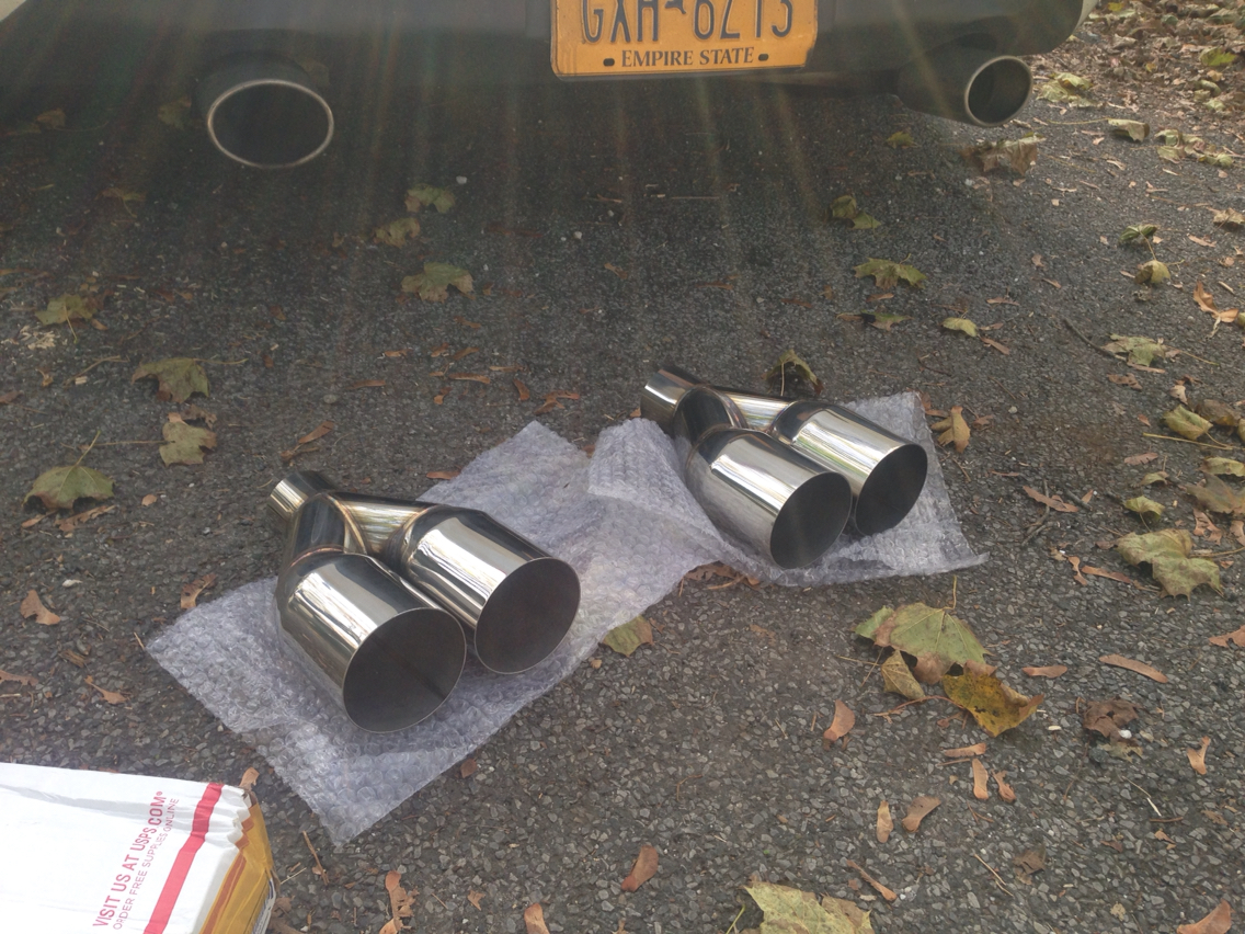

The OFFICIAL "I have a wheel offset / tire fitment question!" thread-photo4294966819.jpg came in today
