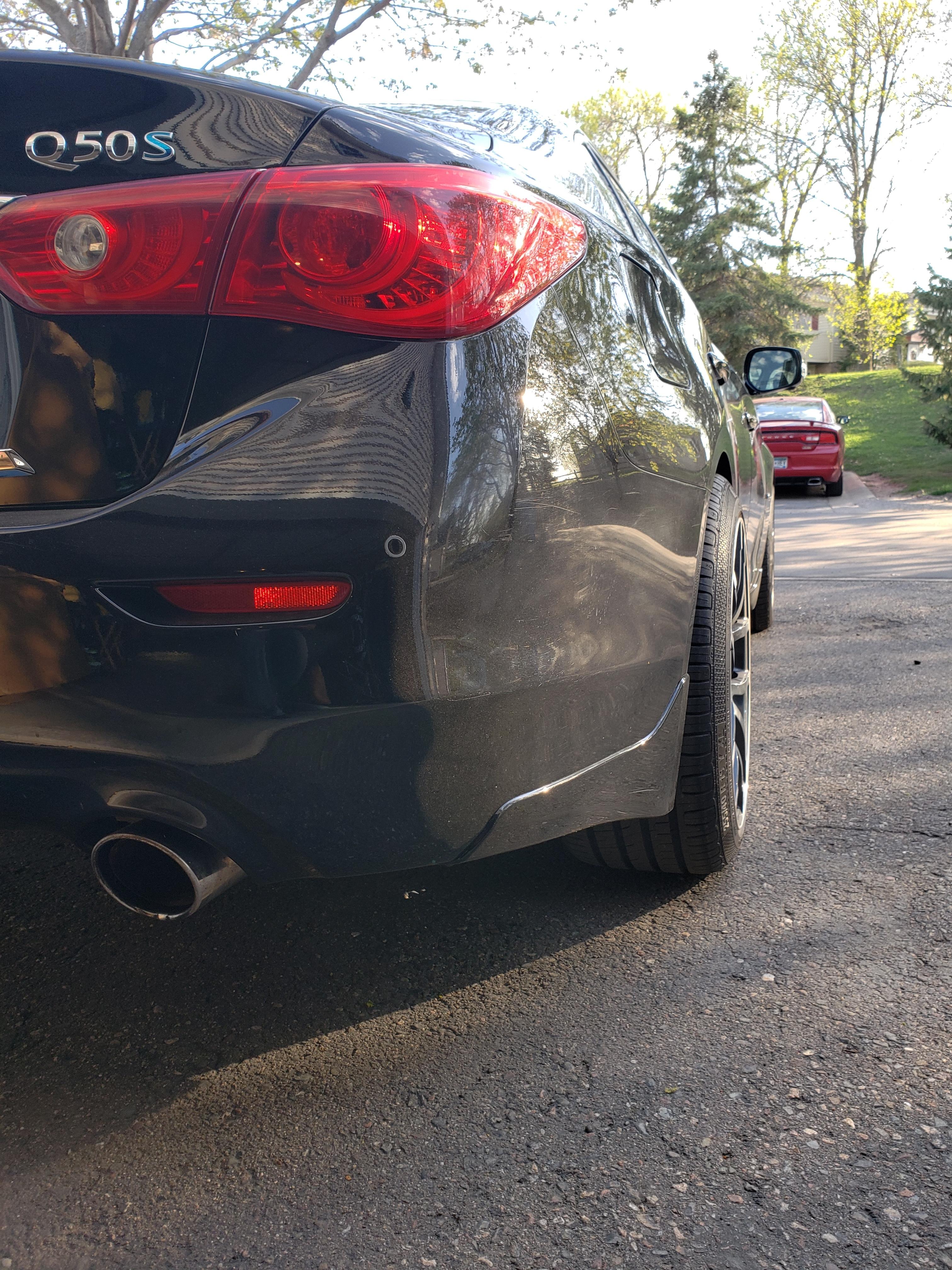

Blnewt need your help once again, was running 2554019 on nismo wheels on the G awd, was wondering if that same setup would apply to the q awd model
Old May 7, 2018 | 07:44 PM
  #2260
StarKiller's Avatar
StarKiller
Joined: Apr 2016
Posts: 21
From: Twin Cities
Here is the poke
Attached Thumbnails The OFFICIAL "I have a wheel offset / tire fitment question!" thread-1525736623838.jpg
Old May 7, 2018 | 11:28 PM
  #2261
Not 100% sure of the fit at the fender w/ the Q, it seems that they are running a bit more positive offsets on their OEM wheels though, like a 8.5 +50. So there may be more poke w/ the Q setup.
