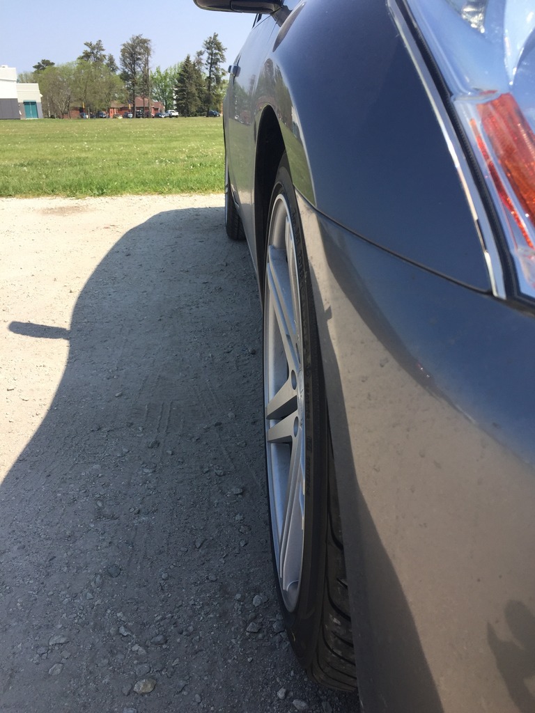

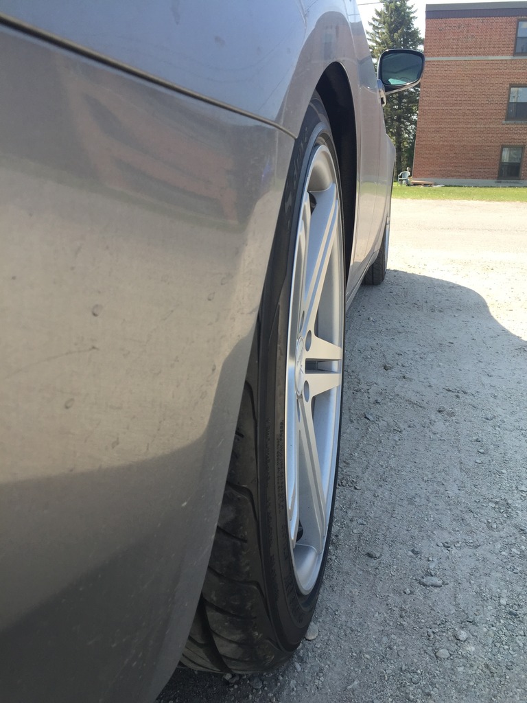

Old May 26, 2016 | 08:54 PM
  #1451
camry90's Avatar
camry90
Joined: Jan 2015
Posts: 15
From: Montreal
19X8.5 +38
Old May 27, 2016 | 12:51 AM
  #1452
Likes: 4,952
Looking good^^^Got a side shot?
