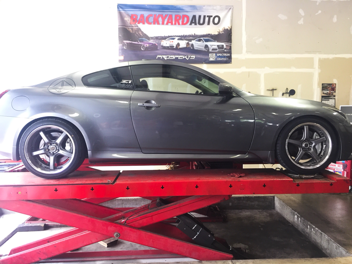

TBH, everything looked pretty good until you posted that 4th pic, that camber looks to be quite higher than a -2, or is the car on some heavy angle that the pic isn't really showing??
That 4th pic w/ that much of the outer edge of the tire off the ground will result in pretty poor wear, adding even more camber, yikes!
I know you're not too opposed to selling the wheels, I think I'd look into that, especially since stretched tires aren't something you're wanting to do.
If that 4th pic is an anomaly and your camber is truly only -2, then another .5 camber would be a plan.

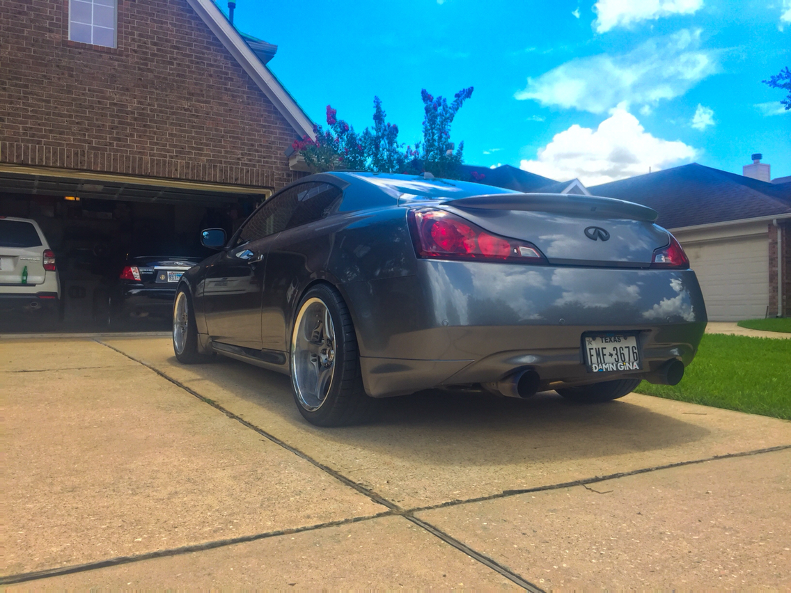

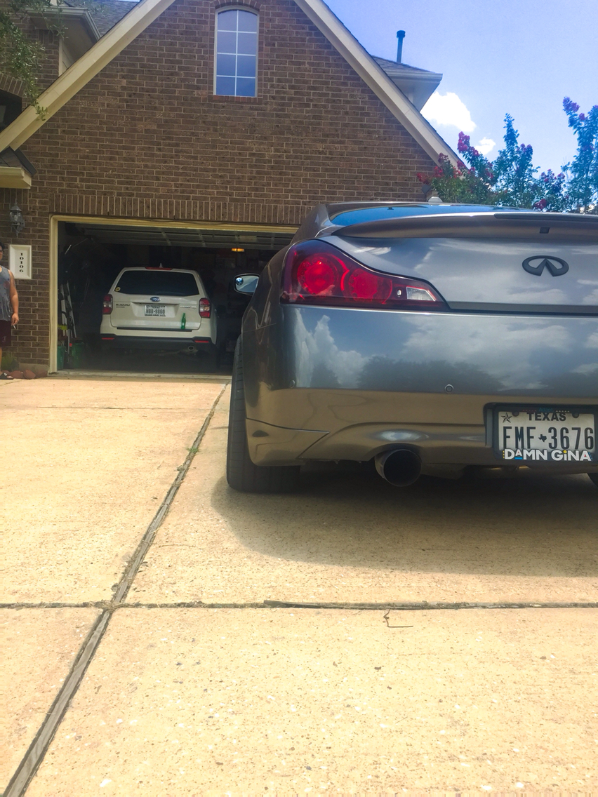

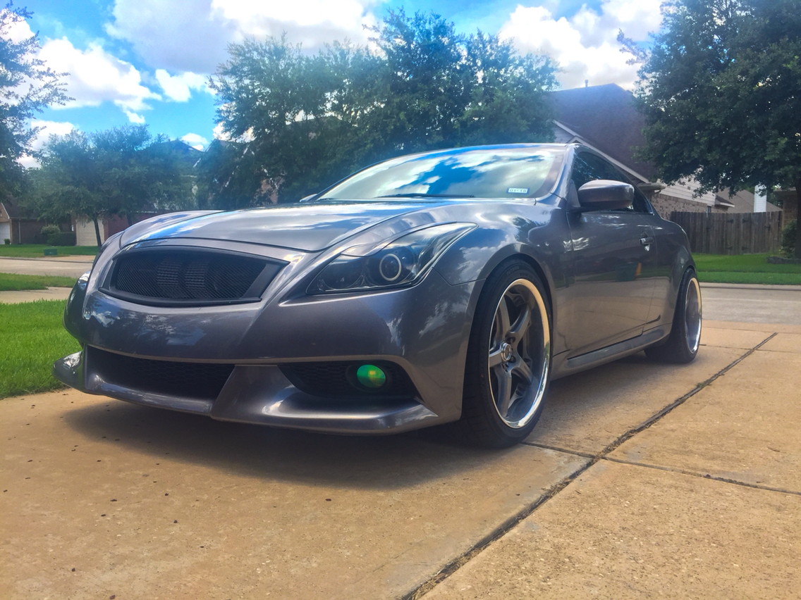

Here it is guys! Lifted the front up .25" and rear .5". Lifted the front as well so I don't get a drag car rake look. Added a bit camber to the rears and now sitting at -2.5. Rear wheel still pokes out but slightly more pleasing to the eyes. No more rubbing issues for me. It's kind of hard to tell if I added more camber in the pic but in person it looks fine to me.
