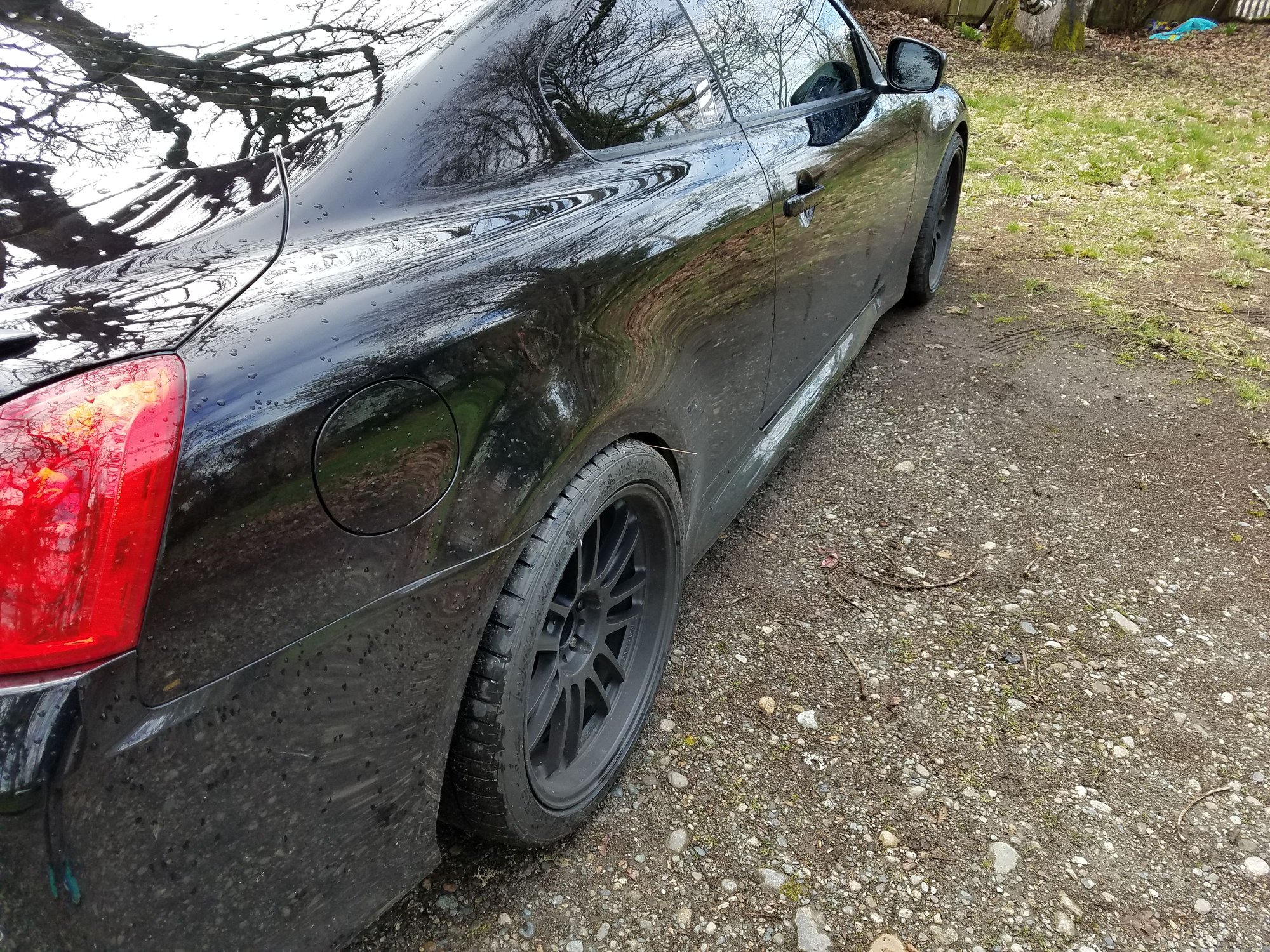

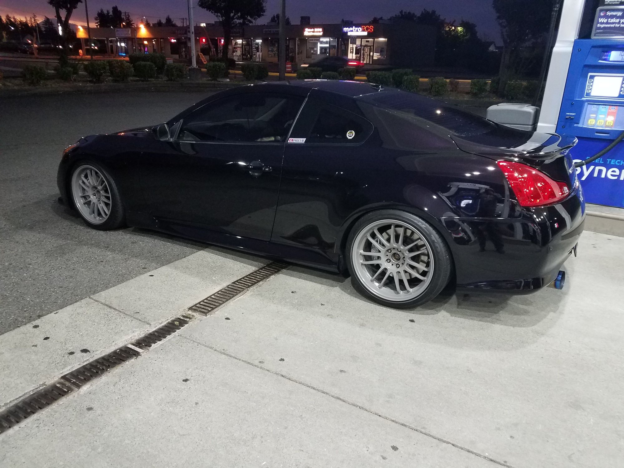

here's a 295 30 on an 11 +20 For reference. 35 would be huge. Fyi the 295 30 was too beefy for my offset so I had to go down to 275 35

I like the beefy look! Gives it a nice butt to look at 😏😏 What’re you lowered on? And any camber ran in that pic?

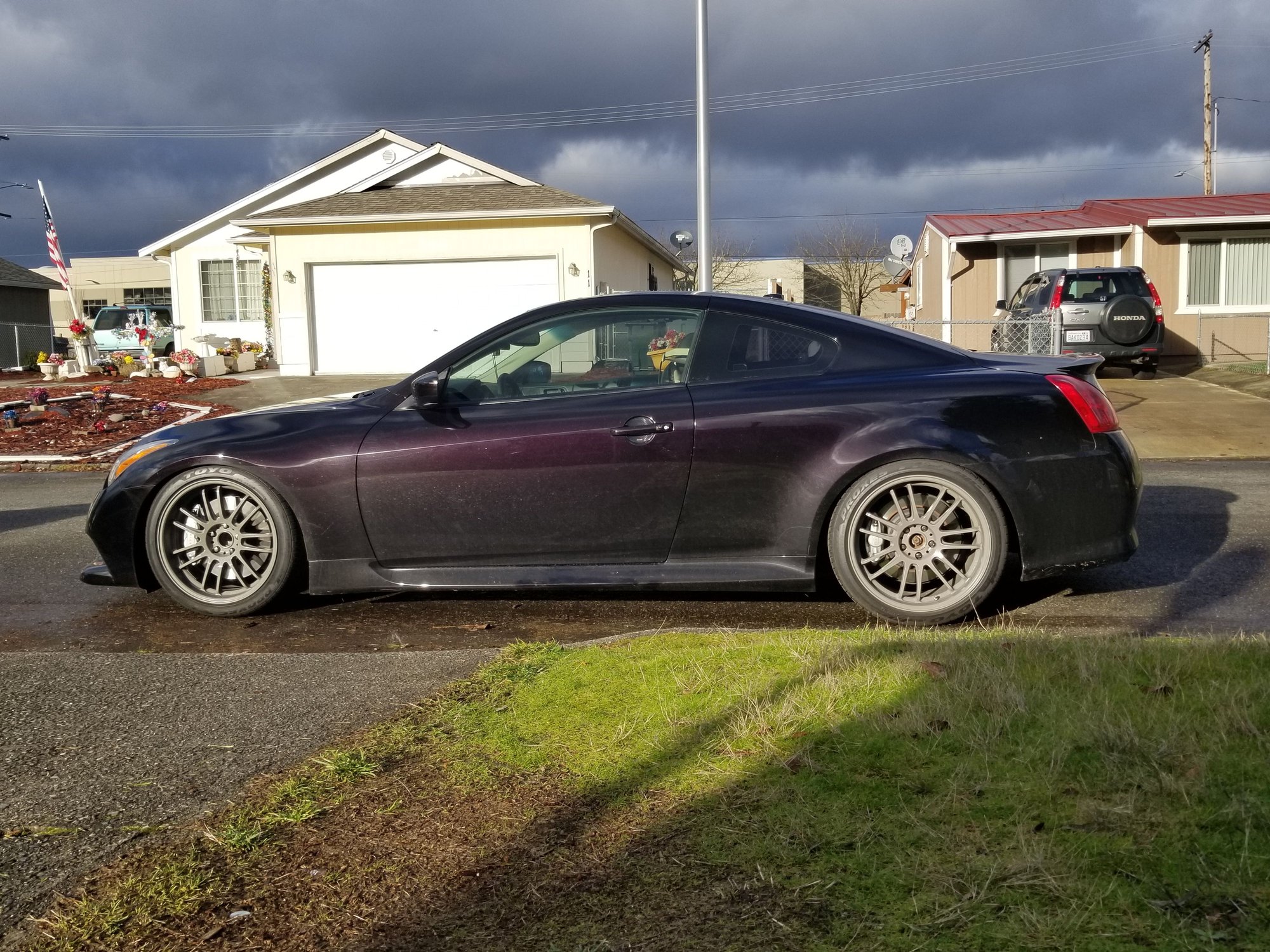

This pic was on swift springs and maybe -1 camber. When I put my coils on and lowered it more it naturally cambered a bit more but still rub. I added voodoo13 camber arms and am now -2.7 and no rub with 275 35.
I too love beefy tire look I may experiment with 285 30 in the future.
here's how she sits today

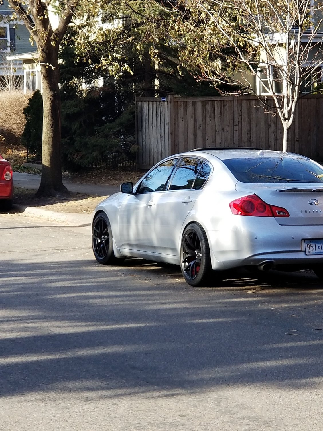

Alright great thread peps, I've browsed and this thread for over years with anticipation of going wide. I've got some nismo wheels that have 285s on the rear, they all rub when I hit dips in the road. Wondering if dropping down to a 275 or 265 would alleviate the rubbing. TIA
no. You need more neg camber. You could run no tire and rub. It' too far out.
