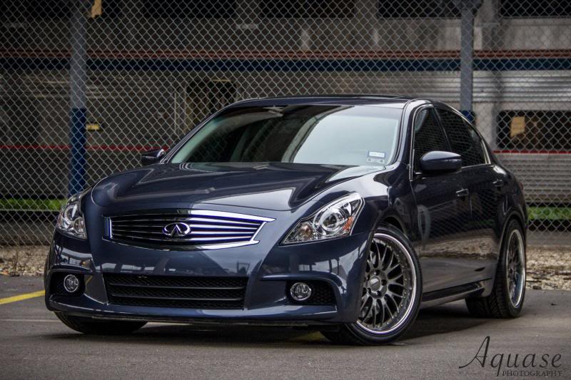

Swift Springs
Forgeline MD3P; Polished lip, Gunmetal center, Gloss Black inner, Exposed ARP hardware
19x9.5 +40 w/ 5mm spacer (+35 netted offset) w/ 245/40
19x10.5 +45 w/ 285/35

u think i can get away with a +40 rear?
Did you see my pic above? I'm running a 285/35-19x10.5 +45 and its flush with the rear fender. A +40 will really poke it out.
