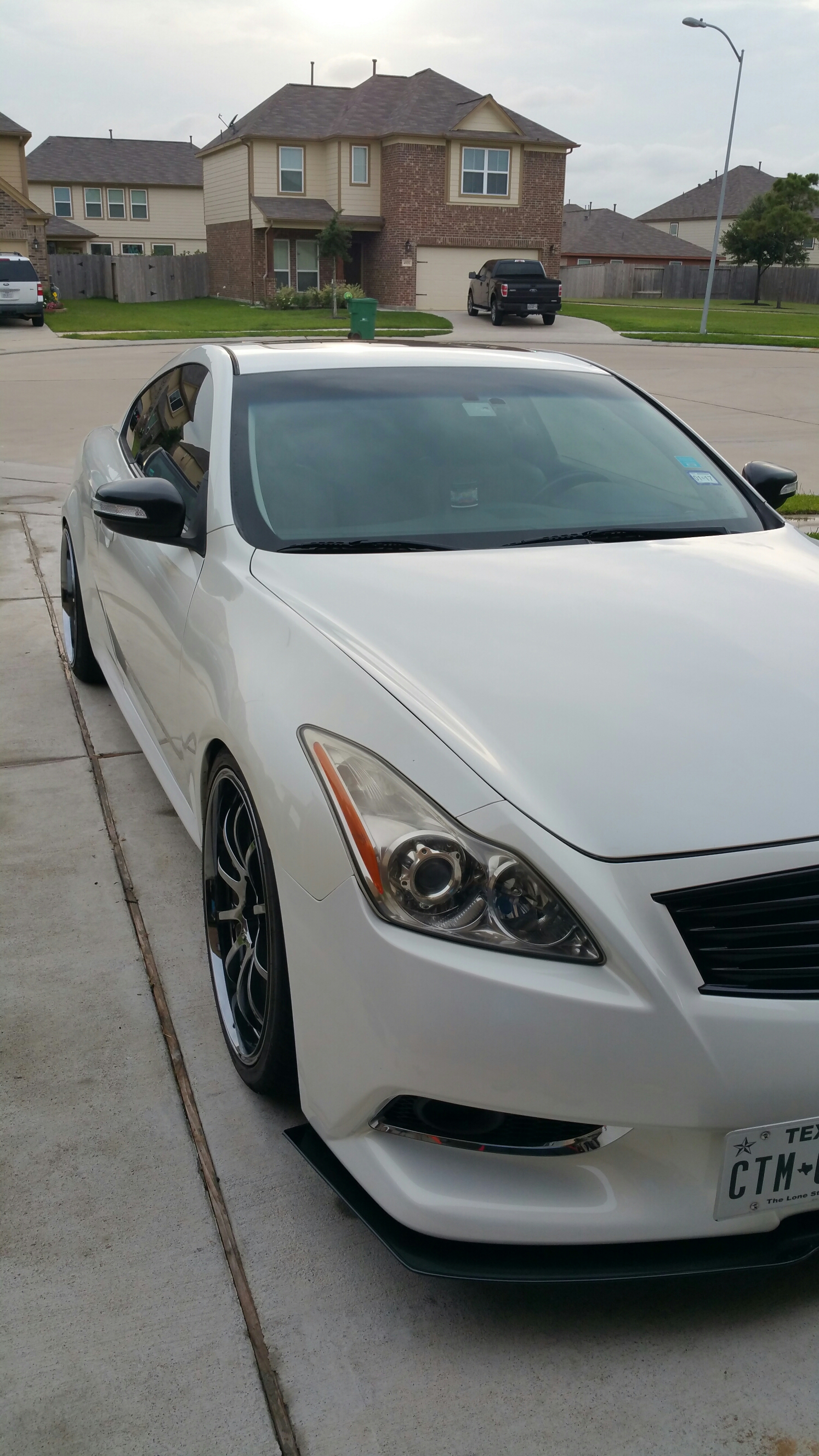

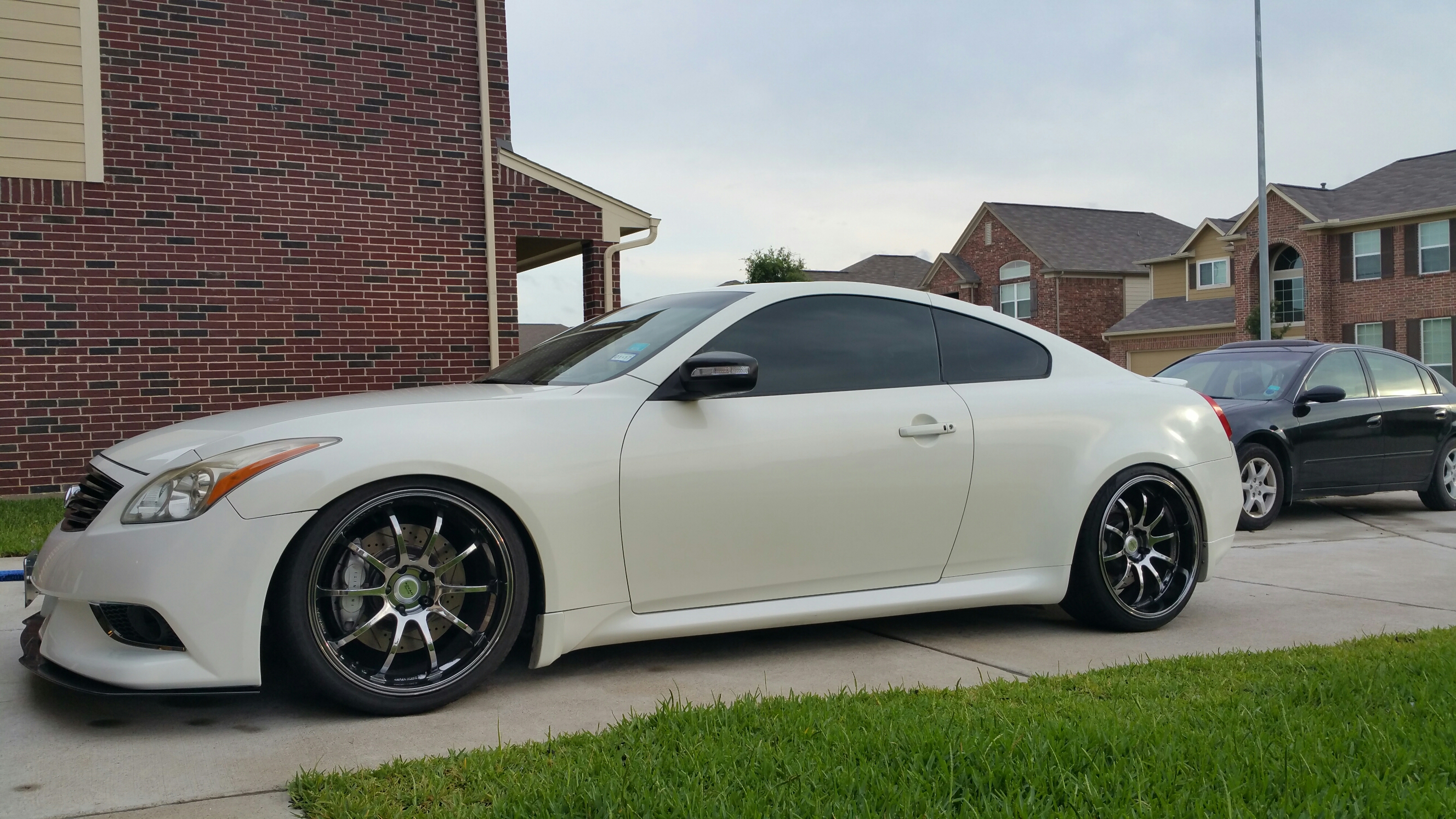

Official Aggressive Offsets & FAT Tires!
Originally Posted by Linwozzle
370z Nismo Wheels
Michelin Pilot Super Sports
245/40/19 front, 295/35/19 rear
These are pretty light, considering I have Advan RS-D 20x9, 20x10 with similar tire specs.
Looking to track with this set up in June at MSR Houston.
What is the largest rear tire you think I can fit on these Nismos, I am tucking tire a little now that I'm lowered on fortune auto 500 coilovers.
I am currently on my Advan RSD 20" x9/x10 with +20 offset all around, 255/35 front and 275/30 rear Falken 452, rear are too streched for my liking, especially since I started tracking, thinking the Falkens run a little smaller. Running -3 camber front and rear with no rubbing.
I am thinking 265 or 275/35 Michelin Pilot SS, would that be stretched too much on a 10.5" width?
Thank you
Attached Thumbnails Official~Best offsets for running FAT tires!-20160525_190836.jpg   Official~Best offsets for running FAT tires!-20160525_190820.jpg
Old Jun 17, 2016 | 07:08 PM
  #1140
Likes: 4,952
Thank you
I know the PSS run a bit wider than most, but I doubt they run wide enough where a 265 would have the same fit as the 275 Falken, maybe at the shoulder but not the tread block. A 265 is a reasonable mount on a 10.5" especially the slightly wider PSS. Maybe run the 265 and back off the camber a bit, unless you really want to run -3 for tracking.
