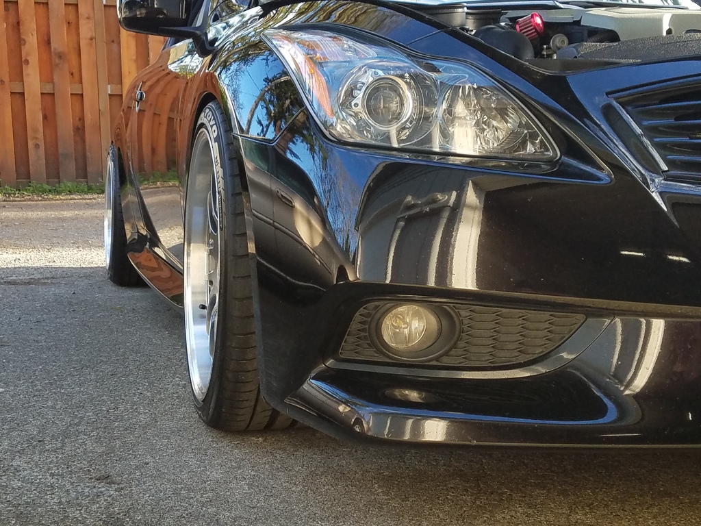

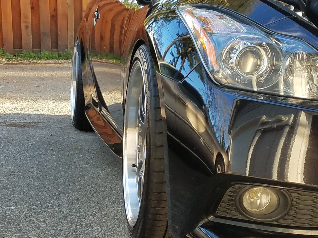

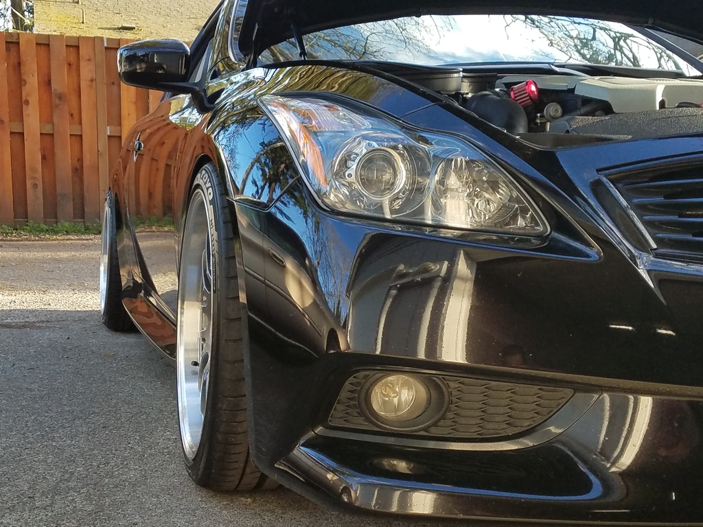

Specs are
19x10 +20 275/30/19
19x11 +20 275/35/19
