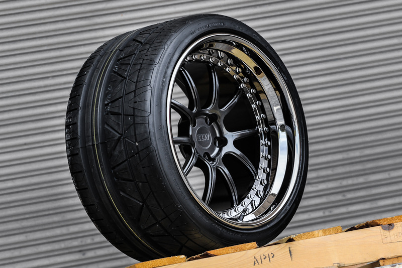

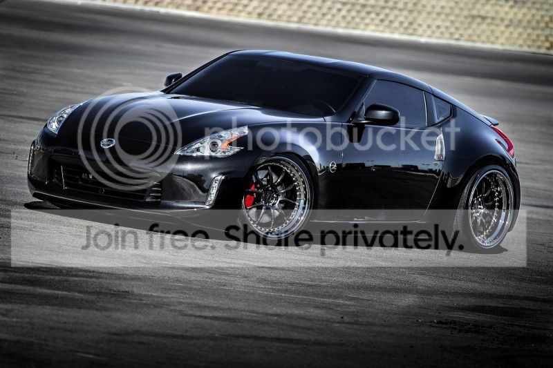

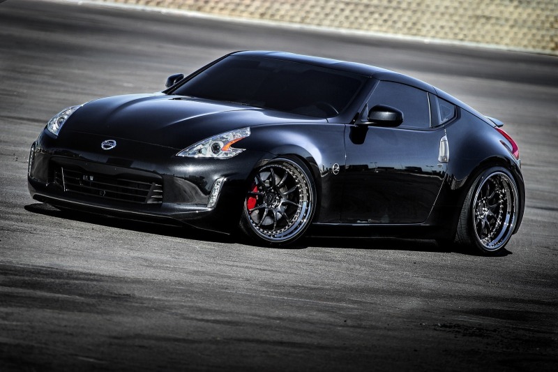

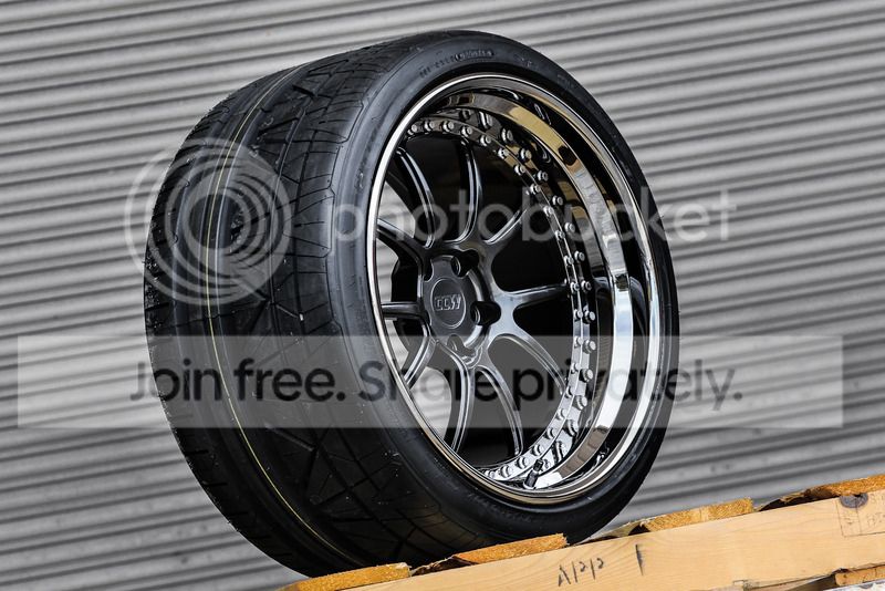

After reading 42 pages of this great thread, a perusal of the Z forum classifieds displayed a seller "part out" - Go big or go home?
Fronts: 20x11.5's wrapped in Nitto Invo 305/25/20's
Rears: 20x13's wrapped in Nitto Invo 345/25/20's
And here I was miffed because I can't run a 10.5 in the rear of an X sedan.

Those

are some purdy wheels!
That whole Z is damn purdy

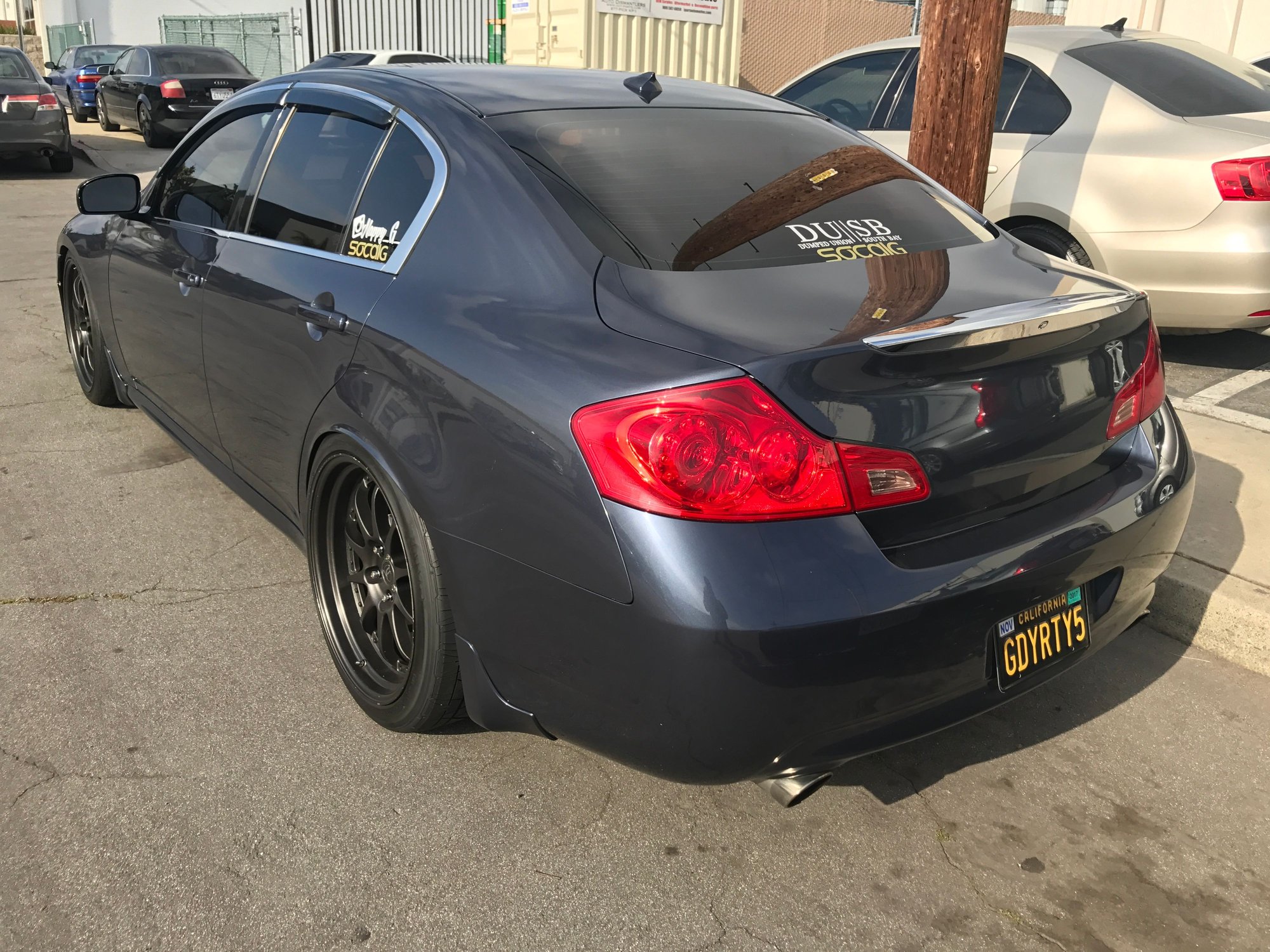

So I got my rear quarters pulled a little bit to be able to drop it another inch to even it out with the front and possibly fit that 285 I really want lol ...
what so do you guys think of bronze on slate blue ? I'm thinking of getting the wheels powedercoated a dark bronze like the one of the TE37's
Old Apr 18, 2017 | 09:54 PM
  #1236
Likes: 4,952
Looks like a decent job on the pull. IMO bronze looks great on just about any OEM G paint color. I think the only color it would look great on would be a bronze G, lol. So I'd say go for it!
Yeah the guy who did them takes pride in his work and is very maticulate with making sure everything looks like it came like that from factory..
ill post pictures after there done and back on the car
