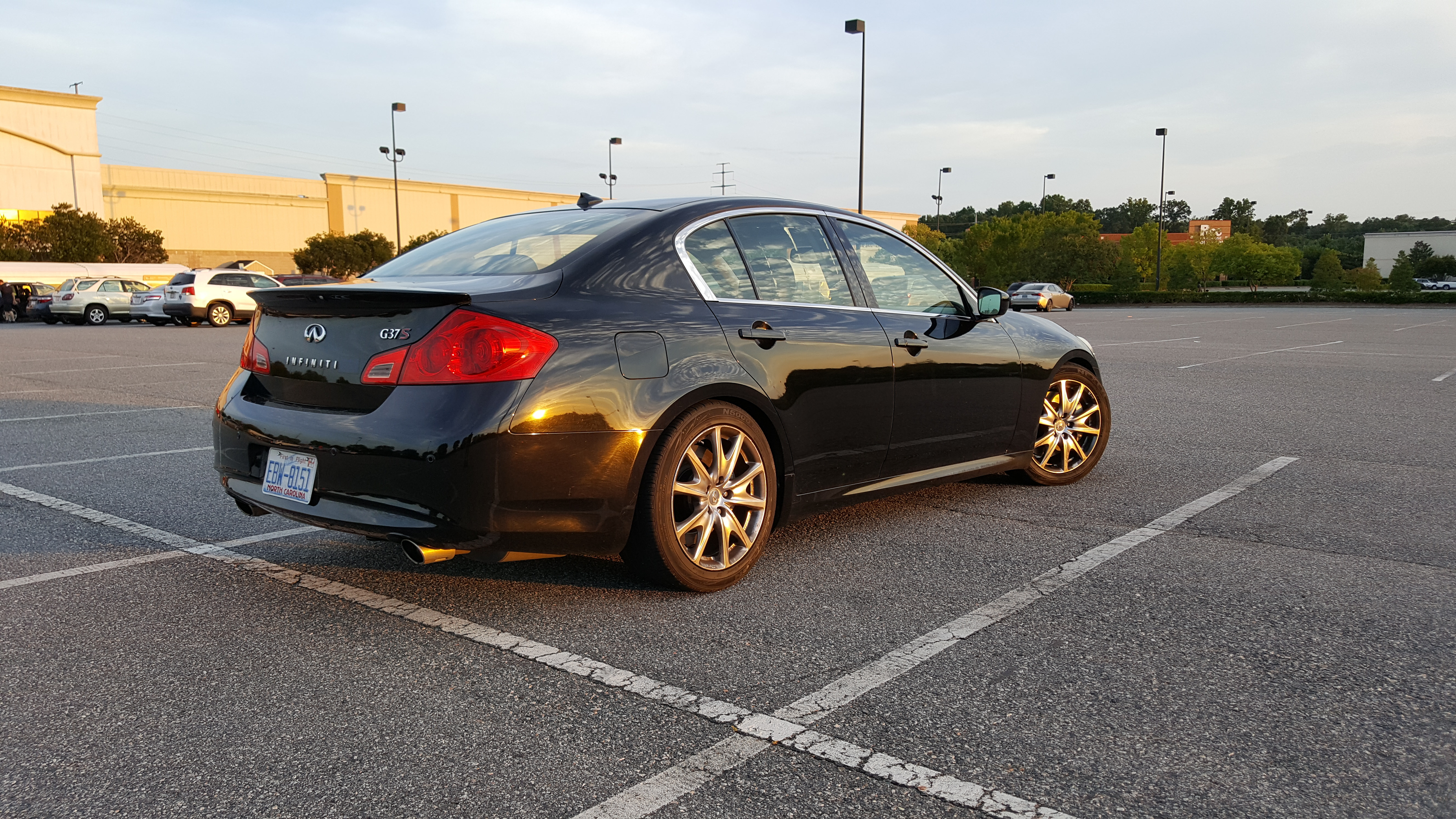

I would get coilovers.... you can get that low, and the shocks will be matched to it.
Here's my car on Tein Basics... they can go a lot lower.

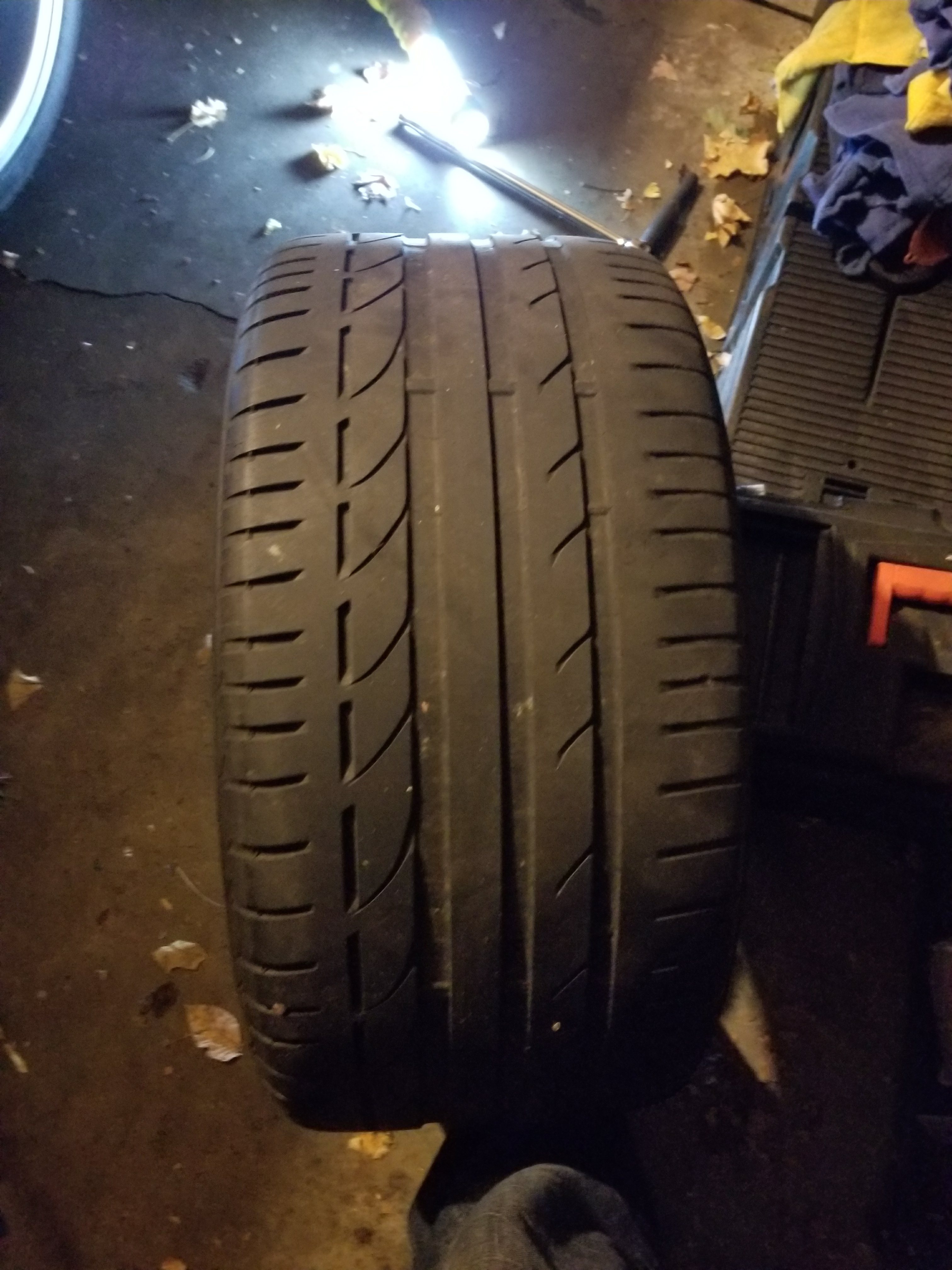

Sooo much tire
Attached Thumbnails Official~Best offsets for running FAT tires!-20171201_084818.jpg

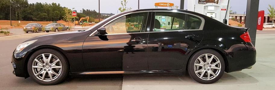

265 35 19 rear 245 40 19 front
Front 1.5 in drop
rear 1.5in drop
My fitment. Offset:
ET35 - Front ET40 - Rear

19x8.5 Front 19x9.5 Rear

Man I thought long and hard about those wheels sergey.... those are the UP100s right? They look good but I'd think about another 10-15mm of poke
Yep they are up100 I have a 5mm spacer in the front I think forgot the exact measurement but the rear looks pretty good in my eyes without the rear spacers lol
Personally I'd just get a wider tire in the rear. There's a slight stretch that appears to be unnecessary with the space there. A little more meat would set it right IMO
I had 275 35 19 on the rear at first but the Wore out quickly did not find any good pics of the 275’s on but this summer I’m planning on going with 285’s on the rear and 255 in the front.
