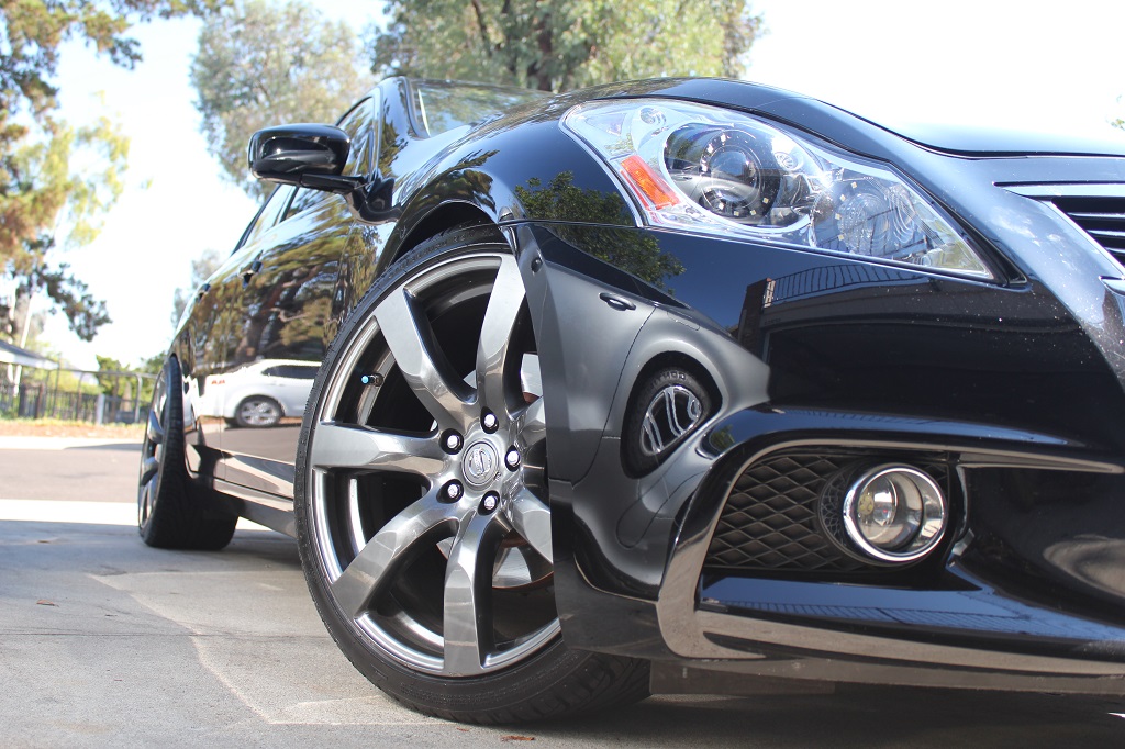

GT-R Rays on 245/35/20 Fronts 285/30/20 in the rears
Eibach Pro Kit

First, Congrats on the new wheels! I think the overall look of the wheels looks great on the sedan. Tire sizes are good too. However the OEM offsets are what pushes me away from them. That rear wheel/tire is poking out something crazy!
