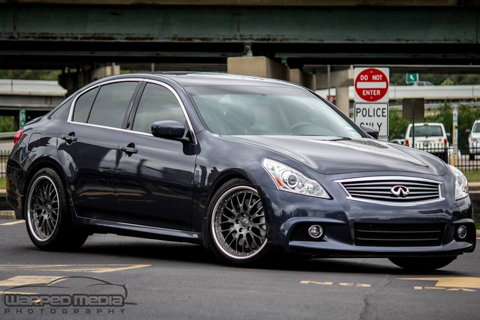

Originally Posted by Robert_K
First, Congrats on the new wheels! I think the overall look of the wheels looks great on the sedan. Tire sizes are good too. However the OEM offsets are what pushes me away from them. That rear wheel/tire is poking out something crazy!
Thanks man. It's being taken care of as we speak. Crossing my fingers for a tucked wheel.

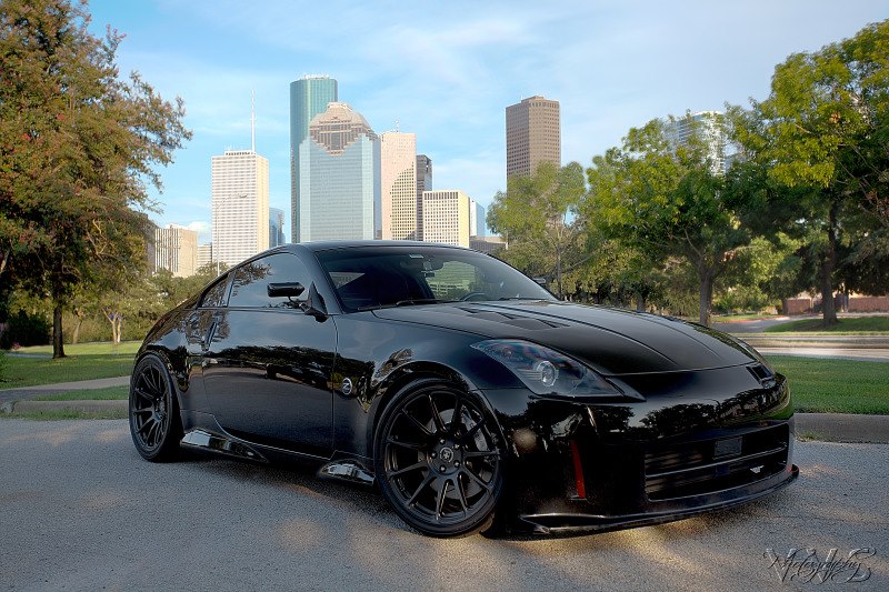

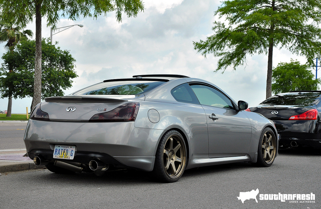

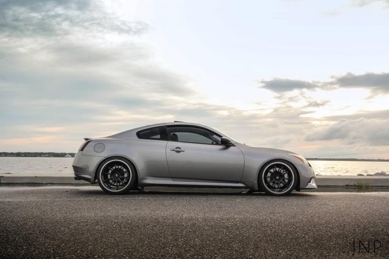

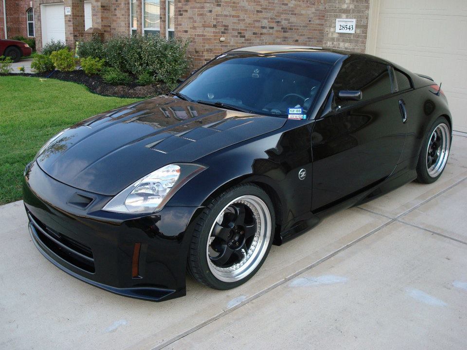

kdawg; As mentioned above are reasons I went with the 10.5 +45, fitment. Plus the 285 on an 11" wheel doesn't give the same "fat" look as it does on a 10.5". Take a look at my pics of my G and Z. The G has a 285 on a 19x10.5. The Z with the WORKs are a 285 on a 19x11 and the HRE are sporting a 305 on a 19x11.

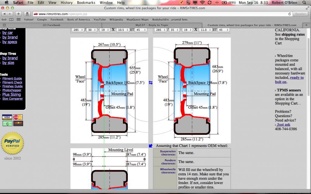

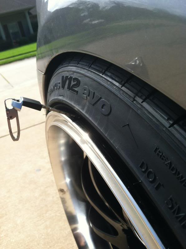

As you can see from the attached picture there is a 3mm (0.11") increase to the back of the barrel. 1/2" = 12.7mm. So you would increase the lip by 9.7mm or 0.38" at the "cost" of less tire bulge/ taller tire from stretching.
Lastly on the attached comparing my 285/35-19x10.5 +45 to your 285/35-19x11 +45; "Will fill out the wheelwell by extra 14mm (0.55"). Make sure that you have enough room under the fender. If not, consider lower profiles or smaller rims."

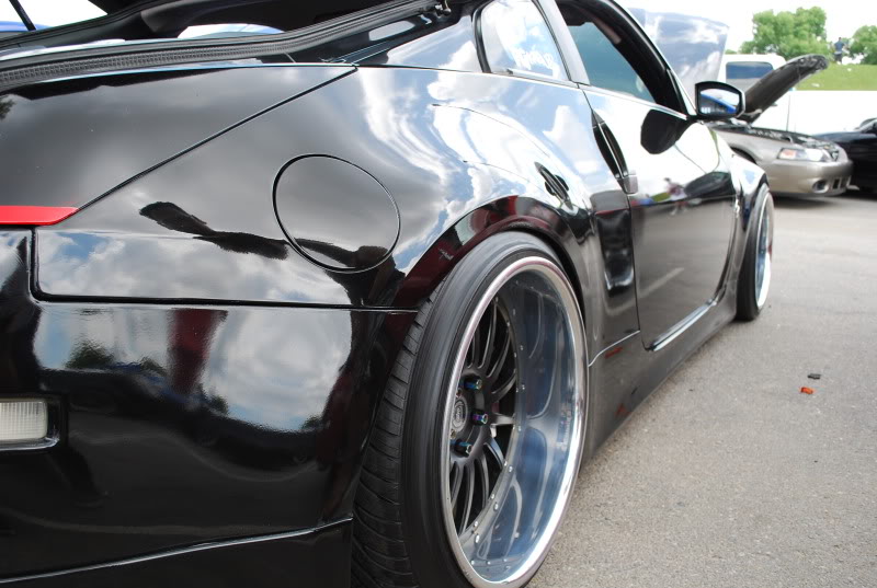

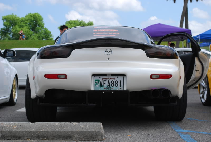

Might as well post up some POKE & STRETCH,
Enjoy!
