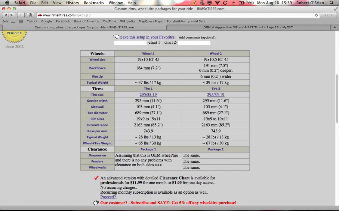

Originally Posted by kdawg8526
but im plannin to go with 10 inch rim
The only difference will be a wider/deeper wheel on a 10.5. Otherwise the face spacing will be the same.
Attached Thumbnails Official~Best offsets for running FAT tires!-screen-shot-2013-08-26-at-3.39.21-pm.jpg
Old Aug 26, 2013 | 05:15 PM
  #542
kdawg8526's Avatar
kdawg8526
Posts: 896
Likes: 46
From: Van. BC
ohhhh makes sense thanks for clarifying that
