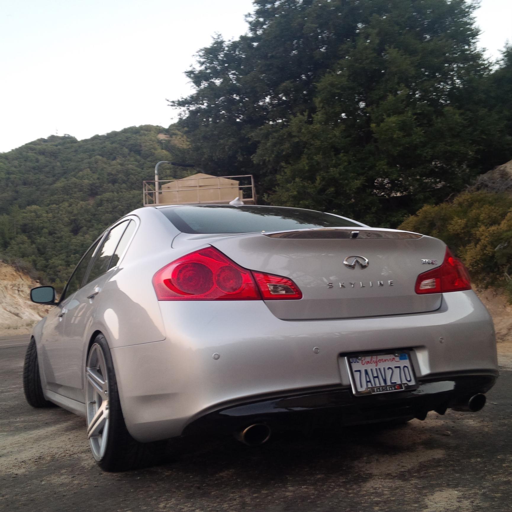

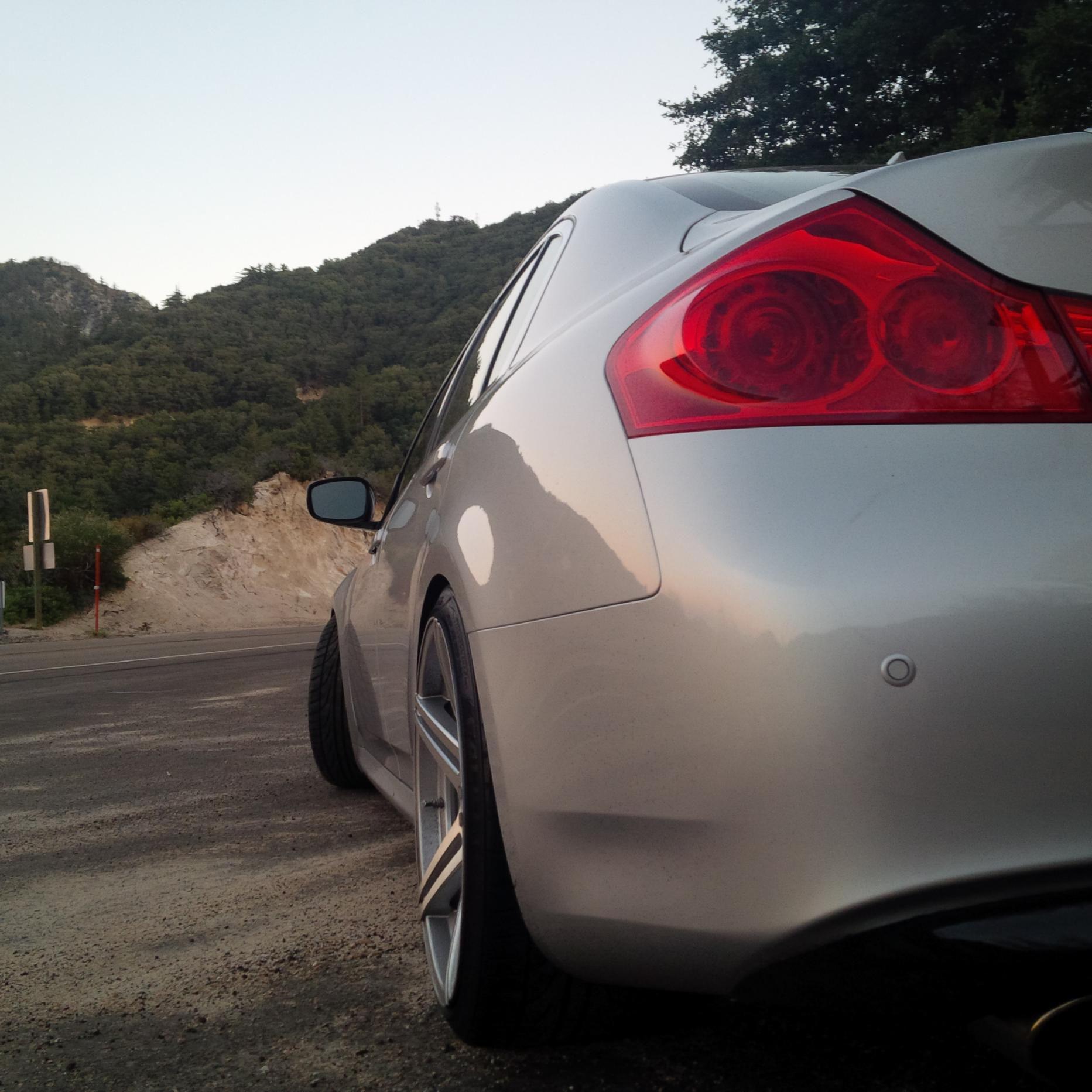

Not 275/35 but this is 275/30 but hopefully it helps you imagine the type of stretch you would get with a narrow style (Falken 452/453) - 275 tire on a 10.5" rim
I will soon be able to be a part of this thread because im almost done smoking out these 275's and already have 285's sitting in the garage ready to go. Hopefully they wont give me any fender clearance issues when I slap them on.
Attached Thumbnails Official~Best offsets for running FAT tires!-4.jpg   Official~Best offsets for running FAT tires!-img_00000420.jpg
Old Sep 9, 2013 | 08:40 AM
  #564
Likes: 4,949
Hot looking setup TStar Looks like you have just enough room to slip 285s in there, looks like you have about 5.5mm of room back there so that half millimeter will just get you in BTW, what offset are you running in back?
Look forward to seeing that setup, way to push the edge
Thanks blnewt ... The net rear offset is +42 (3mm spacers)
And I have my fingers crossed that it will fit, it is definitely going to be a close call. I will post up a picture either way because they are going on one way or another . I just hope that the 285's don't throw the balance of the car off with the addition of more grip in the rear. I finally have the car exactly how I like it with great corner grip but also with the benefits of excellent mid-drift control capability.
