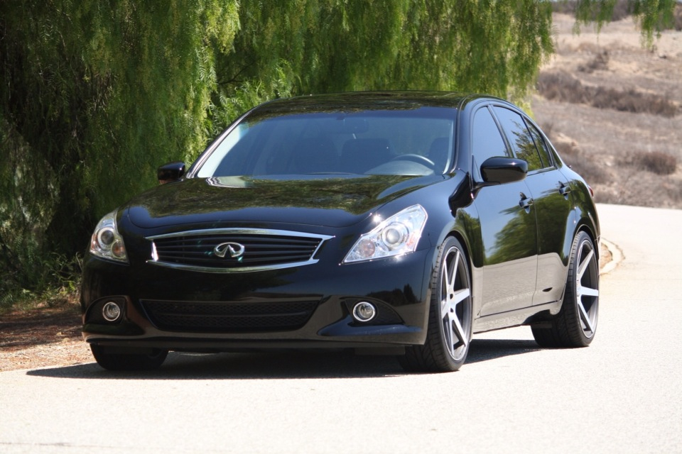

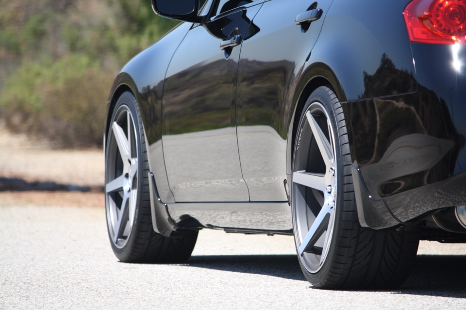

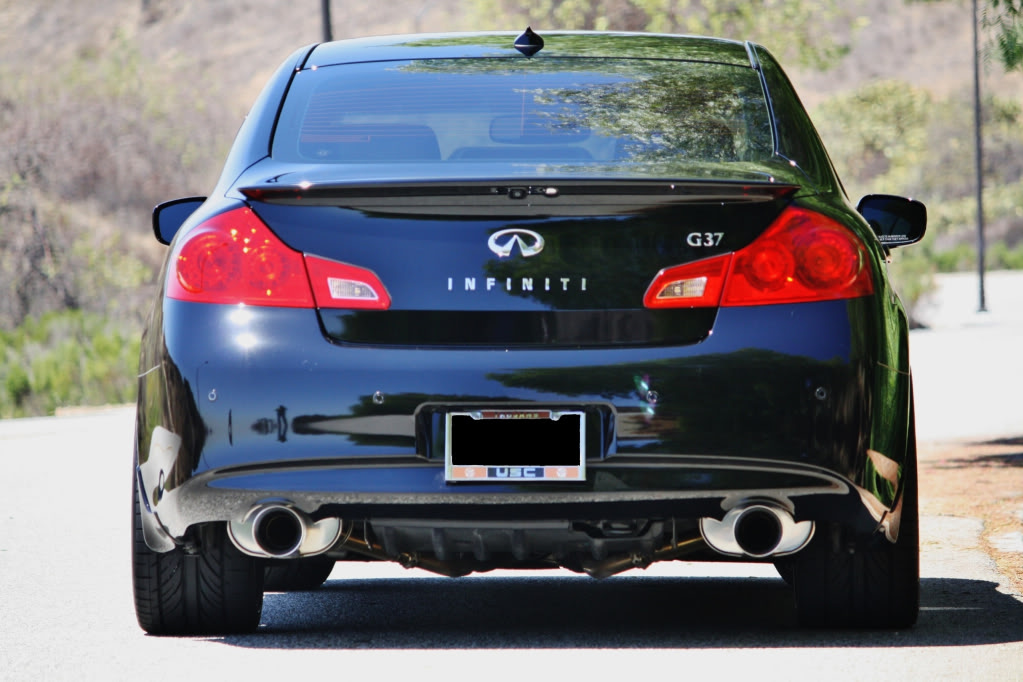

Hey Guys, this isn't 285's or 295's but I'm working my way there...baby steps.
20x9 +35 255/35
20x10 +42 275/30 added 3mm spacer to net +39 offset.
