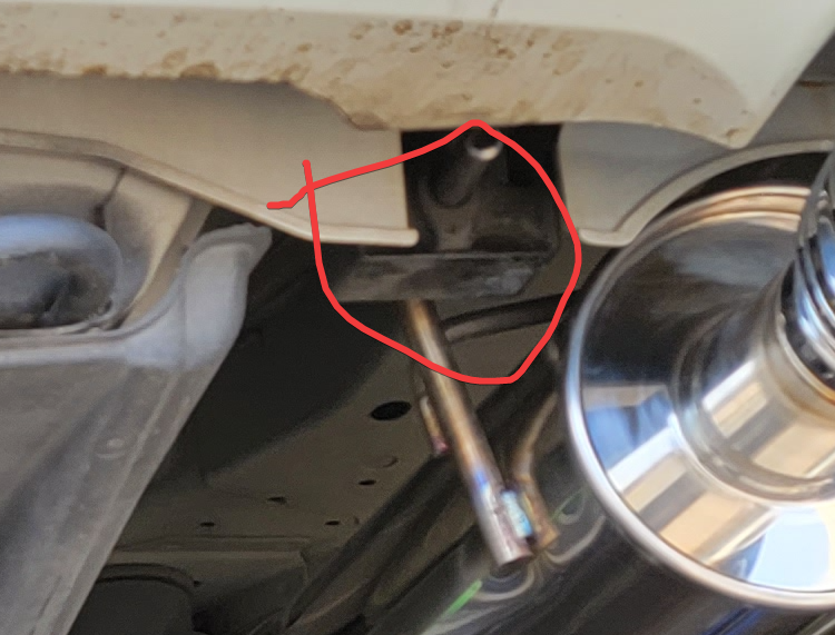

Yes that gap, the exhaust isnt sitting in the hanger but floating in it because the mufflers are holding them up so just adjust your mufflers to sit a tiny bit lower and it should solve your issues.
Thanks a lot. I'm a little unsure where you're saying to put washers or spacers.
You see the bracket floating in the air to the right of the exhaust tip? There are two studs that go through them, you can put some washers in-between the bracket and the car to lower the mufflers which will in turn lower your midpipes away from the swaybar. It may not be 100% the solution but that and some other massaging of the flanges will likely get you there.
I think I got it. Between the chassis and the circled part, space it out.
What about the left tip coming out further past the bumper than the right tip? Any ideas on that?
Yup! It's an aftermarket exhaust so fitment can vary and from your pic the left tip isn't that much further out, there really isn't a way to adjust that. You can try loosen all the flanges and see if any adjustment helps that but nothing really directly to tweak it.
The exhaust will expand when hot, see what the tips look like once you drive it for a bit.

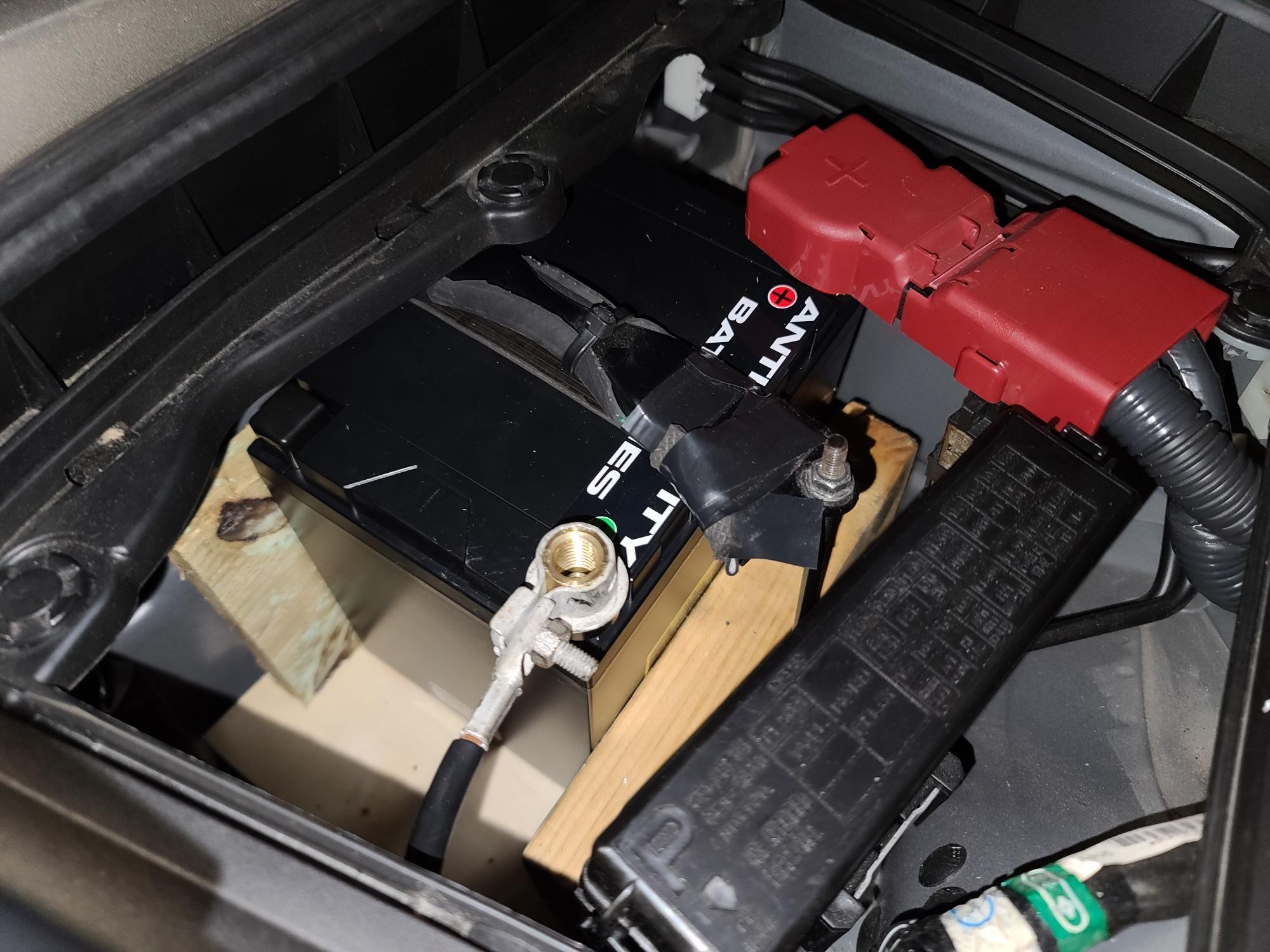

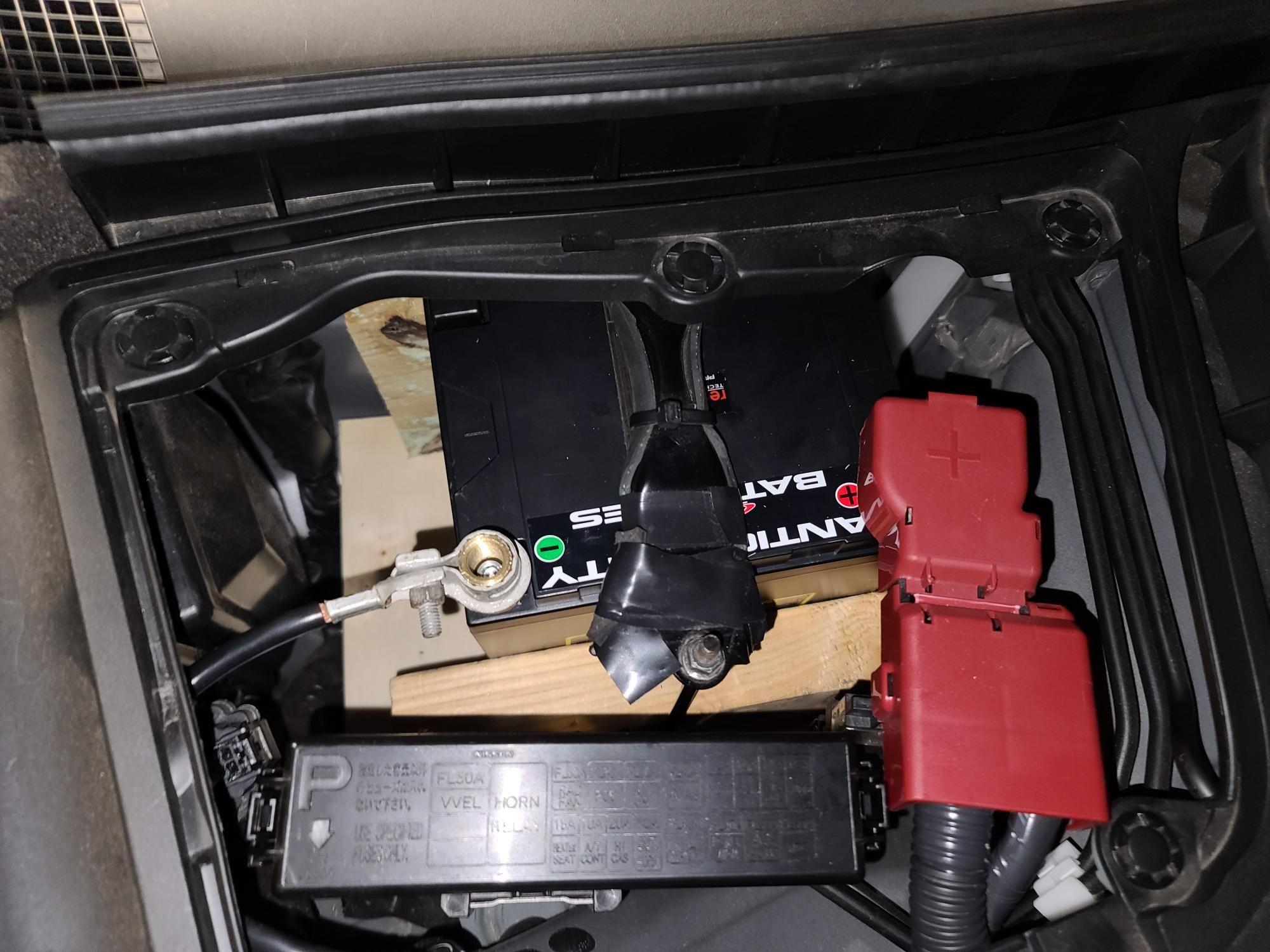

Replaced my battery today and shed about 40-45lbs in the process. I put in an Antigravity ATX-30 RS that weighs about 6lbs and made myself a cheapo box with some spare wood to fit it in there snug. The stock battery holder actually worked pretty well.
So my weight savings mods are:
RHFCs: 10.4lbs
Spare + tools: 35lbs I think (I'd have to look it up to confirm)
Engine cover, hood liner, trunk liner: 5lbs
Lightweight wheels: 25lbs rotational + unsprung
Battery: 40-45lbs
Still planning to get 2 piece F+R rotors very soon which will save another 20lbs up front and 8-10 in the rear, and also going to get a 12.5lb flywheel for another 20~lbs weight loss.
