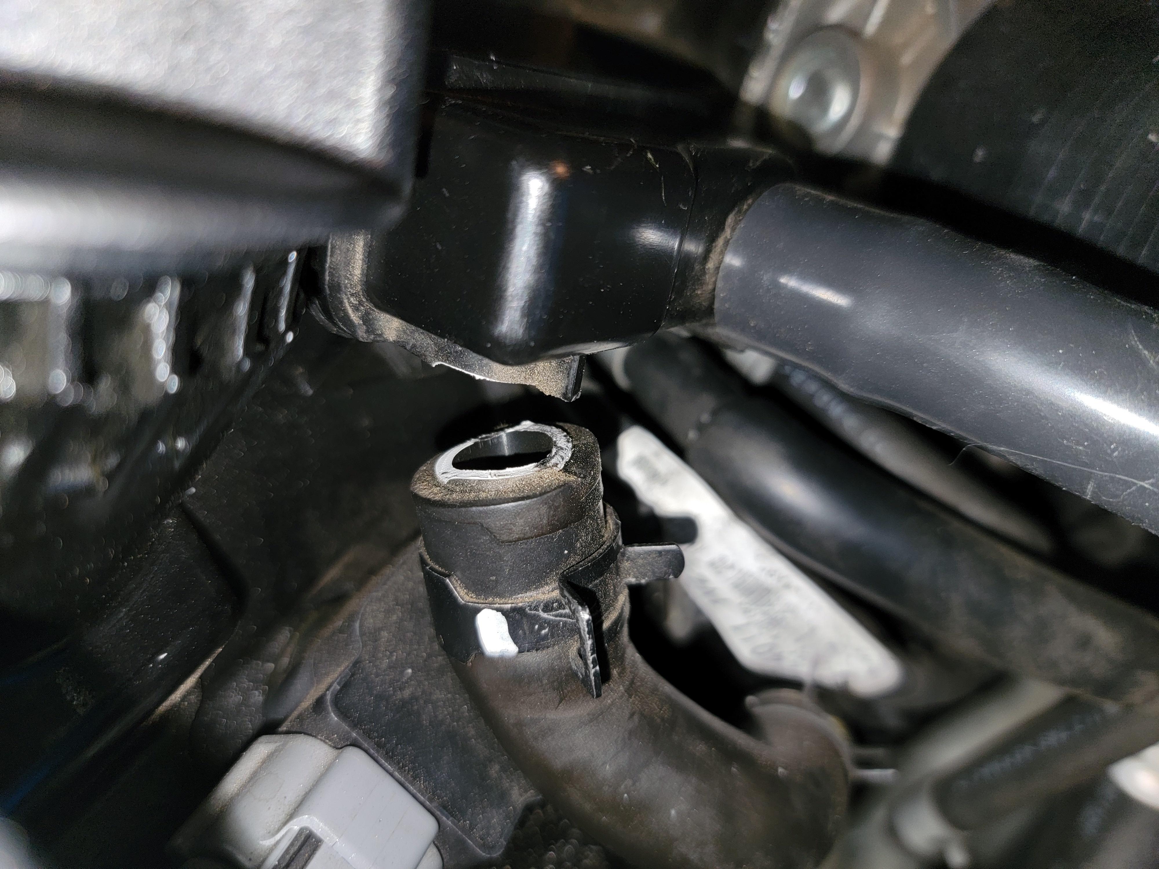

I tried to put clamps on my pcv hoses and couplers but I discovered this:
Also 63-71mm clamps didn't fit on my couplers so I have to return them and order 70-80mm clamps.

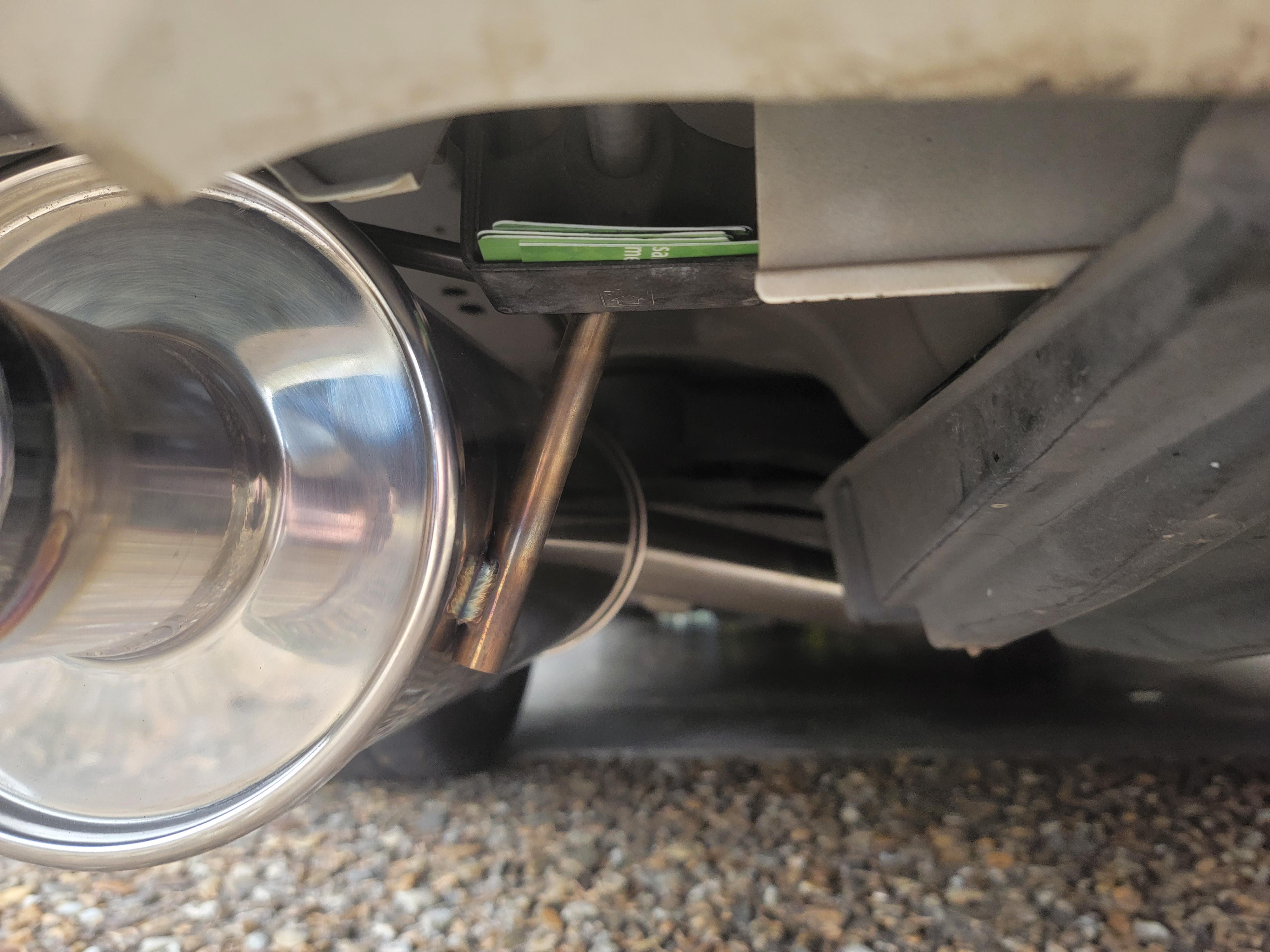

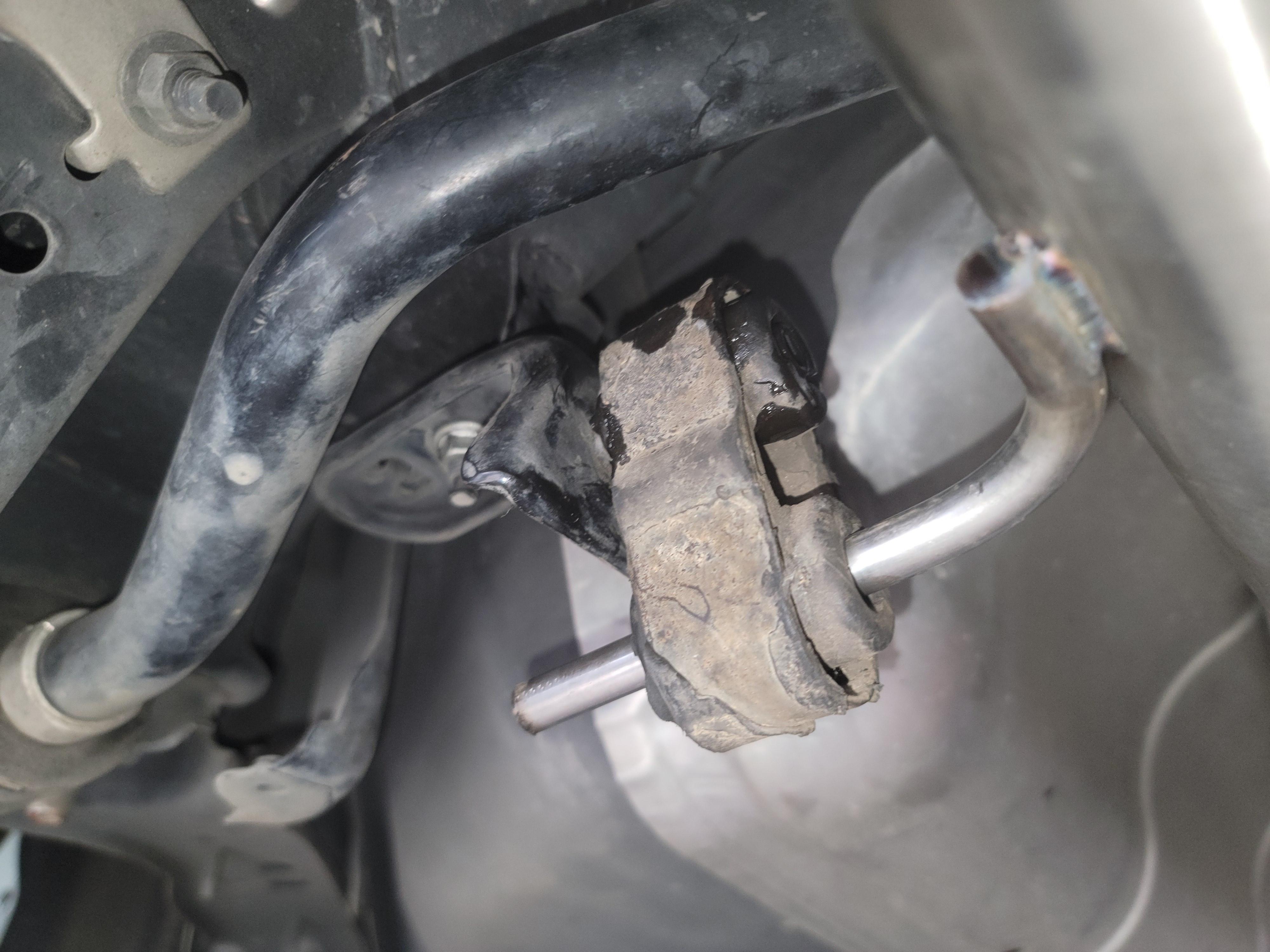

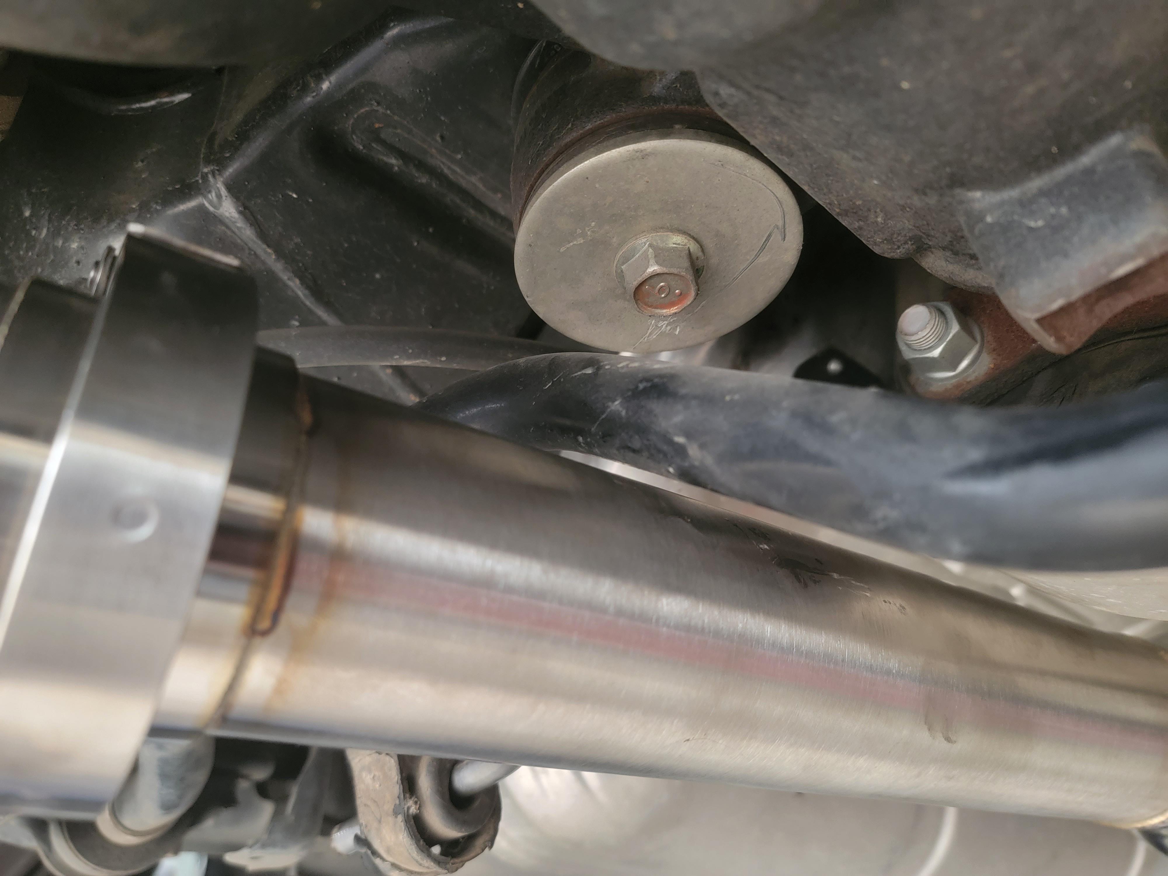

Originally Posted by thescreensavers
Yup! It's an aftermarket exhaust so fitment can vary and from your pic the left tip isn't that much further out, there really isn't a way to adjust that. You can try loosen all the flanges and see if any adjustment helps that but nothing really directly to tweak it.
The exhaust will expand when hot, see what the tips look like once you drive it for a bit.
Tried to suggest this at the part that is relevant but they said the bushing isn't stiff enough and put in a stiffer one. Then they bent the exhaust with a bar. It seemed like it was fixed, and as you can see it's further from the sway bar now:
But after I got home I heard more rattling .
So I was moving the mufflers/tips around and I added some cut up plastic cards in that spot you circled as an example. It seemed to lessen it and I started noticing sound on the right side too so I added more to the left and added some to the right. I didn't have a lot of time to check because of work but I think the issue is resolved. I wouldn't mind a neater solution but I don't think the cards will fall out or get too hot based on the location and it's hard to even see these unless you're looking for it so it will probably be fine long-term.
Below is an image before I added a little more:

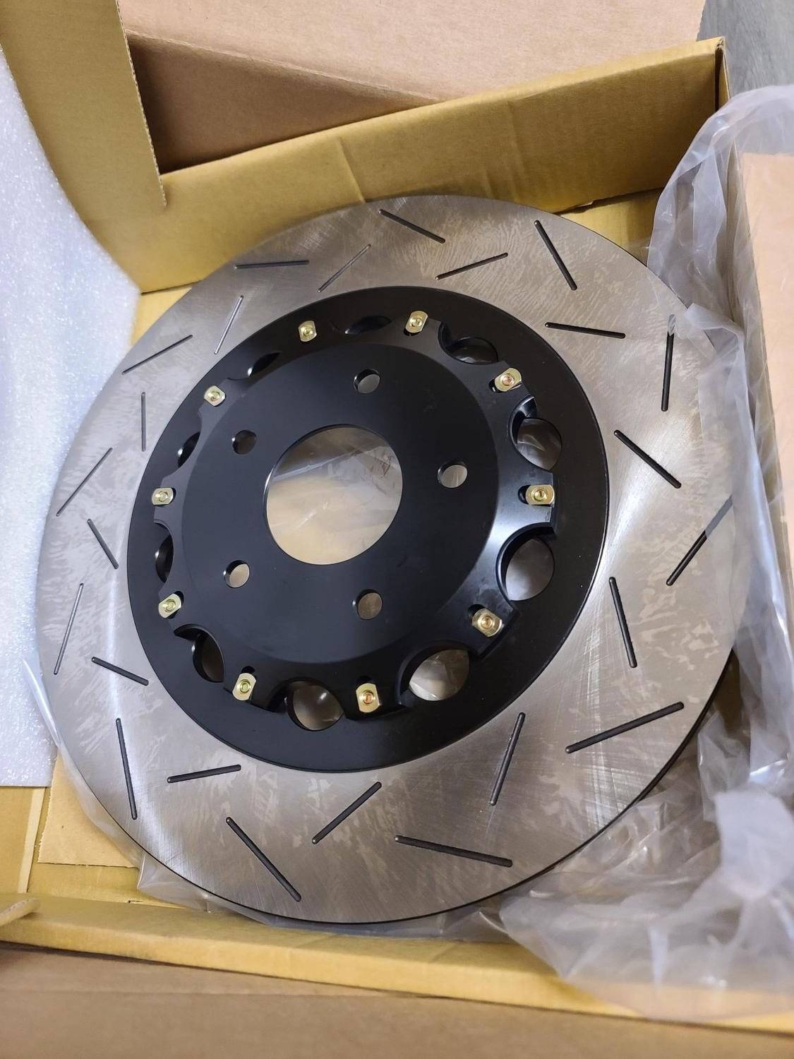

I have joined the club, just waiting on a good day to install.... Front and rear 2-piece and Centric Posi-Quiets to go with them.
