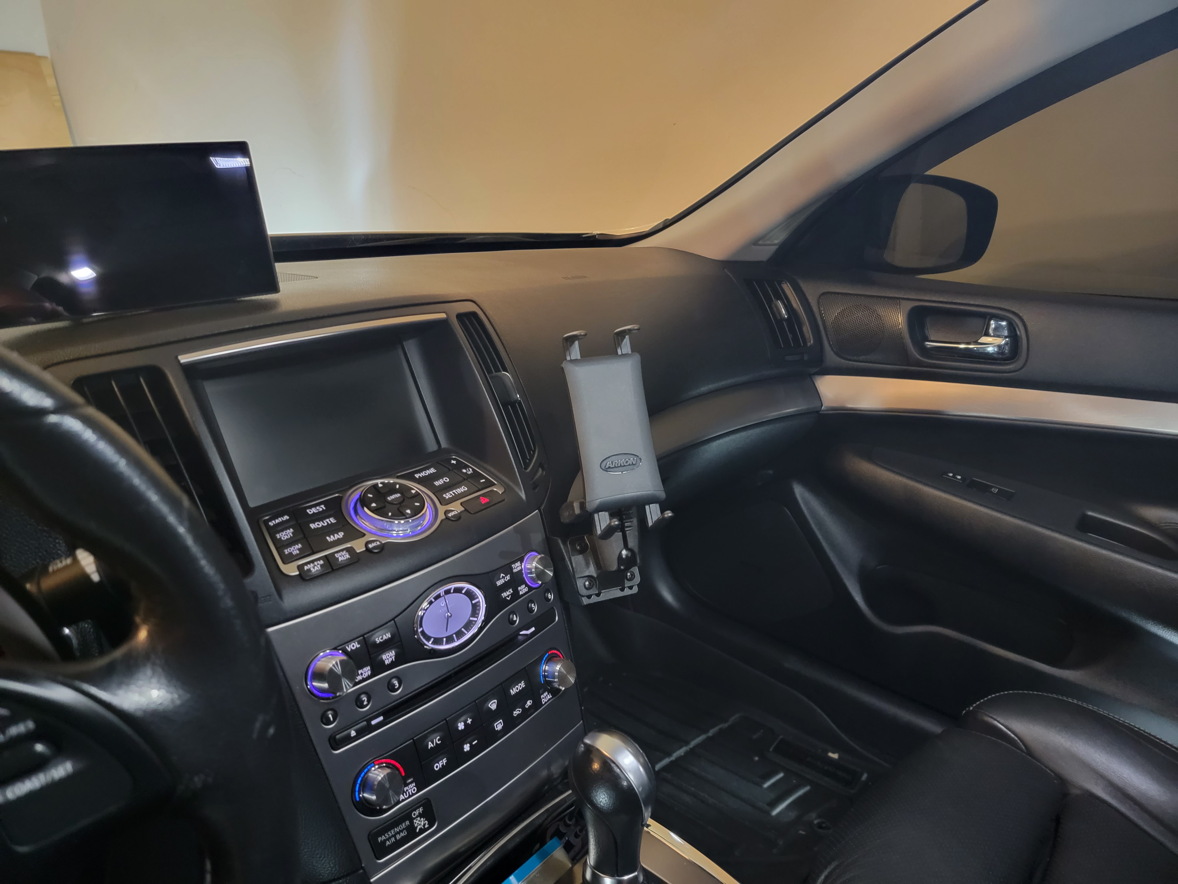

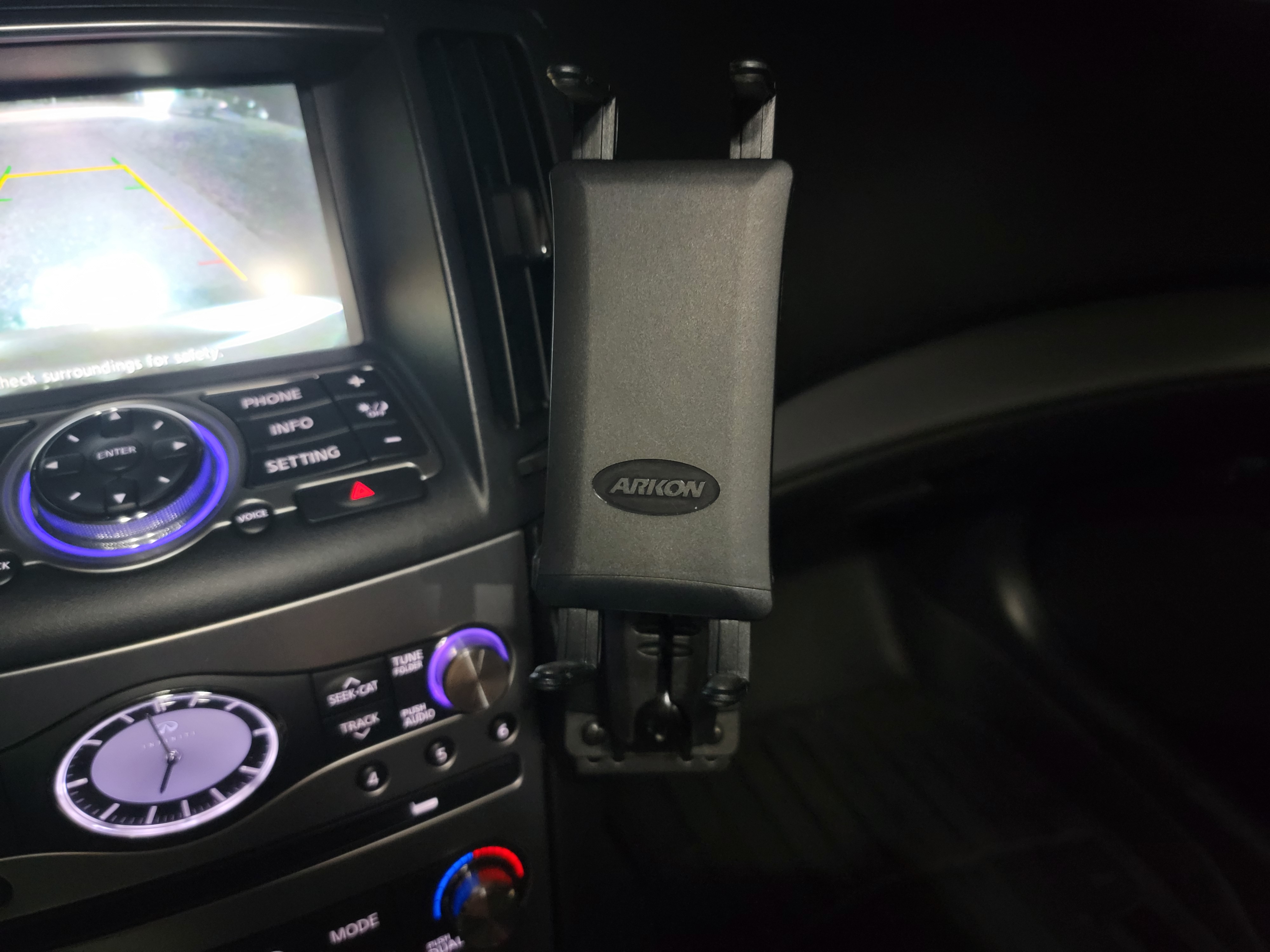

I got a new panavise mount to replace my proclipusa mount. The proclipusa mount kept getting kneed the rare times I had passengers in the car, even if I told them specifically to watch for it. It was causing it to be less stable. When I installed my dashcam and had to mess with the panel, it failed to the point I was ready to replace it. It was also annoying how it was so low and easy for people to knee.
The panavise will be much harder for people to knee. The vents on the G are more rare than many car vents and I don't want to block them or totally prevent the ability to move them left/right.
The panavise mount screws into the top right screw behind the radio controls and feels very well built.
The panavise phone holder SUCKS. I returned it because despite the same company making the mount, the company failed to ensure that the tone control isn't unusable as a result of the phone mount. Another unacceptable issue is that when you pull the phone out of the holder, the holder comes off the mount with the phone. TOTALLY USELESS!
So I bought this Arkon mount. The downside is it doesn't come with screws or nuts to secure it to an AMPS plate. I used the ones from the panavise phone holder :>.
This one is great because you can adjust the angle/elevation/position in so many ways. You can adjust it at he part where the phone holder is AND the part where the mount is. I positioned it in the pictures above in a way where it's angled towards my face, is out of the way of the tone control, out of the way of the shifter, and as far away from the passenger as possible. It seems well built so hopefully it will last. I'm sick of having to go through different phone mounts/holders because they fail or have serious issues.

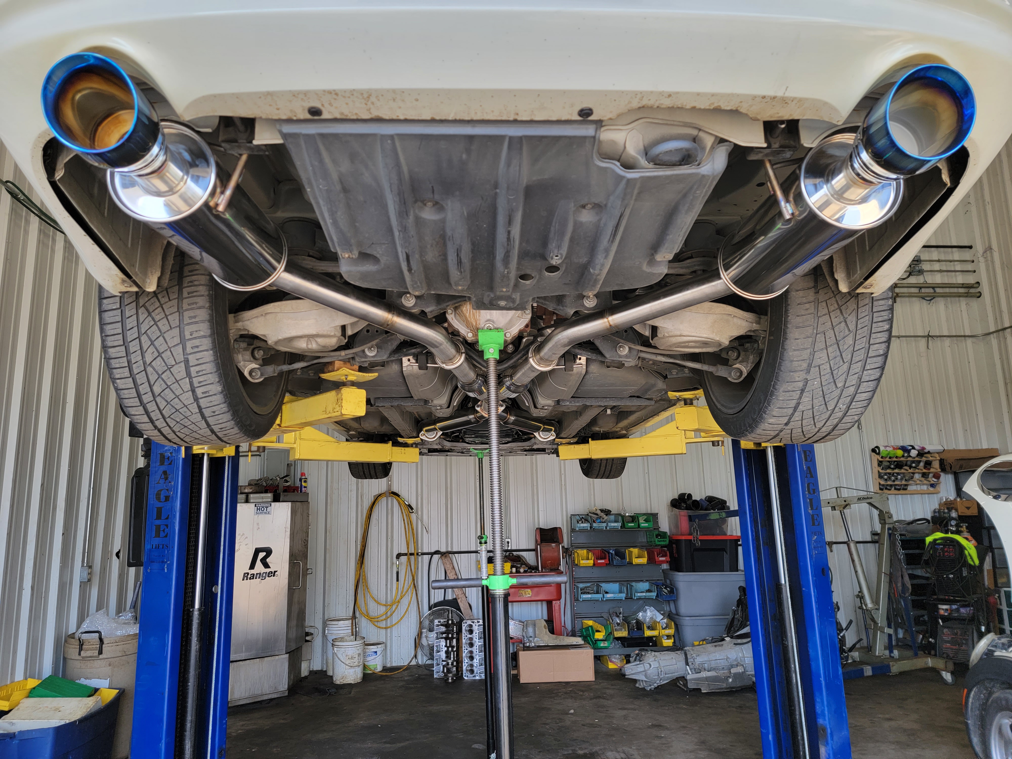

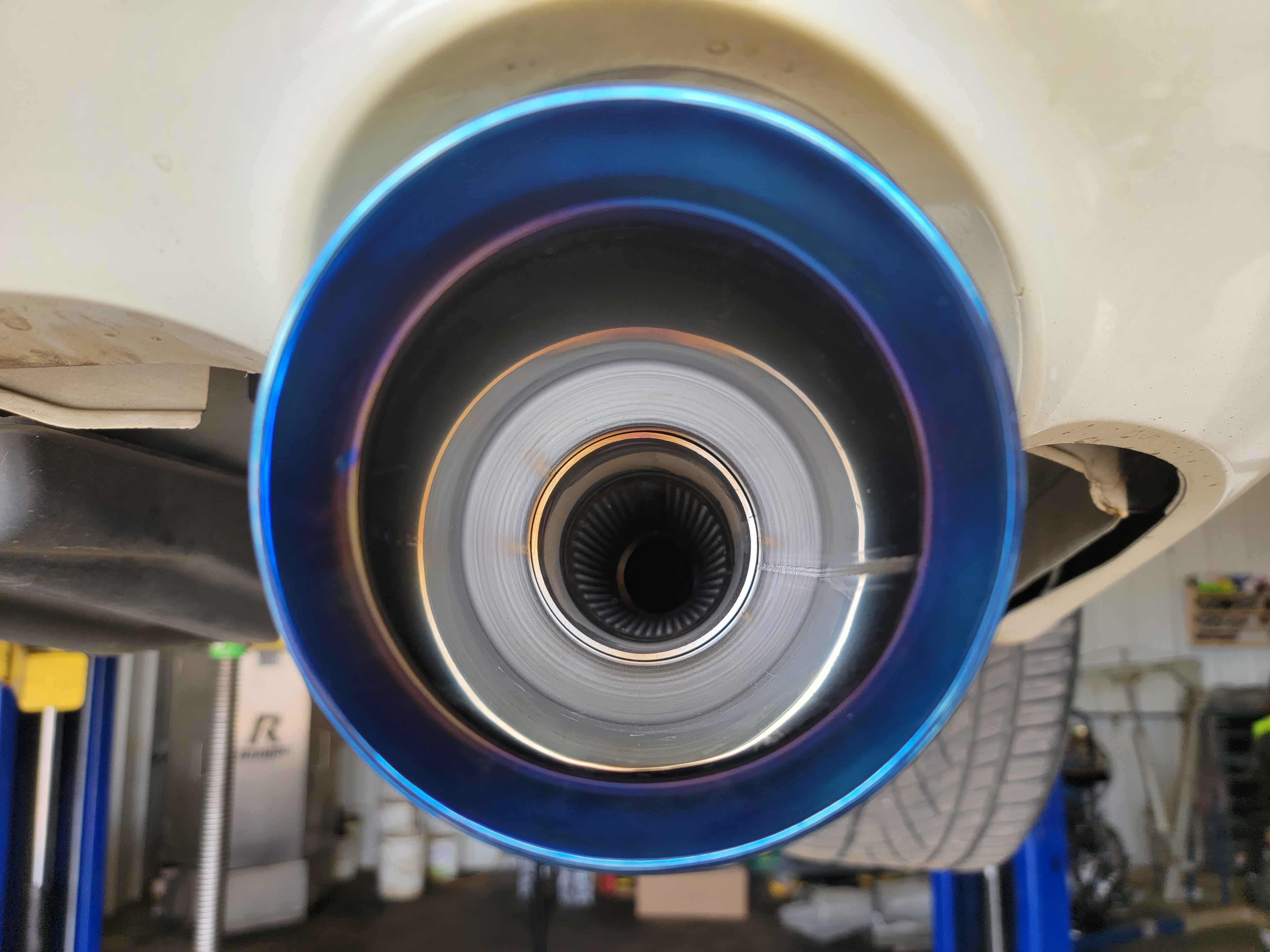

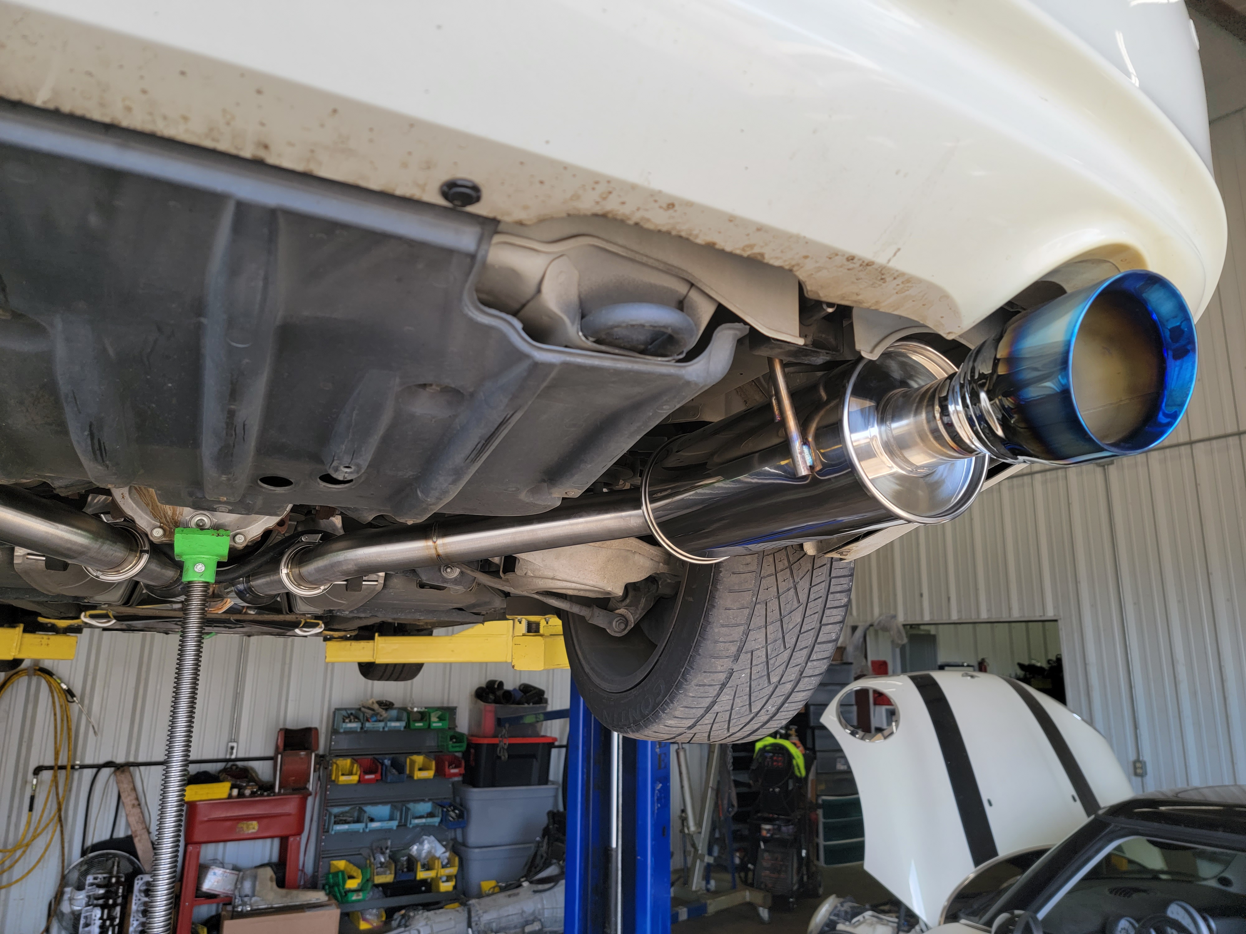

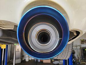

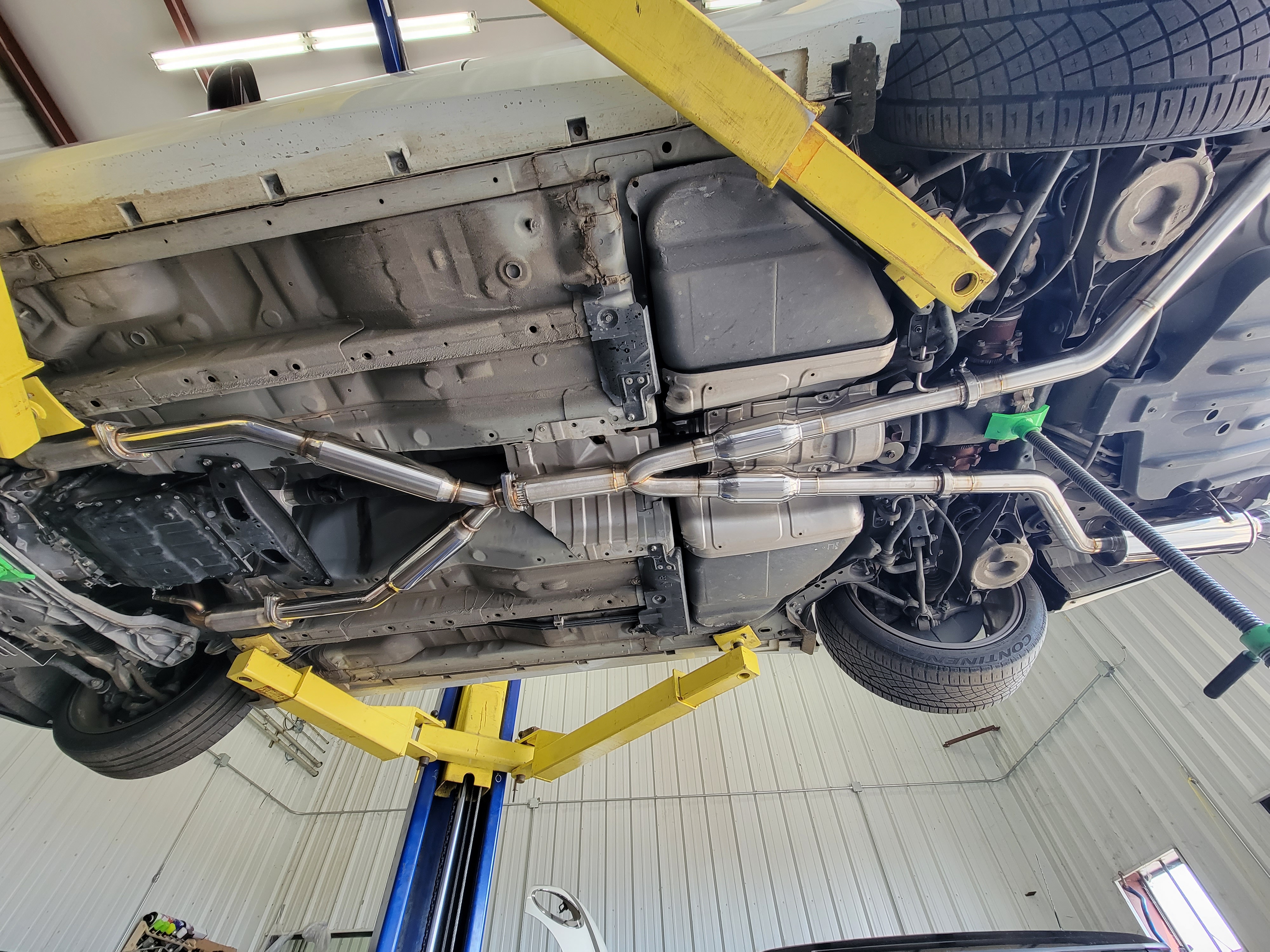

Today I got the SOHO catback with the ThaiTanium resonated Y pipe installed.
When I have the time I will provide a video and measurement of sound. I also have measurements of the Stillen catback with FI RHFC and a hallbuilt single exit with stock cats. I measured these with the same standards/methods that Commiefornia uses.
I'm still in the process of a retune as I need to buy some clamps for my intake. There's apparently an issue with the car not being consistent in it's demands. The tuner says I'm running rich after the car is trying it's best to remove fuel, at times. At other times it's not happening. He said I may have an air leak and asked me about my intakes. I showed him and he noticed no clamps. It was my understanding that the Z1 couplers could be used without clamps lol.
So I'm going to buy clamps for the couplers at the TBs, the couplers later down the pipes and the couplers for the PCV system that go into the pipes and pick up on tuning process from there.
Anyway, here are the pics of the exhaust work:

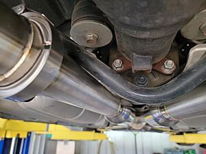

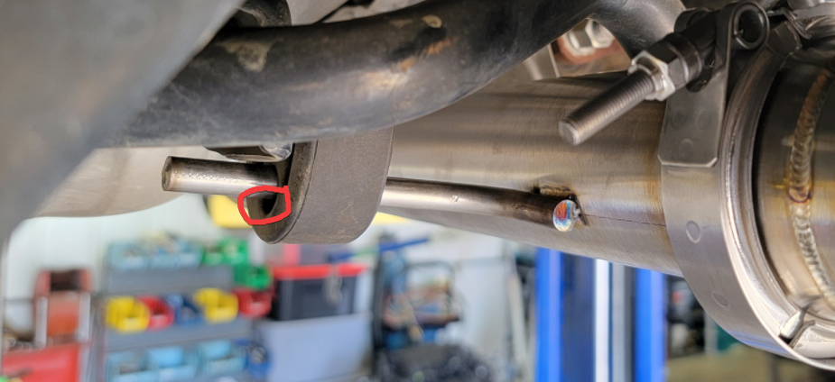

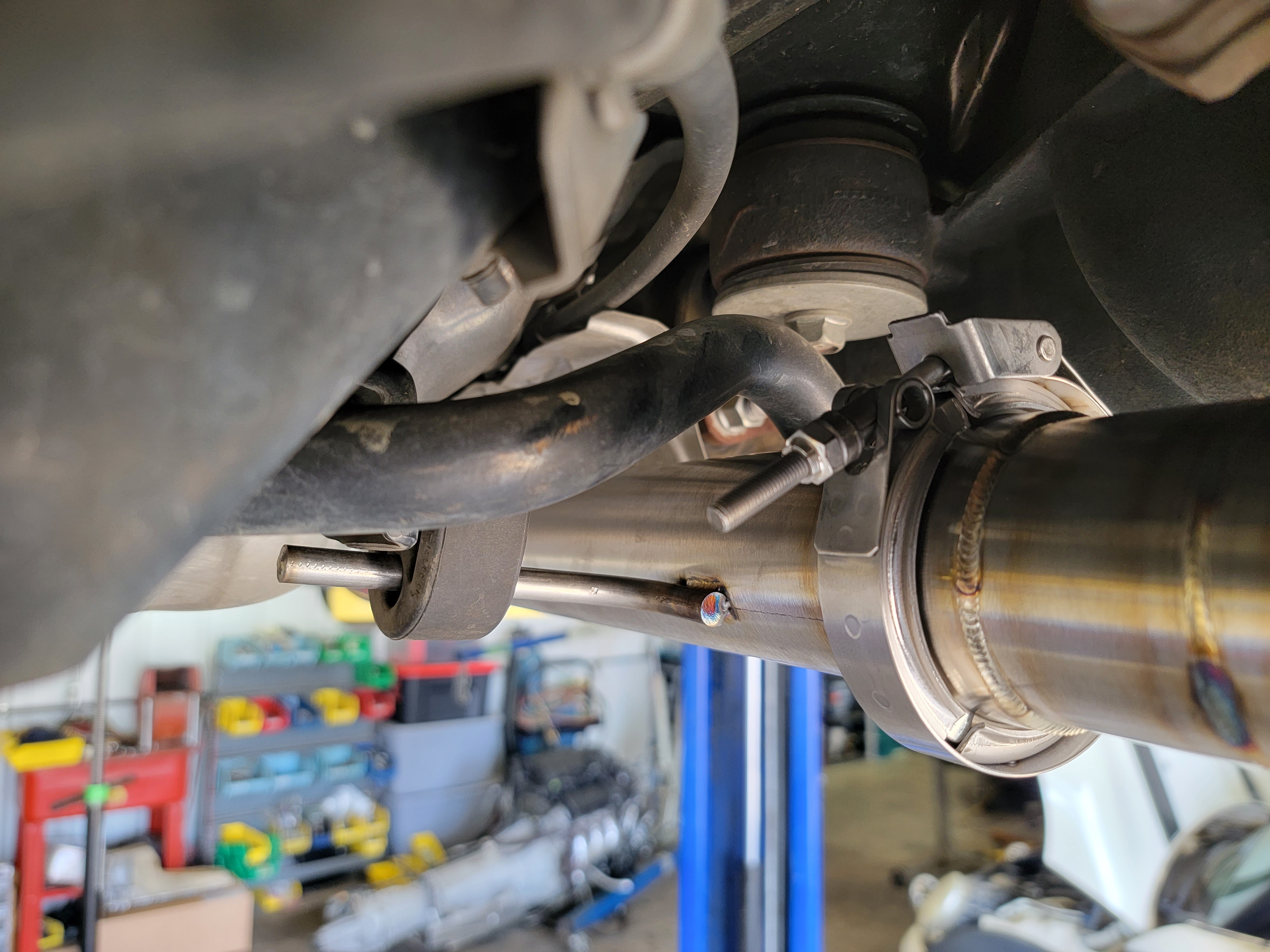

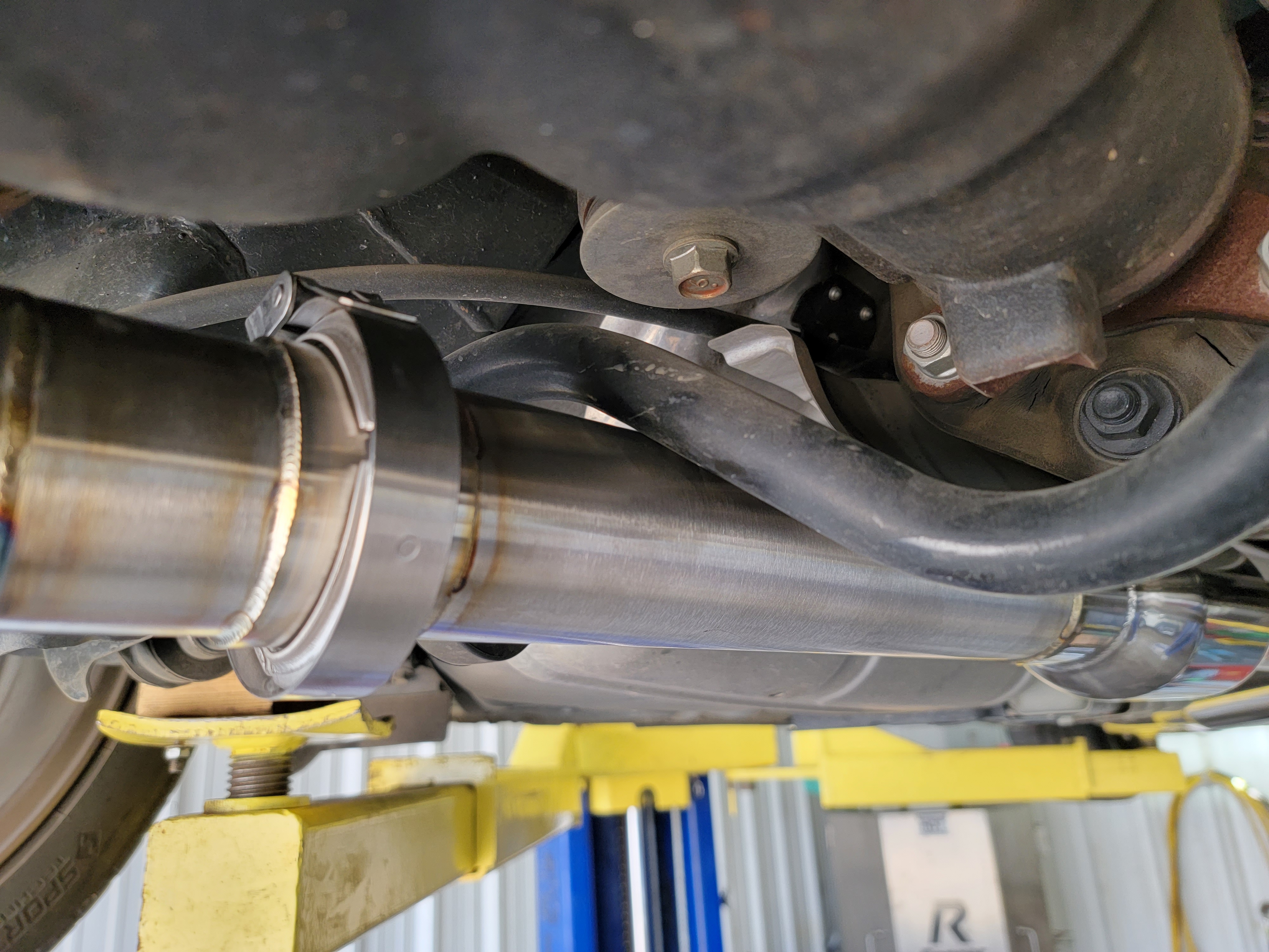

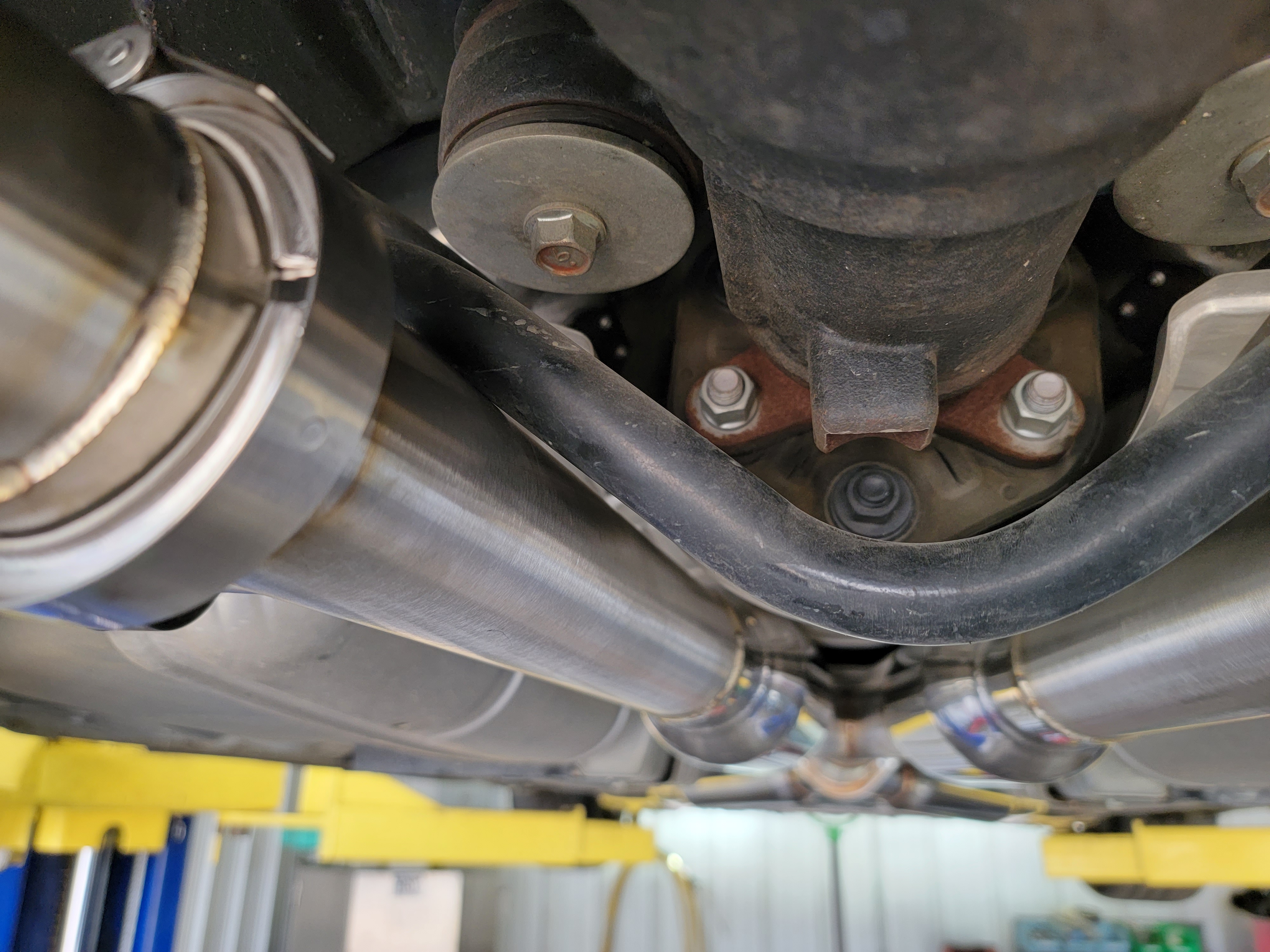

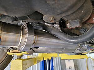

Now, onto the issues. The shop pointed this out to me. They showed me how the left exhaust pipe was too close to the sway bar and said it would rattle. They said there were no adjustments they could make to fix it. I contacted SOHO and they told me to email them pictures. I'm awaiting a response from them. Here are images:

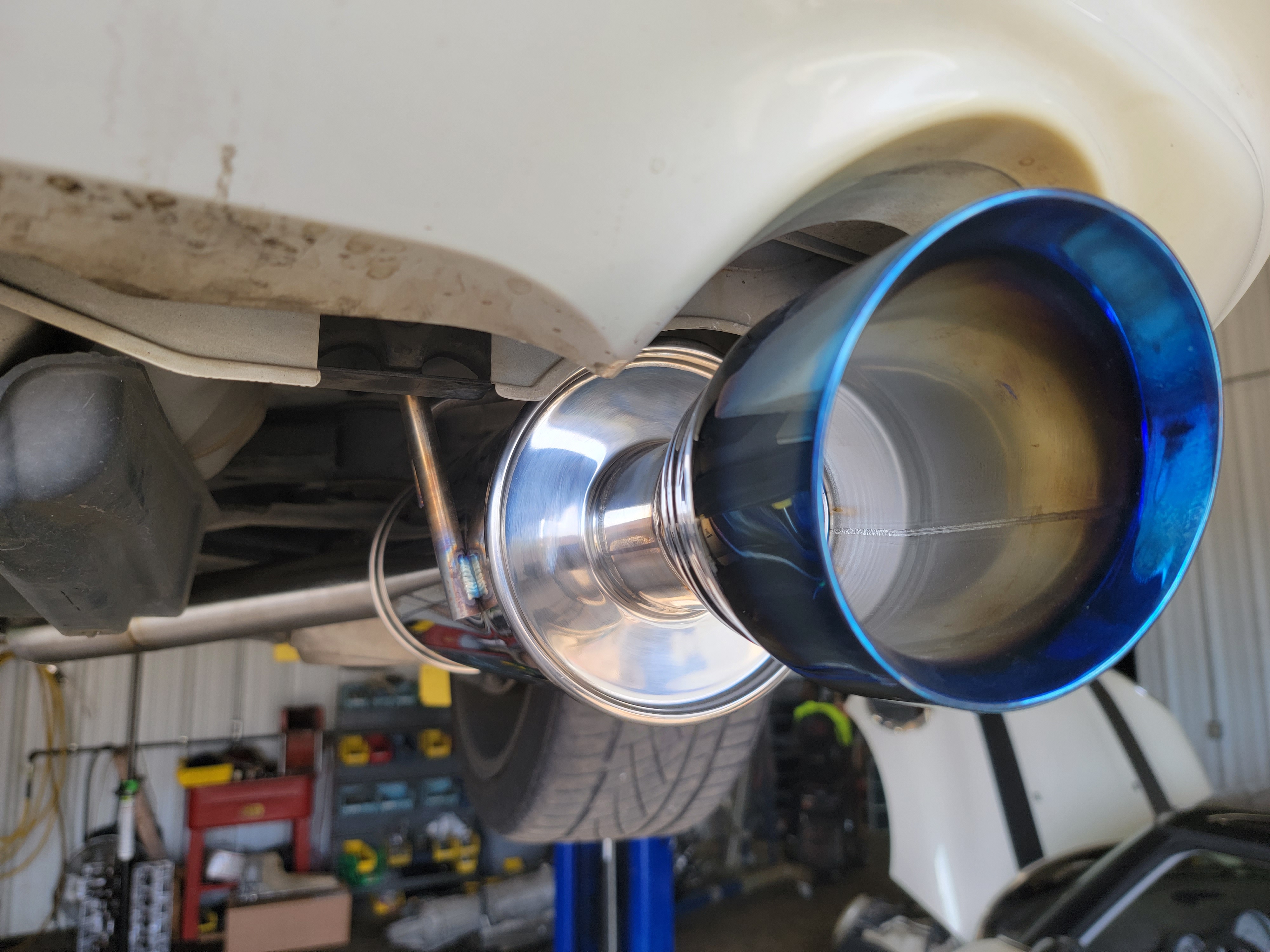

After I decided to head home with this issue, they were commenting on how they don't like how far the tips stick out. I told them I DO like it and I had asked SOHO beforehand about this and they told me they stick out "slightly past the bumper". I explained my reasoning was fear of burning the bumper (and wrap once car is wrapped). So here's an image of just the tips.
In addition to awaiting a response from SOHO, I was thinking of upgrading the sway bars to ones of smaller diameter to get around this. There ARE rattles, but they are minimal and at certain RPMs. But still, it bothers me.

From: WPB
Originally Posted by AnotherVQ
Check out that hanger, its not sitting down in the bushing, your axle back mufflers are pulling it all up. Id suggest simply putting washers or appropriate spacers under the two bolts of each of the muffler hangers to help lower it. Should solve your issue.
Old Mar 4, 2022 | 10:50 PM
  #8940
AnotherVQ's Avatar
AnotherVQ
Joined: Nov 2019
Posts: 718
Likes: 94
From: Arkansas
Are you talking about this gap here?
I need to put something in the slot there to make the hanger sit in that empty gap area?
