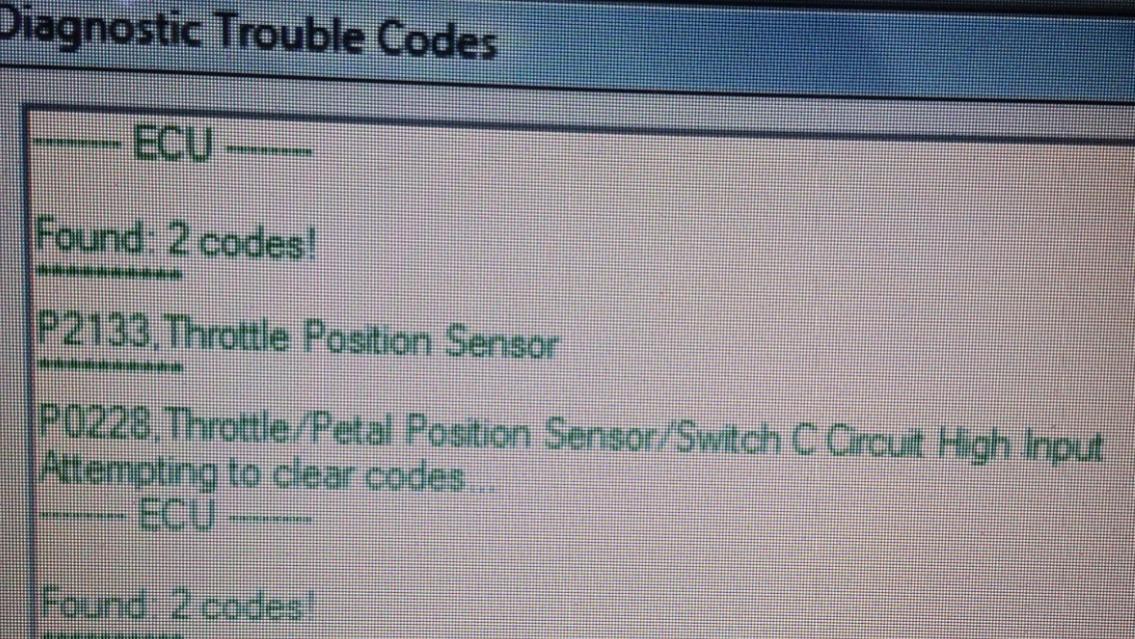

Finally got the tune on the car and found out I'm throwing two codes that don't allow the car to stay running. P2133, P0228. I've researched it a bit and could be a pinched wire or a new TB. Any have any experience with either of these?
I've seen this happen before. Usually it is when the FPR isn't bent out of the way enough and the wires for the new TB connector get bent/pinched. Also happens when people just extend the wires and use the wrong grade/gauge of wire to do so. Could be something else, but that would be what I would check first along with the pin connectors.

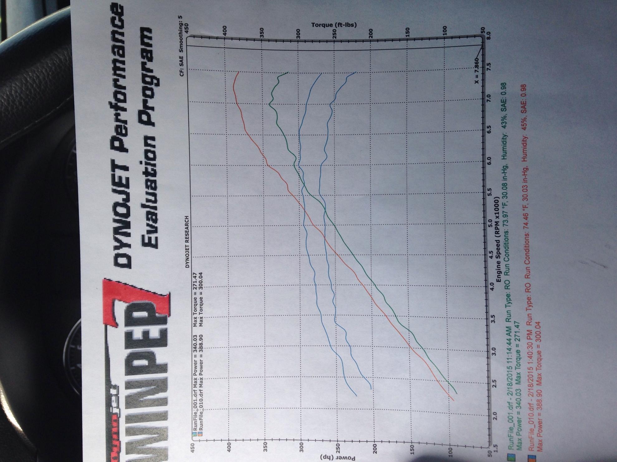

Only got 388 at the wheels at Stillen. I have a friend who lost 30whp just going from one dynojet in SD to Stillen's dynojet, so who knows exactly where I sit...
What is your complete setup?
Ouch!!!!
