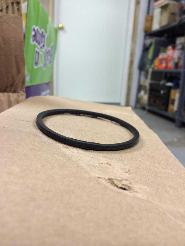

Originally Posted by whiddles
Can you show us a picture of the back of the o-ring (part that is seated in the intake in the picture).

yes when I get home. or if my wifes can send me a quick pic.

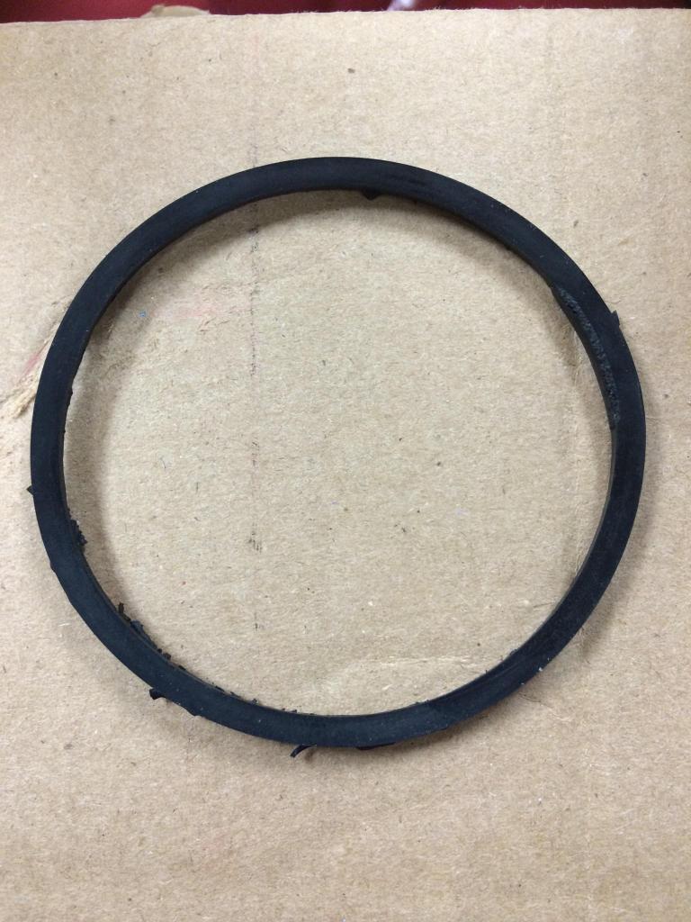

From: ft hood texas, Middletown,CT

Sorry for your troubles, I feel for you. If installed correctly and it was at a stillen dealer and this still happened, the shop who did the work is liable. Imo
the shop did nothing to cause the water leak which hydro locked my car though
If they over torqued the manifold they would be liable. That O ring looks pretty frazzled along the edges, maybe a sign of failure due to too much torque. Then, the ensuing pressure and heat warped the core causing the leak? So many variables to consider. This type of possible failure is the reason I didn't choose the stillen SC kit, to me it seemed risky. Decided in the end just to stay na.

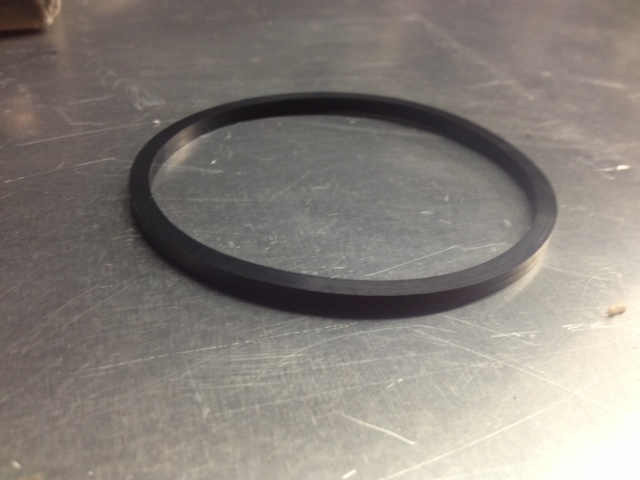

Stillen o-ring picture sent to me from Trent
mine

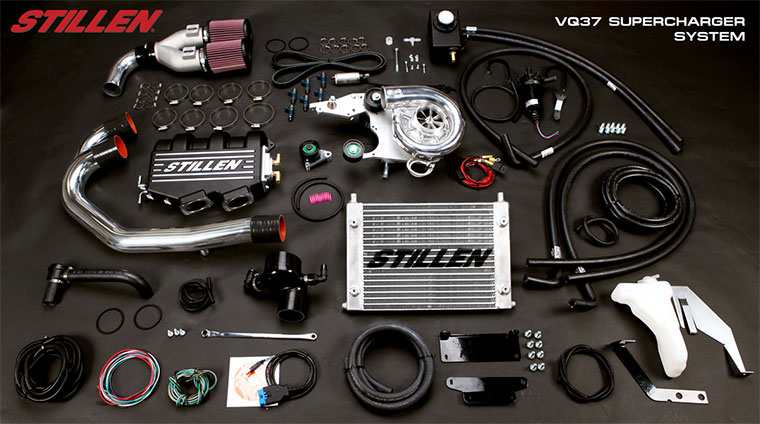

??? So he says there Square EH,
Attached Thumbnails Who has a Stillen G37 Supercharger? Numbers, pics, vids!-stillen_nissan_370z_supercharger_1a.jpg
