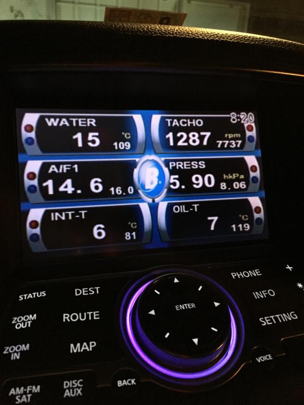

Originally Posted by Diego@Vossen
I currently do not have any gauges, it's on sleeper mode but I may end up getting the Blitz R-Vit so I can use the oem screen in our cars.
hey diego blitz is great 4 years no issues only one down fall you cant listen to music while on the blitz screen but then who needs music when you have a supercharger!
Very sweet
