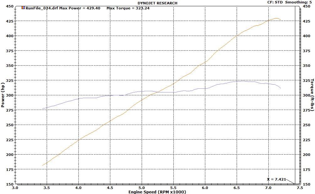

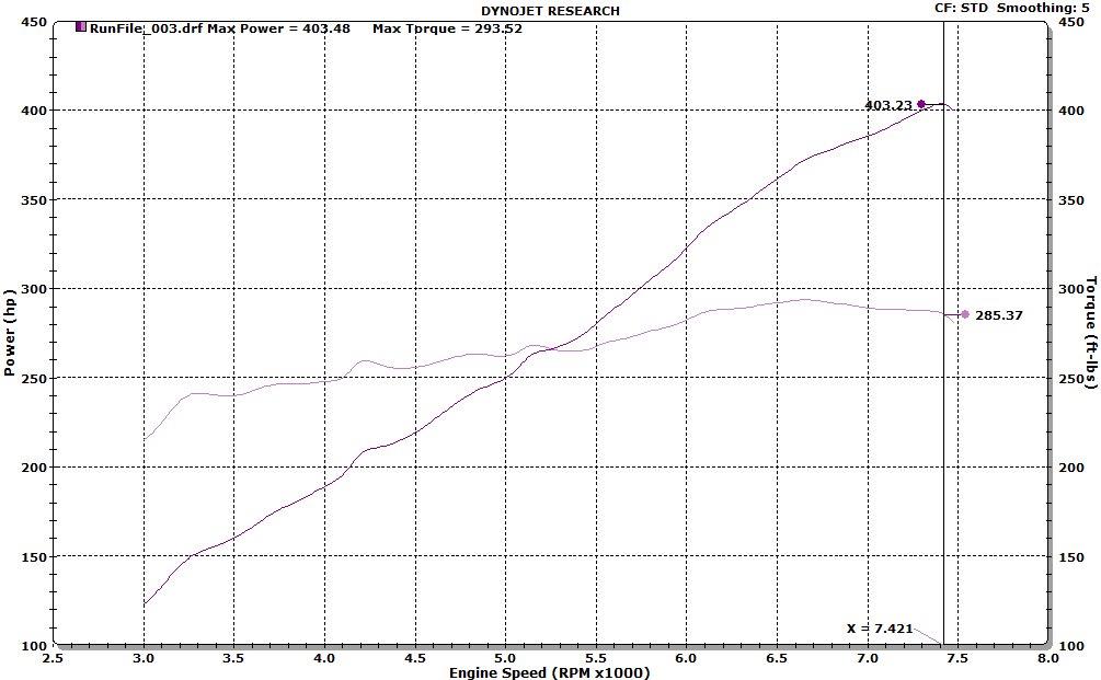

Originally Posted by BANNISTER
Does anyone know what kind of power the stillen kit puts down with the reflash from stillen ?
On 93 octane - G37 IPL Auto (stock 19's)
91 octane - STILLEN 370Z 6MT and lightweight 19's (lost about 14 whp when going to 20x12's in the rear)
On 91 octane - 2009 G37 Coupe Auto (stock 19's)
