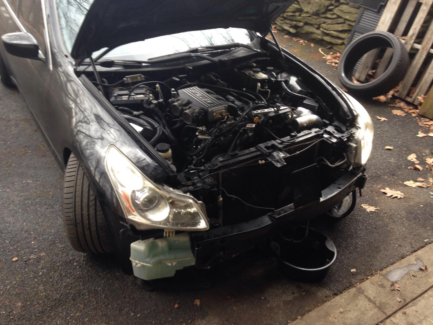

Took half the kit off. No signs of anything being loose or damaged. Might have the engine completely out tomorrow night for inspection. If anyone has stillen gen 3 intakes or knows someone who does, let me know...Im going to need them here shortly.
Attached Thumbnails Who has a Stillen G37 Supercharger? Numbers, pics, vids!-image.jpg

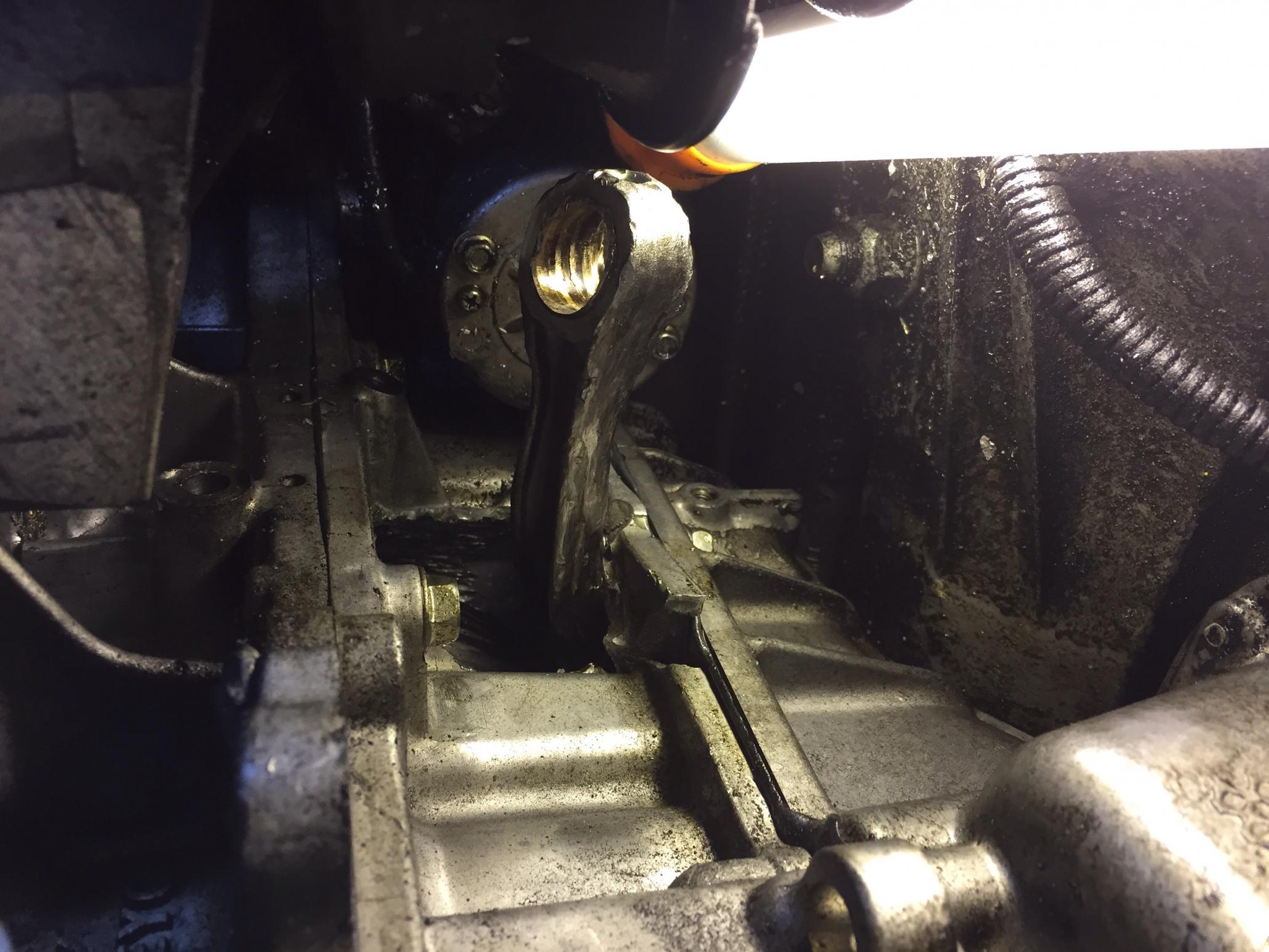

Found where all my oil was draining out from.

WOW :/, Detonation FTL

Wow...that rod litterally punched through the oil pan.
I'm not an expert in this area, but I've only seen rods get thrown (quickly at least) from over revving. This is definitely something new to me for this motor. The few motors I've seen blown are usually ring landings breaking.

Mine did the same thing, I threw cylinder 3

Bad enough det will do this. Higher RPM's but not necessarily over-revving. If the detonation is bad enough over 5,000ish RPM, you can window a block.

^ Knocking as in, broken parts rattling around in the motor? Or Knocking as in detonation while the motor was still running 'fine'? If it was the latter, then the tune (detonation) is what broke the rod, and then piston velocity (even at idle) is what threw it through the block.
