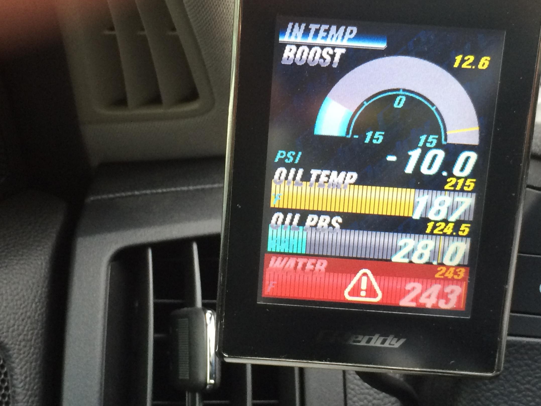

Anyone care to share what kind of gauges or monitoring you guys are using on your sc kit ? Pics ??
I use greddy informeter with boost, temp, and pressure sensors.

Attached Thumbnails Who has a Stillen G37 Supercharger? Numbers, pics, vids!-image.jpg

Number ? Can see the vid at work man !
Boost us scary but built so GOOD, water temps are high? when are the fans coming on? should be 100% 185? I had not temp issues with mine?
That's actually an old picture mainly taken for my tuner, was too lazy to take more pics so I just posted that. lol. The high temp issue is fixed now. There are so many heat exchangers infront of the radiator that there wasn't enough airflow when the car was at a standstill. The fans come on much sooner now.
