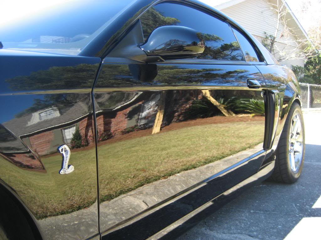

I recently Join Autopia after ya said I should try it and someone message me from my location. I need your opinion on him since I know Rotary buffering and wetsanding is bad if isnt done right and he uses them alot but he say he is really experience with it. It looks like he is very good with it.
here is his gallery
http://www.ajautodetail.com/gallery.htm
also here is a few post of his from autopia.
CL55
http://autopia.org/forum/pro-details...ll-detail.html
645Ci
http://autopia.org/forum/pro-details...bmw-645ci.html
ford Cobra
http://autopia.org/forum/pro-details...svt-cobra.html
What do ya think? Should I pull the trigger and schedule a detail from him? He seems very legit from all his post on Autopia. I am veery **** when it comes to my car so usually only I can drive or touch it so I figure i ask the pro before I make my decision
