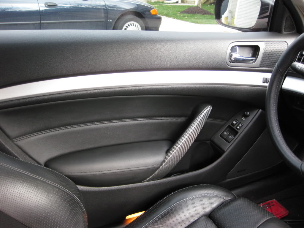

I have slight cracking on the bolsters (see pics). Do you think I should pick up some rejuvenator oil?
Tough to say if the Rejuvenator Oil would help w/ those types of cracks. What you can do is lay a damp towel over the affected areas and put it out in the sun. This can help tighten up the leather and minimize some of the cracks. Rejuvenator Oil can help soften the leather which can help minimize the look of the cracks, but I wouldn't expect it to look 100%. Keep us posted what you end up going with and how things turn out. Also, it's best to use the Leatherique products together as the Prestine Clean is designed to remove the Rejuvenator Oil after it's sat on the seats.
George
So steps would be Pristine Clean, Rejuvenator Oil, then 303?
Actually, Leatherique is slightly different, you let the deeper penetrating Rejuvenator Oil do it's work first, then clean it up with Prestine Clean, then 303 to UV protect. Here's a link to our how-to on Leatherique as it's not laid out to clearly on their labels.
The seat in your picture looks EXACTLY like my car. Let me know how the Rejuvenator Oil works. I soaked mine with some Luxol conditioner and it only improved it a little.
