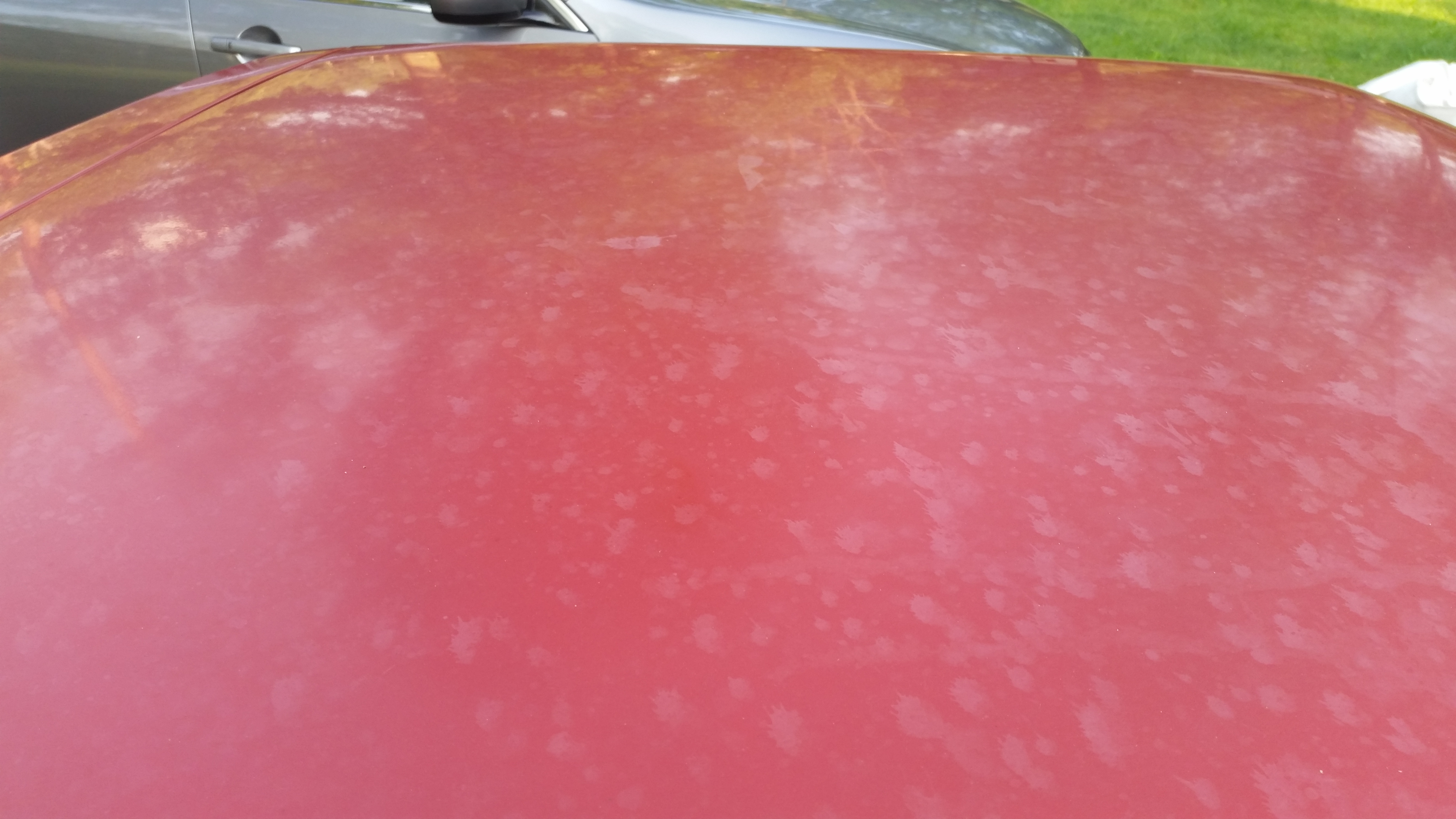

Water Spots
My son just bought a 1990 Mustang GT and it has these spots on the roof. Will polishing remove these? I have Menzerna and a PC with pads that I use on my G. Heres's a pic of the hood.
Hi - it is quite difficult to tell what the spots are from your photo.
In good practice, I would start with the least aggressive approach first and work your way up.
If it appears that it might be surface contamination, you may try detailing clay or a solvent to remove the staining/contamination. If it is oxidation or below surface defects, you will need to do some polishing or paint correction.
Hope that helps!

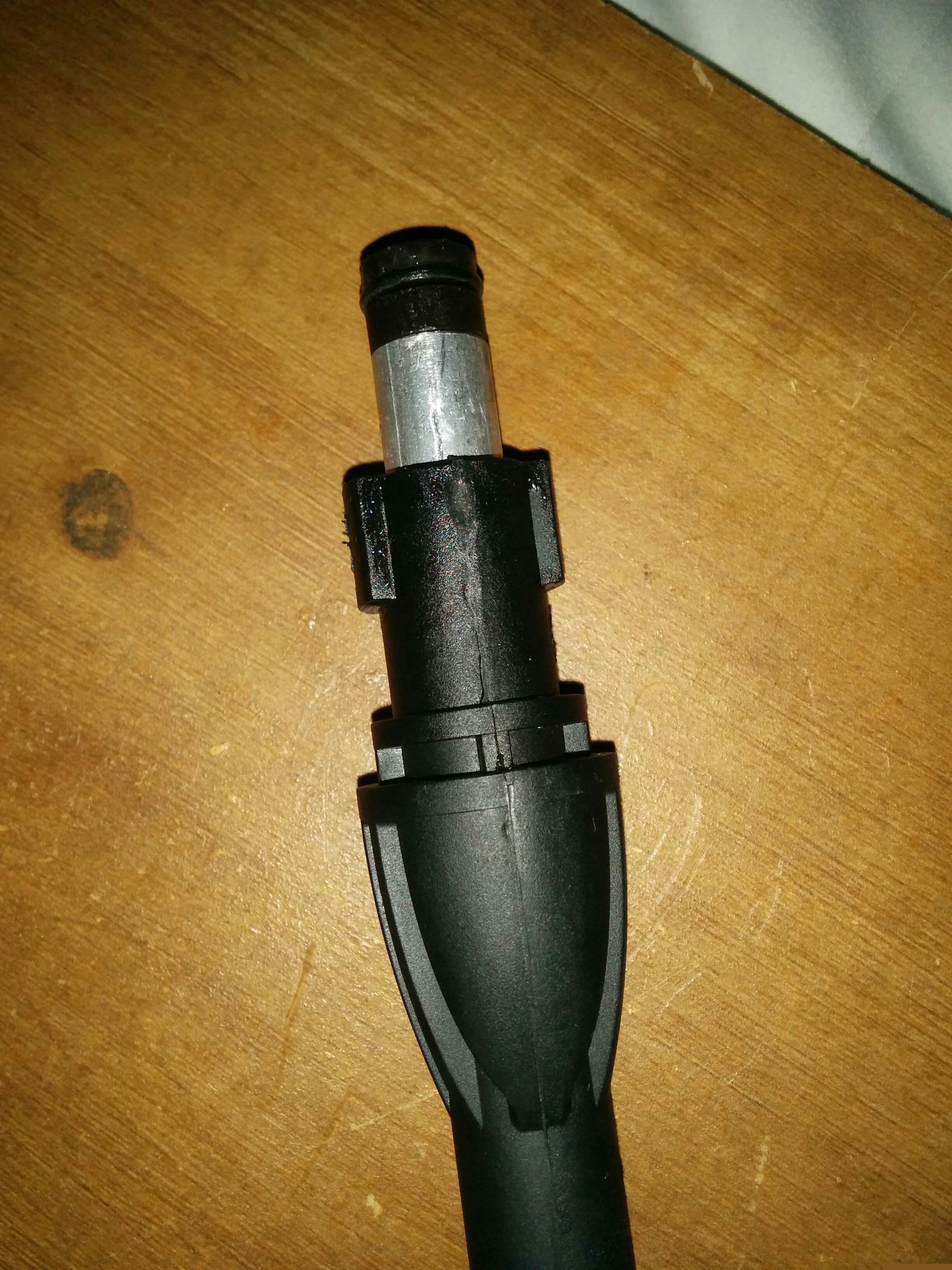

Hello. I was wondering what type of fitting this would be. I'm looking for a foam cannon and trying to get the right fitting. It looks like a Bosch fitting but I saw this here:
What kind of pressure washer fitting is this for foam cannon HP? - Auto Geek Online Auto Detailing Forum
I was thinking maybe it could be a Lavor. It also looks like it can be a Black & Decker fitting. Not really too sure which one I need.

I'm sorry, I am not too familiar with this... our Foam Lance has a common fitting that will work on many pressure washers, however if you do not think it will work with yours, there will likely be an adapter required.
We carry the Karcher Adapter for Karcher pressure washers, however I am not aware of other adapters that are available.
Sorry I couldn't be of more help.

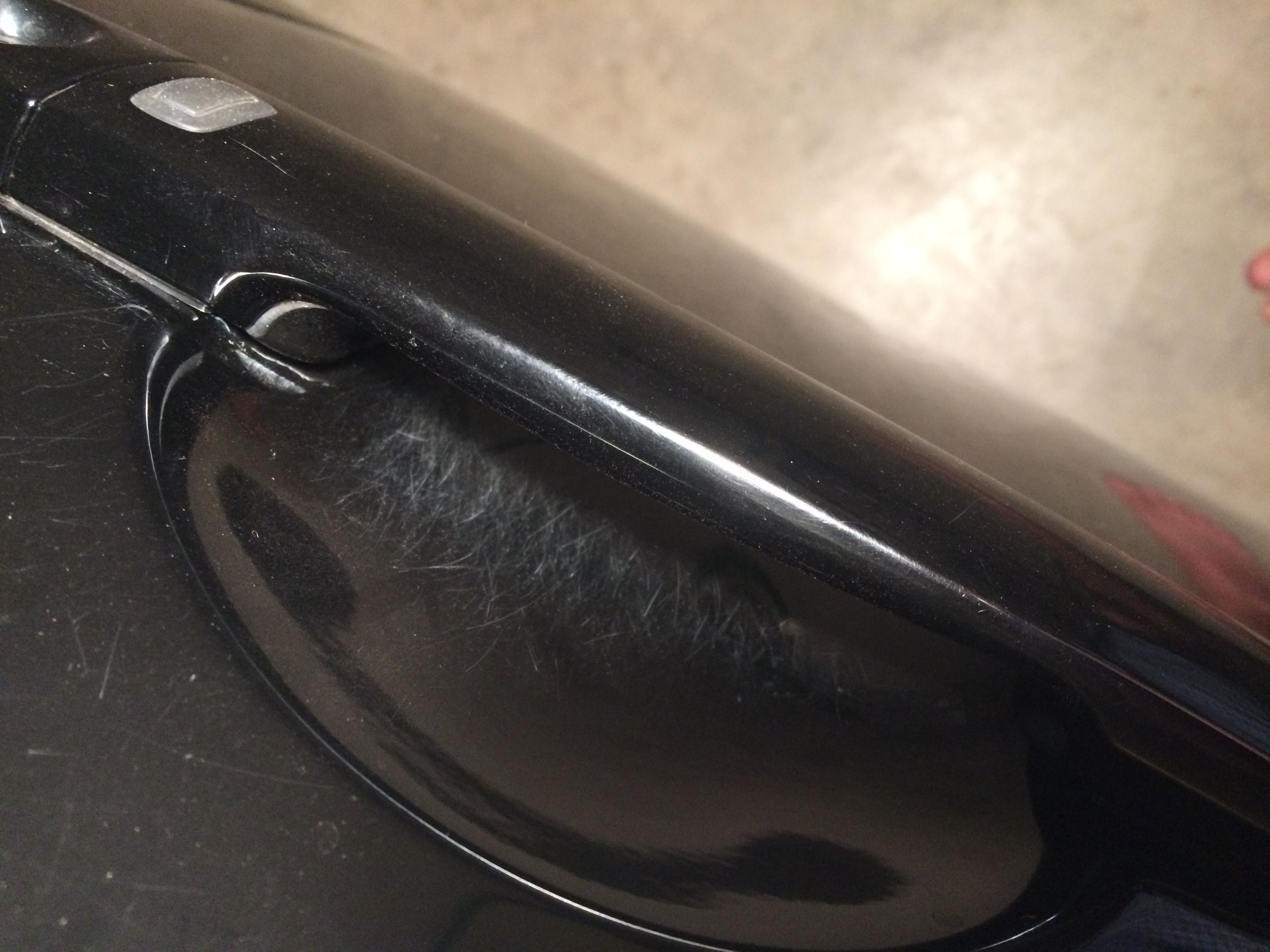

Hi Zach... question:
Previous owner must've had hellacious fingernails. How do you suggest getting a cutting polish at these scratches? Is 'by hand' my only option?
Ask a Professional Detailer... Brought to you by Detailed Image-img_0875.jpg
Attachment 113420
Thanks for your contributions to the forum.
This is quite common... it doesn't take too long for the area beneath door handles to look like this - especially with female owners.
Polishing by hand is the only option here, but you can achieve some pretty great results quickly. Since this area is an awkward spot that will never really see any direct sunlight, a perfect finish is not necessary, so that makes your job easier from the start.
The way I tackle this area is to simply apply a small amount of compound (such as Meguiar's M105) to a microfiber applicator pad or to a clean microfiber towel, then rub back and forth under the handle with moderate pressure. This may need to be repeated a couple of times if your paint is stubborn or you have a considerable amount of defects, but in general, it is quite simple to improve the area in just a few minutes.
Hope that helps!

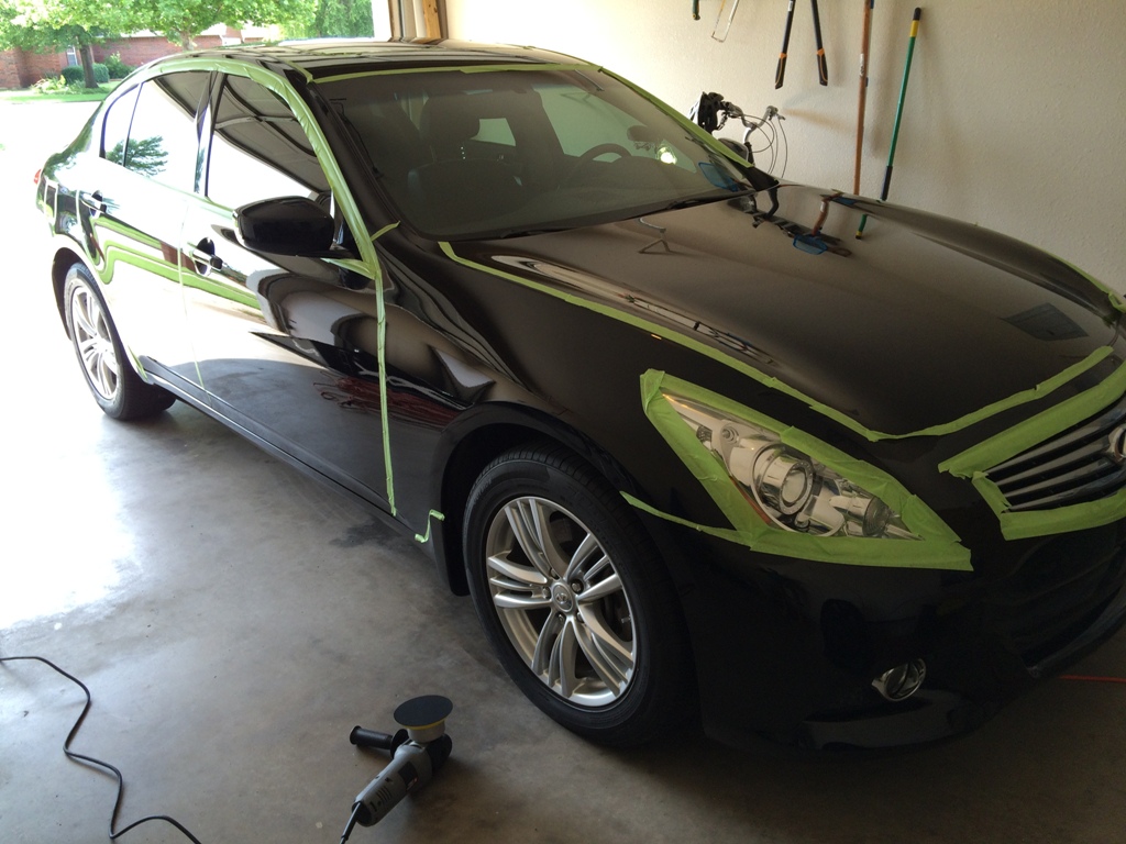

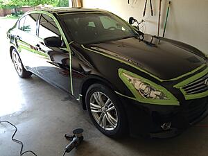

Just finished my project. Had some minor scratches and discoloration spots, very swirly black paint and those scratches under the door handles.
First I wet-sanded the scratches, then used Meguiars Scratch-X V2 on the fingernail scratches under the door handles. Then using a PC 7424 buffer I did the Manzerna SI 1500 per DI's instructions, then Manzerna SF4000. Used a 50/50 IPA/water wipedown to clean off the polishes after each step. Finished with Manzerna Power Lock sealant. I am wore the hell out but the car looks absolutely stunning. Could not be more pleased with the results. Thanks for the detailed information & guidance.
Funny thing... before I did this I could barely see orange peel here & there. Now I realize almost the entire car has orange peel. It's not enough to make me want to correct it (can imagine how much work that would be). Just disappointed a luxury car has such a paint issue. The paint itself is fine, but the application is not what I'd expect from Infiniti. After this sealant cures I'll do another coat of sealant and see if that helps fade the appearance of the orange peel.

Sounds like you knocked it out of the park! It is a lot of work, but it is a labor of love, and the results are always worth the effort It's why I fell in love with this type of work and why I continue helping others learn how to DIY... if I had it my way, every car owner would own a DA machine and know how to use it
As far as the orange peel goes, I would not consider it a negative really. Almost every car has it to some degree.... unless it was an aftermarket paint job, the clear was sprayed extra thick, and a tremendous amount of time was spent sanding and polishing.
OEM paint is so thin these days, I personally do not recommend trying to remove orange peel as I do not feel the benefits are worth the high risk of damage.

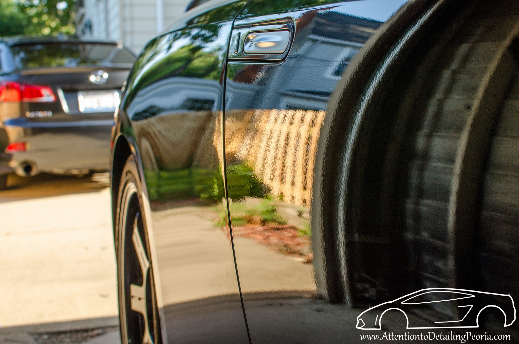

This might make you feel better.... check out how bad this orange peel is on this brand new (at the time) GT-R Black Edition. This was some of the worst OEM orange peel I have seen... but oh well.

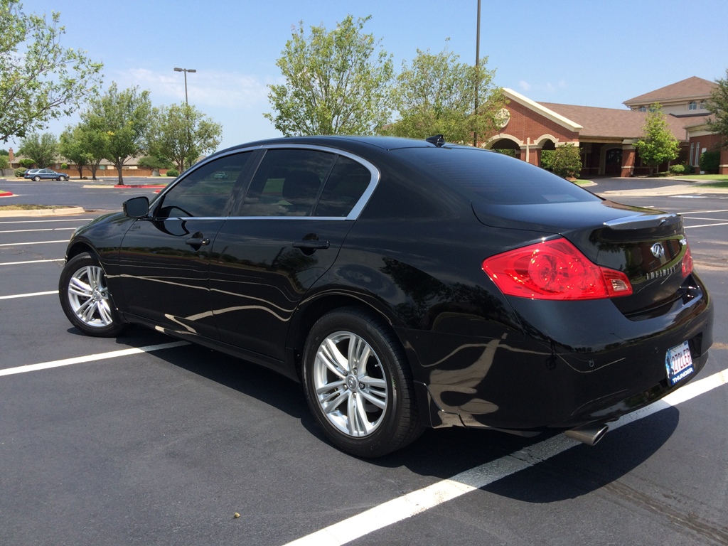

okay yeah wow mine's not even close to that. Once you get the deep shine, they are way more noticeable. Didn't realize it's not uncommon.
Tried couple different ways to get the previous sealant/wax off.
I'm sure the concentrated soak helped break down the wax, but I couldn't get the sealant off until several passes with straight IPA.
Neighbors probably thought I was losing my mind in the driveway out there, lol - soak, wash, rinse, wash, rinse, spraying, wiping, cussing, rinsing, etc etc but at least now I know.
And not sure what's worse: picking up a little corner of tape w/the buffer, or cleaning polish out of seams. I got hurried with the tape, wasn't as precise as it should have been.
Wish I had closeup 'before' pics....
After the SI 1500, before the SF 4000:
Finished product w/ one layer of sealant:

Looks great!! Nothing better than nicely polished black paint. Nice job!
