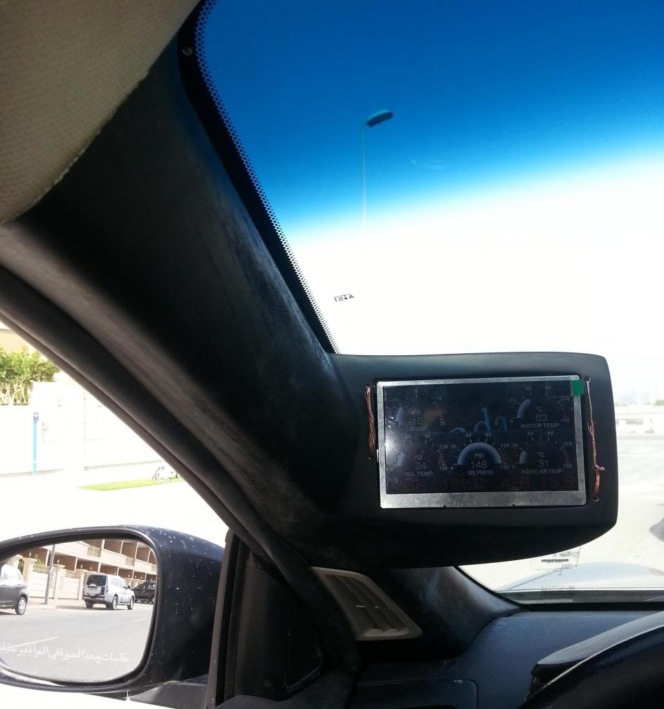

Carbon Signal treats my G! Still under construction.

  #508
Emillion45's Avatar
Emillion45
Joined: Oct 2011
Posts: 300
From: SC
^^^ i want those mirrors!!

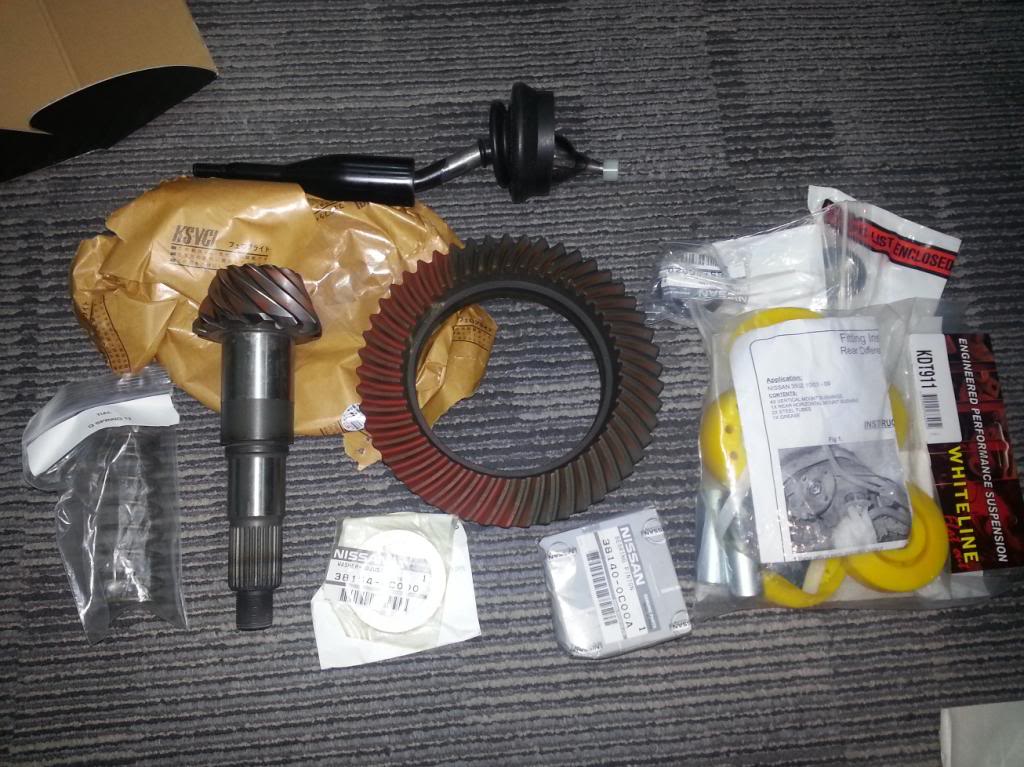

Special thanks to Black Betty for putting this together and shipping it to me.. I owe you big time J
Should be a fun weekend!
