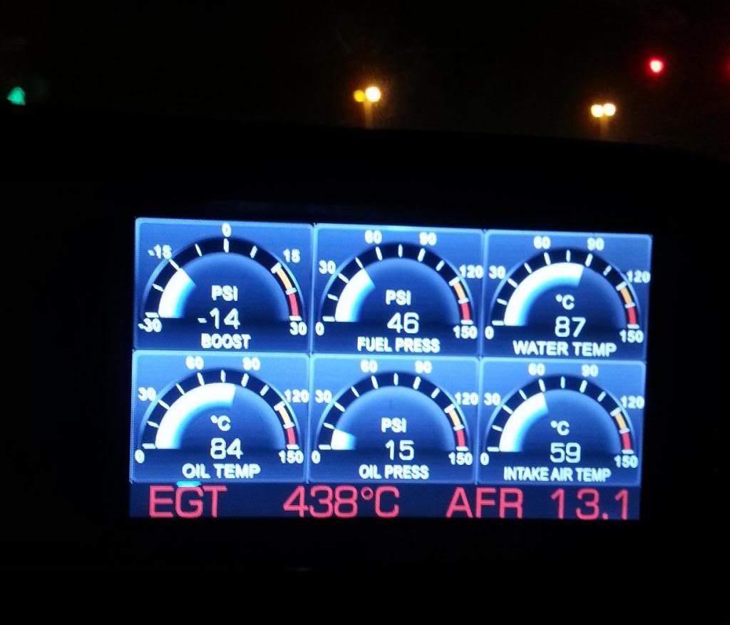

Originally Posted by G37Sam
Carbon Signal treats my G! Still under construction.
Hey Sam, build is looking awesome. Considering my 370GT gets blown away by modded RB26's all day long here in Aus, I know that you will be very happy with the eventual outcome!
Can you let me know what gear you used for your MFD setup in the pic above? I have been looking for an all in one gauge setup and can't find many that come with everything that is needed and the ones that do (greddy informator, blitz brain etc.) all come with horrible looking touch screens.
Are you reading boost and oil pressure from the ECU via OBD2? Is that even possible? Can the sensors be added?
It's a setup I bought from Zada-Tech in the UK. They don't communicate with OBD (mine would be useless anyways). You choose what size screen you want, what parameters you want to monitor and they custom build one for you and send it along with all the necessary sensors with a pin & wiring diagram. It is quite impressive.
My screen is a 4.3" because I opted for 8 parameters (Boost, AFR, EGT, Oil PS, Oil Temp, Water Temp, Fuel PS, IAT). I think you can make room for a 3.2" screen (4 readings) in your ashtray or sunglasses holder if you don't want to butcher your A-pillar.

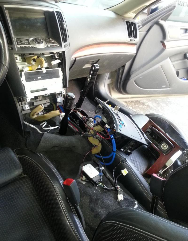

Quick update, been doing some interior work, here's a before pic of what it looks like today:

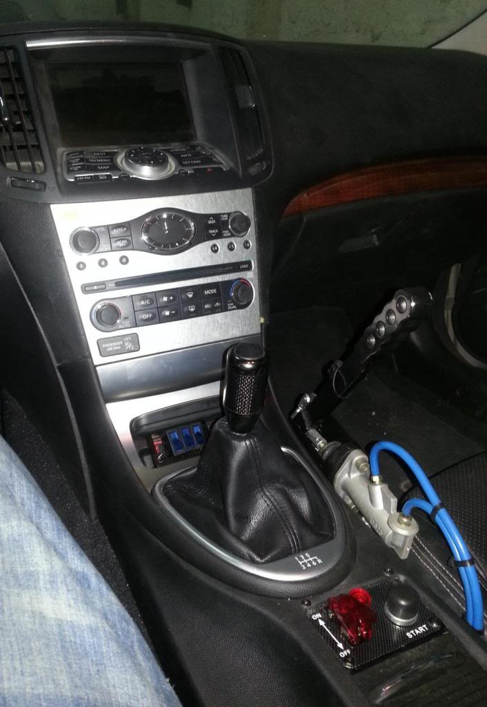

And an after pic!

Man did it feel so good to have it all cleaned up inside! I also hooked up the fuel and oil pressure sensors finally, the car was cutting a while back and had it narrowed down to either the ECU cutting fuel or Fuel Starvation. Fuel starvation confirmed! Surge tank here I come! Good to have all 8 readings working meanwhile

Is that a brake proportioning valve?
Old Jul 8, 2013 | 05:49 PM
  #538
ashmostro's Avatar
ashmostro
Joined: Apr 2012
Posts: 1,120
From: Arlington, VA
Oh wait, it looks like it could be the parking brake...
Old Jul 9, 2013 | 06:18 PM
  #539
G37Sam's Avatar
G37Sam
Joined: Aug 2008
Posts: 12,173
Likes: 244
From: Doha, Qatar
Yup that's a hydraulic e-brake that I can use for parking and inclined starts.
