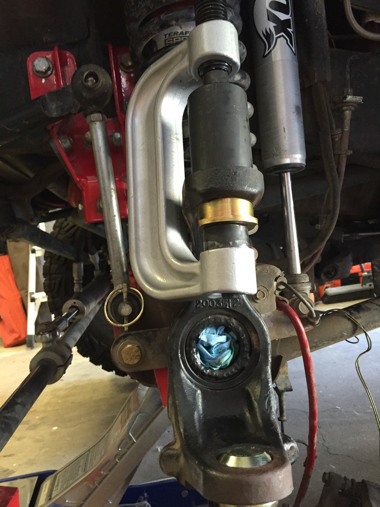

He may need a short C-clamp type press to get the new bushing in. We did not have the right tools in a fully stocked Nissan shop partly because our shop has yet to encounter this failure and probably also because Nissan's fix is to replace the whole subframe and not just the bushing.
It is not a tool most techs have, but it is easy to rent from Autozone if you need it. Just take the bushing to your mechanic so he can make sure he has the right tools and properly sized cups to press it in from the back of the subframe because there is not a lot of room back there.

What anxiety do you have about the gears? Afraid you may be running too high RPM's on the freeway? If that's the case, you should just go out and drive an early 2007 - 2008 with the 5AT tranny. Mine runs at a little over 3K RPM's driving 75 - 80 mph on the freeway. Although that may seem a bit high it doesn't bother me at all and I also get around 30 mpg on the highway and average around 23 mpg, so it doesn't seem to hurt the gas mileage either.
Originally Posted by 4DRZ
That's the game plan.
I used one of these for my bushings. It's the C-Clamp press from an OTC ball joint kit that I used for the ball joints on my Jeep a few years ago.
I think that is very similar to what they have at Autozone that I was planning to use. Glad to hear it worked for you.

Yes, the one the AutoZone stores out here loan out are very similar to the one I have, but just a bit smaller. The OTC one I have is their "heavy duty" one that can also be used on trucks/jeeps. Just be very careful with the AutoZone one, because it seems to be fairly fragile. I had a buddy crack the one he checked out from an AutoZone store and then after he returned it they charged his credit card $250 for a replacement. Theirs seems to be fairly cheap unit (probably some China made Harbor Freight one or something like that).
Did you use this on the rear Differential bushing or some other bushing? Initially I rented it when I was doing mine and it was fine for the rear knuckle bushings but I could not get it to fit into position when doing rear differential bushing...there wasn't enough clearance behind the sub frame and forward of the spare tire well
Yeah, I used it for the rear differential bushing, as well as several other bushings on the Infiniti (and on my Porsche... and the ball joints on my Jeep... etc..). Although I had most of the rear end dropped at the time so there were no clearance issues.
Thanks for the tip! I'll be careful.
Did you use the Autozone rental or something else?

i ended up using a long theaded bolt (5/8) a bunch of washers and couple peices of this metal (http://www.homedepot.com/p/Everbilt-...203170046)...i drilled a 5/8" hole in the middle and threaded it through with some washers and the nuts on either end, slathered the bolt in old gear oil(very important ) put a socket with a breaker bar on the back and an electric impact wrench on the front and cranked for 10 seconds and it was done....before that i struggled for hours trying to use various tools that just wouldnt position right...also i froze the bushing for a week before....the setup was similar but not as complicated as in this vid at the 20min mark
