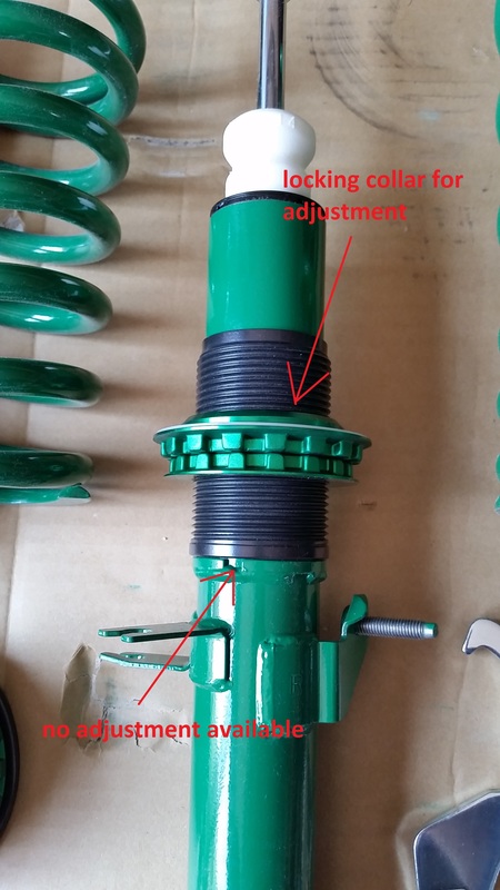

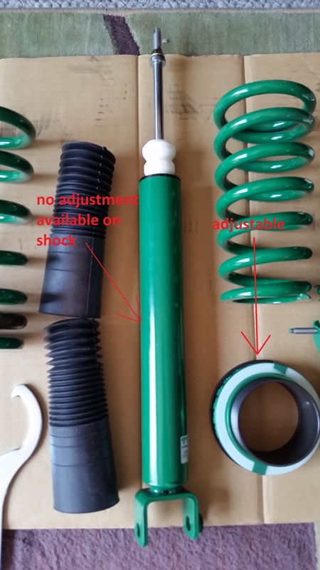

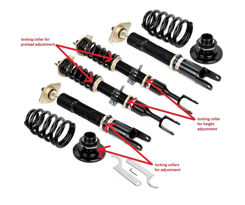

Here are pictures of both the front and rear of the TEIN basis which only has 1 set of locking collars on each:
This then would leave me to believe that the TEIN basis only allows you to set ride height and you cannot set preload. However, the problem comes when I called TEIN last week and spoke to a rep who said you DO have to set preload. But I am looking at the pictures and parts do not see how that is possible.
Am I missing something here!?! I'll call TEIN back on Monday to clarify if this doesn't get cleared up.
