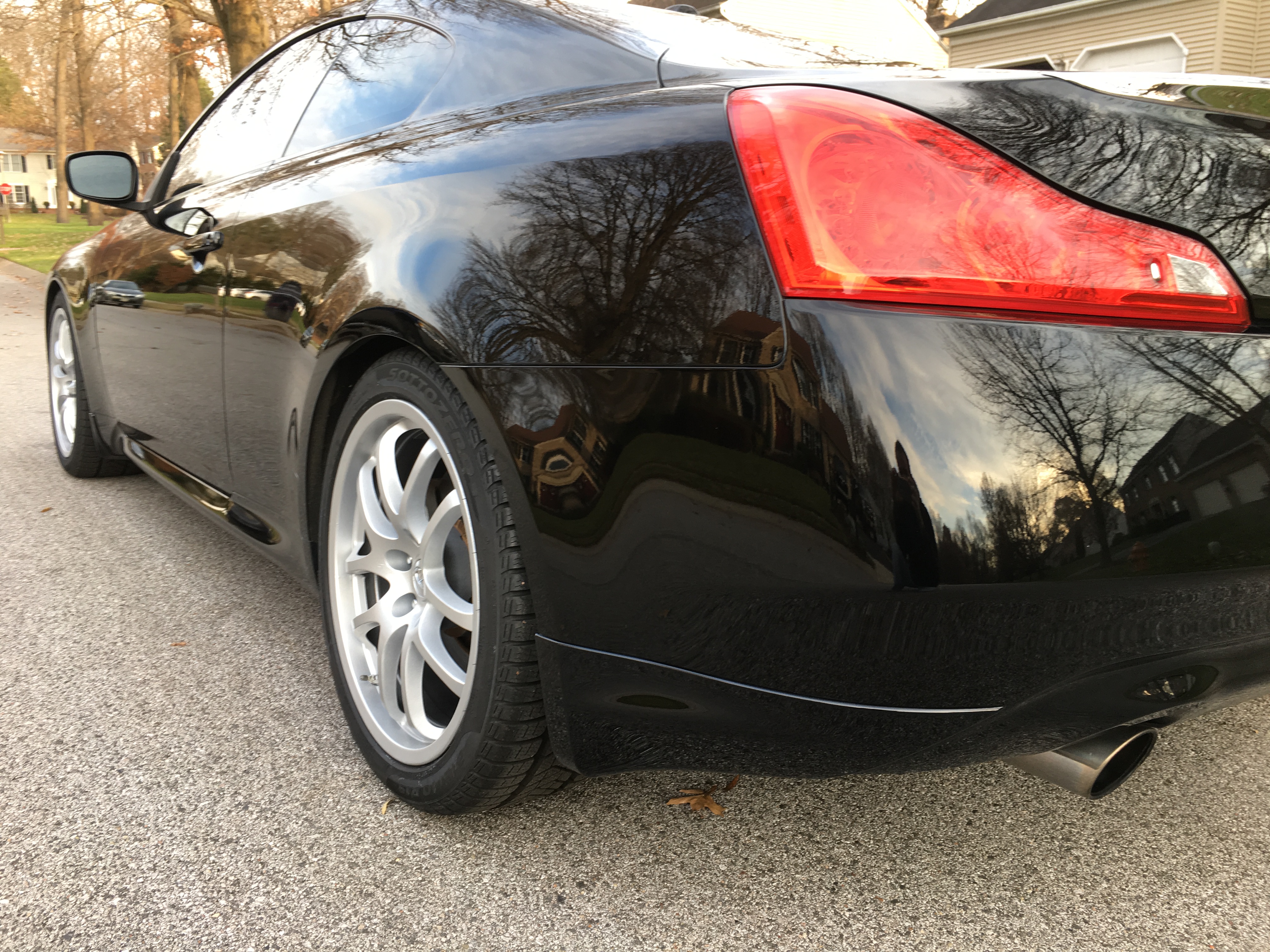

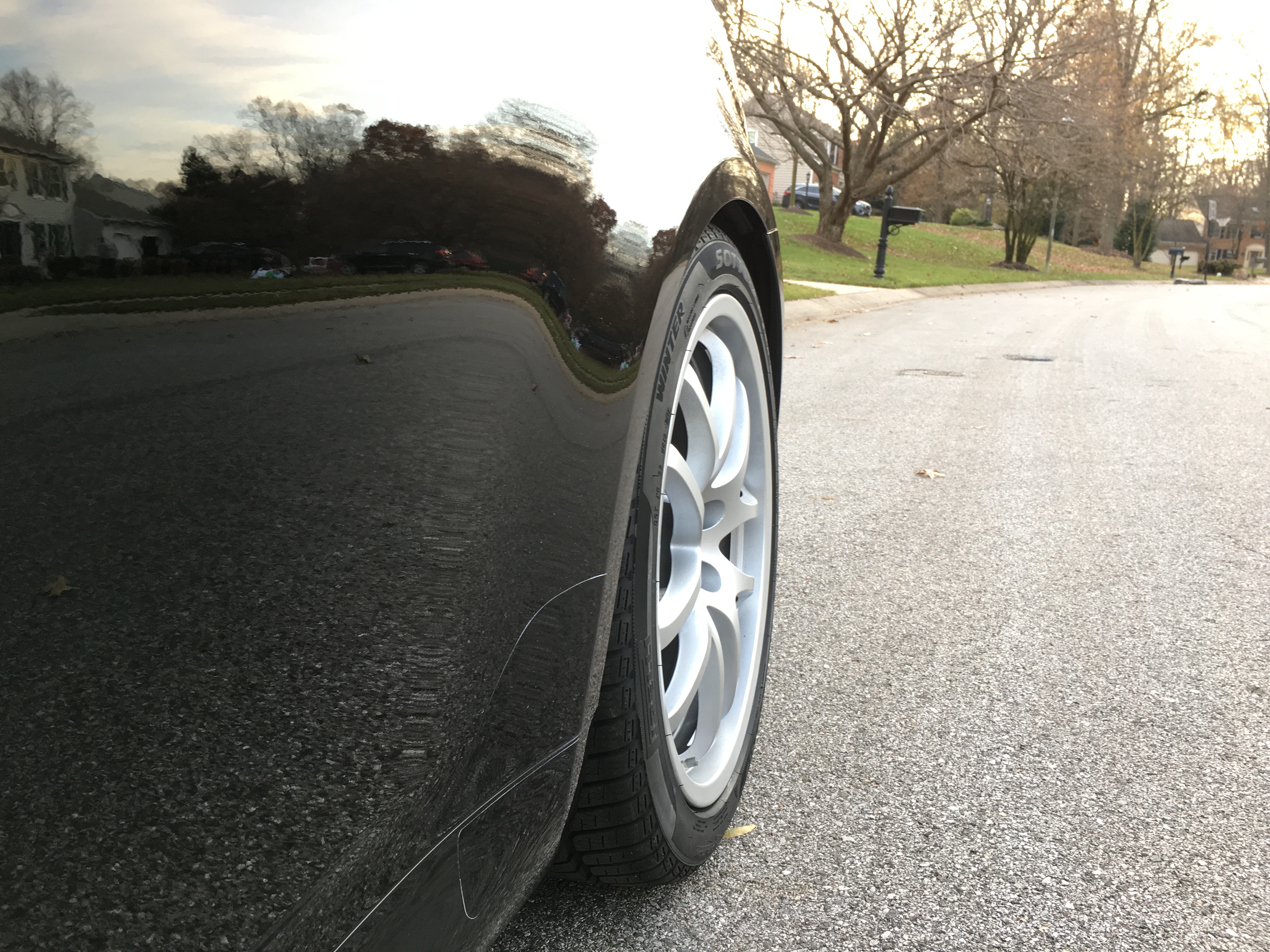

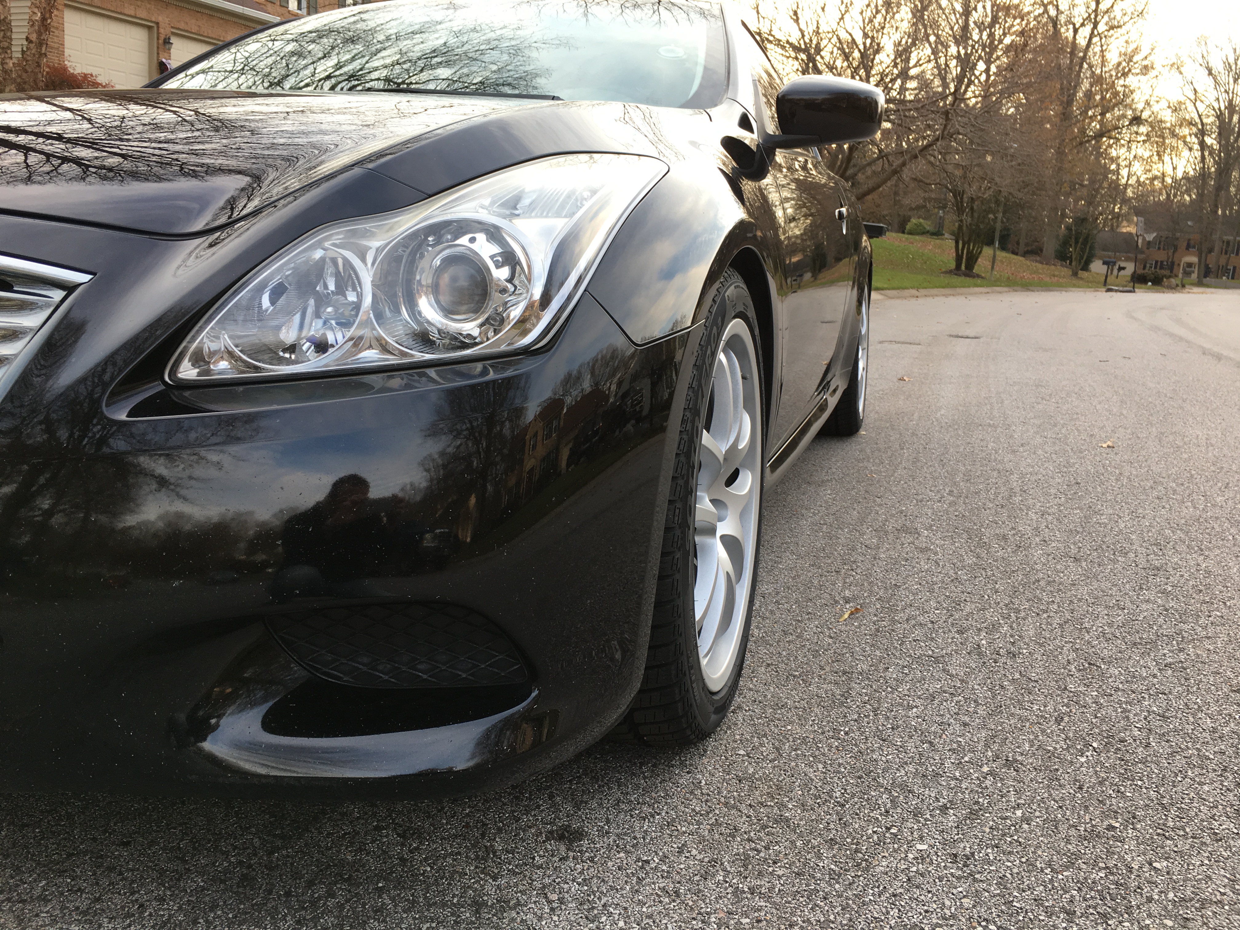

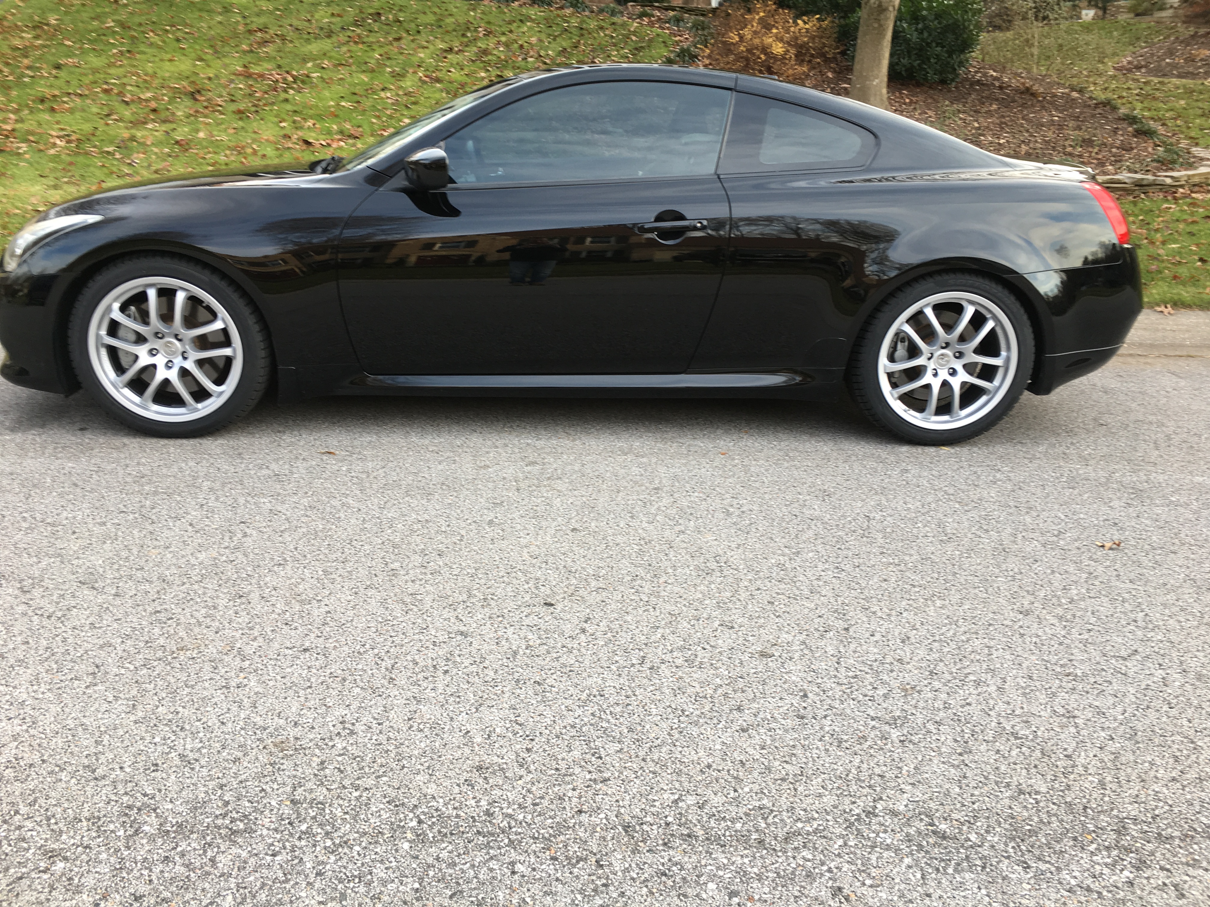

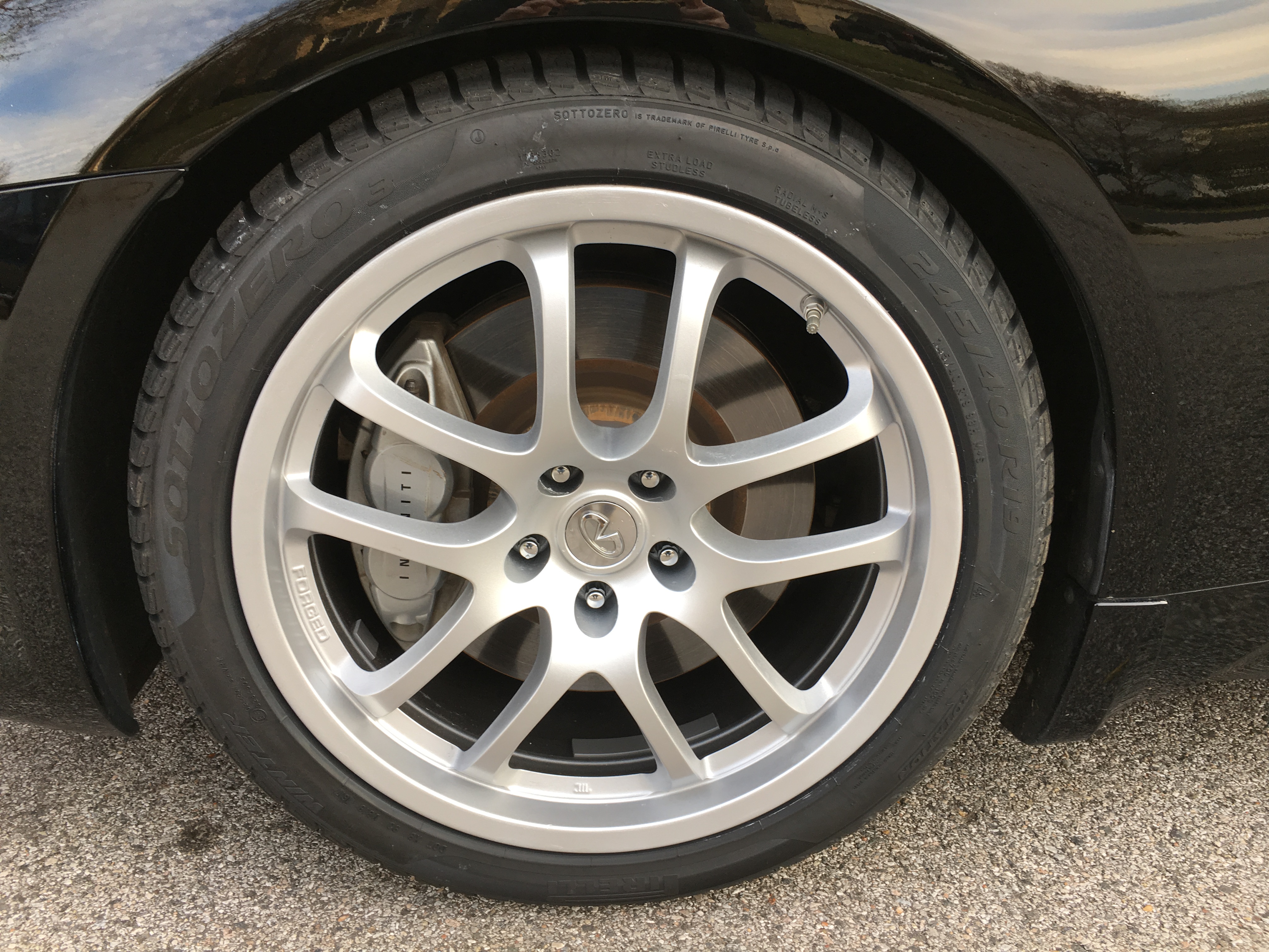

So its winter time so I am back to a squared setup. I changed it up from 18s to 19s this year.
I picked up a set of 4 rear G35 19" Rays which clear the BBK, they were in pretty rough shape and needed a refinish. I refinished myself following the DIY here. Took about a week as I let the metal reinforced bondo dry overnight before sanding and then the paint dry overnight before spraying on the clear coat. If you dont need to bondo, its a day job for a DIY refinish. I probably wetsanded more than needed, but the wheel finish is smooth and dirt glides right off.
The tire are Sottozero3, 245/40R19 size so they match the stock size for the G37S coupe.
Picked up a set of TPMS sensors off eBay for $40 buck and I went with acorn spline drive lug nuts to reduce the risk that the rims get scratched when installing the lug nuts.
If anyone is looking for a winter setup or a squared setup, these wheels fit very nicely.
Attached Thumbnails HELP~All squared setups please post here!-img_1182.jpg   HELP~All squared setups please post here!-img_1183.jpg   HELP~All squared setups please post here!-img_1184.jpg   HELP~All squared setups please post here!-img_1185.jpg   HELP~All squared setups please post here!-img_1186.jpg

Can't go wrong w/ forged Rays, nice look and quality all the way! Nice job on the refresh too!
