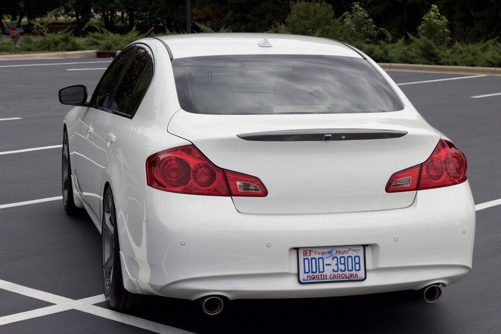

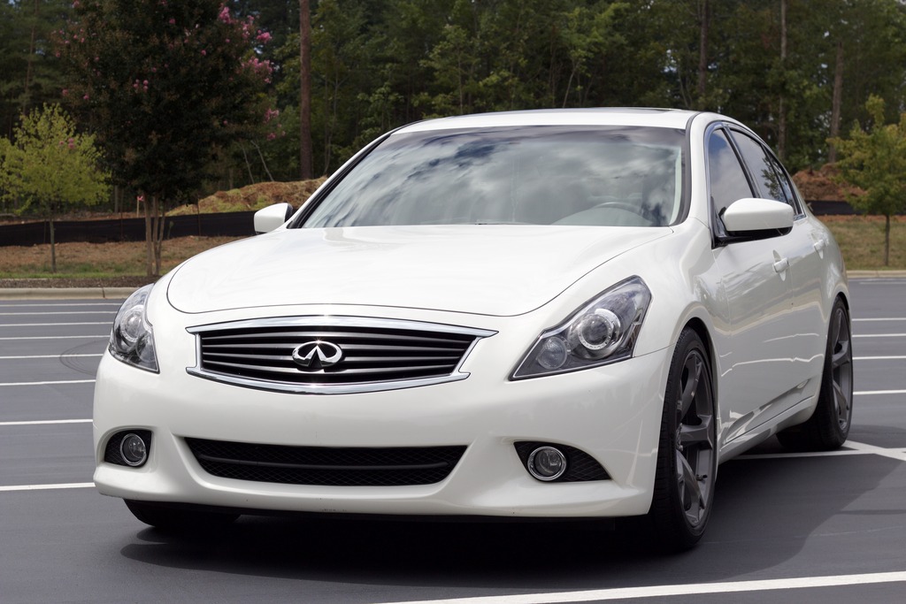

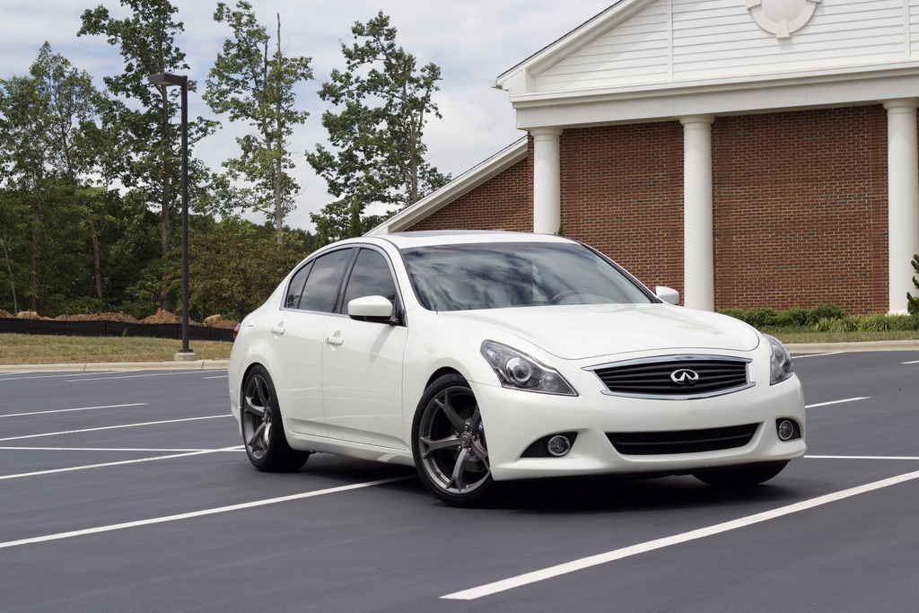

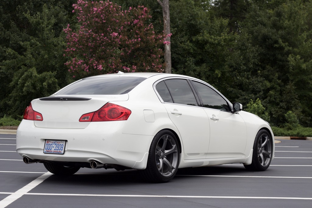

Hoping for a little help with my 2013 G37x sedan. Looking to get some wheels that are available in 18x8.5 +35 and 18x9.5 +30. I am confident the 8.5 +35 will fit easily, but I'd love to stuff a wider wheel and tire if possible. I will be able to drop the car on Fortune coils but I don't want to have to go insanely low to make the wider option work. Any guidance would be greatly appreciated. Thanks!!
Old Aug 28, 2017 | 08:46 PM
  #864
future62's Avatar
future62
Joined: May 2017
Posts: 559
Likes: 48
From: Charlotte, NC
Here is the car that prompted me to go 9.5x +35 all around. I think +30 will be aggressive on a sedan- I am spaced out to 8.5 +30 now and it's pretty much perfect. But yea, this tire height at ~26.25" all around is pretty much perfection IMO
Originally Posted by Gregor12
Old Aug 28, 2017 | 10:34 PM
  #865
Agree w/ Future, is that 9.5 available in something in the +35 to +40 range? If so, you can then run some wide tires out back. I'm running 18x9.5 +38s all around and run 285s in back.
With the 9.5 +30s you'll have to run a 265 max width if you want to keep camber in spec. and even then the wheel edge will be poking quite a bit.

Agree w/ Fortune, is that 9.5 available in something in the +35 to +40 range? If so, you can then run some wide tires out back. I'm running 18x9.5 +38s all around and run 285s in back.
Here's my current setup
Thanks man your car looks great. Do you have a recommendation for tire size if I go with the 18x8.5 +35? Thanks!
