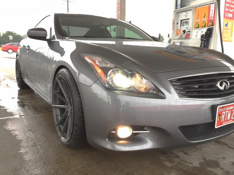

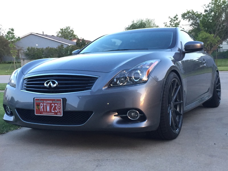

Old Jul 10, 2015 | 08:52 AM
  #175
Originally Posted by dbeachy1
Hey i-heart-ricers, your car looks good! What are your wheel and tire specs? What's the offset??
20x9+35 on 245/35s
Here's his build thread
https://www.myg37.com/forums/build-t...and-enjoy.html

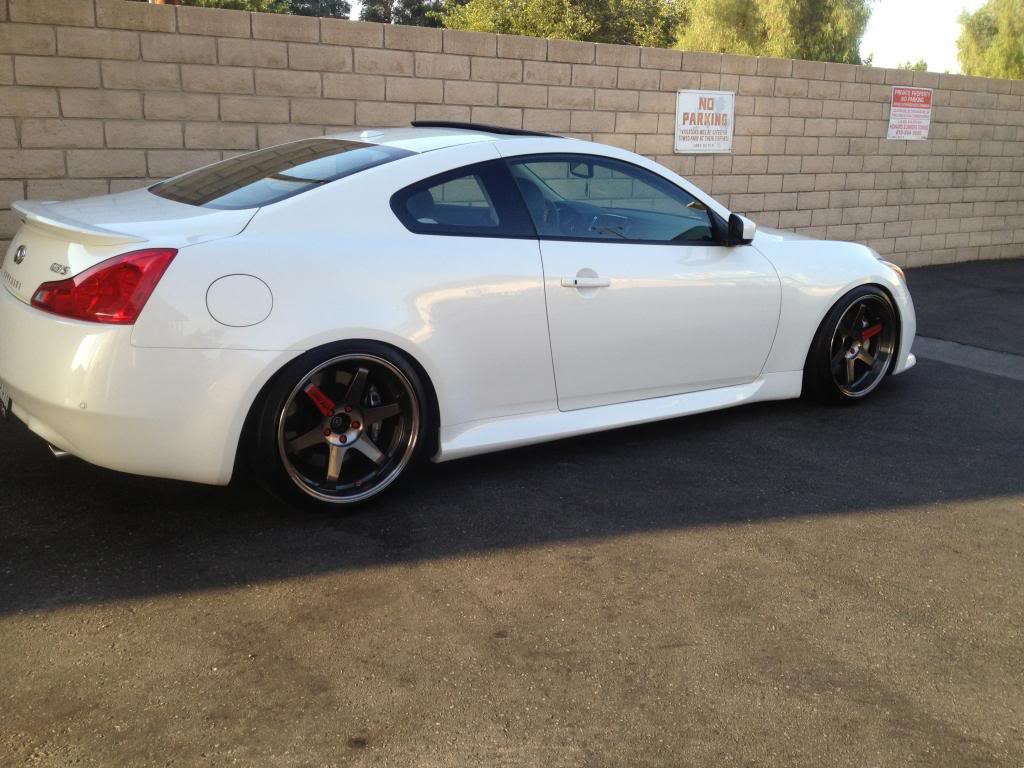

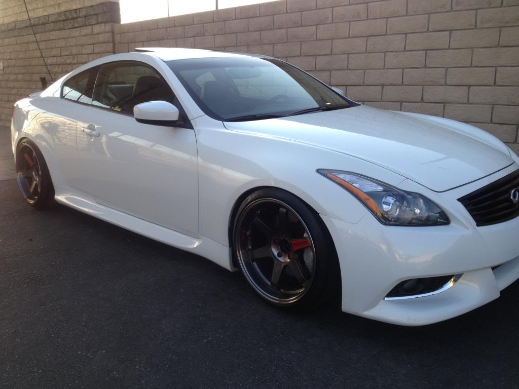

  #176
VA_55's Avatar
VA_55
iTrader: (23)
Joined: Jul 2010
Posts: 1,031
Likes: 20
From: CA
19x10.5 +12
255/35/19 all around
