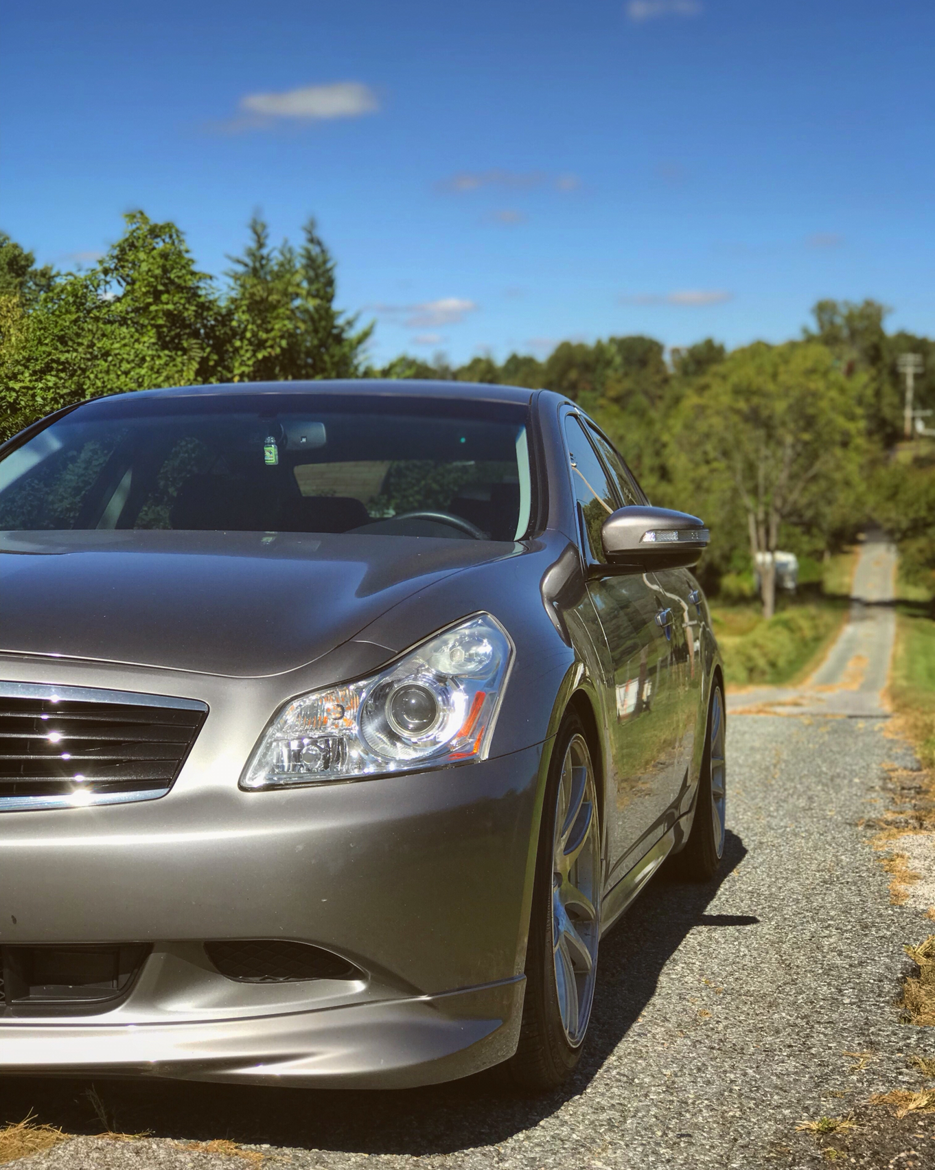

Originally Posted by Bionicman
That sounds promising, but the 35mm offset is giving you an extra 10mm of clearance on the inside over the 19x8.5 +45 wheel I had in mind . . . I'm not sure how critical that difference is. I need to turn my wheel full lock to pull into my driveway, so rubbing up front would be a real issue.
Are the factory 18x7.5 duck feet wheels on the G37xS 45mm offset? I thought I read that somewhere.
That should be fine, 19x8.5 +45 is not very aggressive and you shouldn’t run into any clearance issues inside or out. For reference, I’m running 19x9.5 +35 on all four corners.
