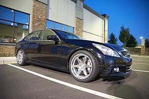

Here's my current setup
I love your setup and would like to have switched to 18s for the cheaper tires but I could not justify the money for those wheels. I got the Rays for 800 shipped from a refinishing company so they were like new. Hard to beat that for forged 19s.
They are so much lighter than the stock wheels--I swear my car feels more responsive.

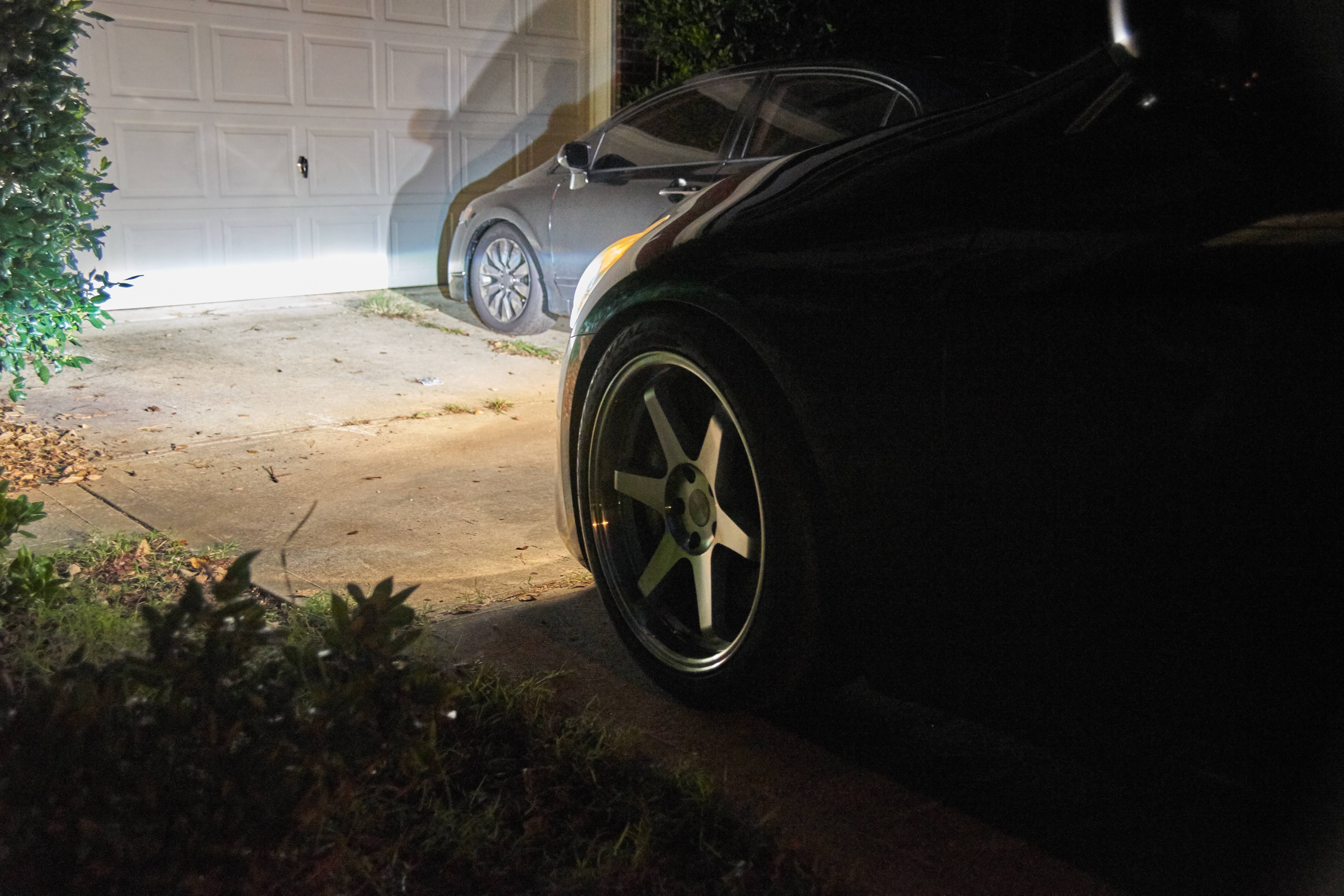

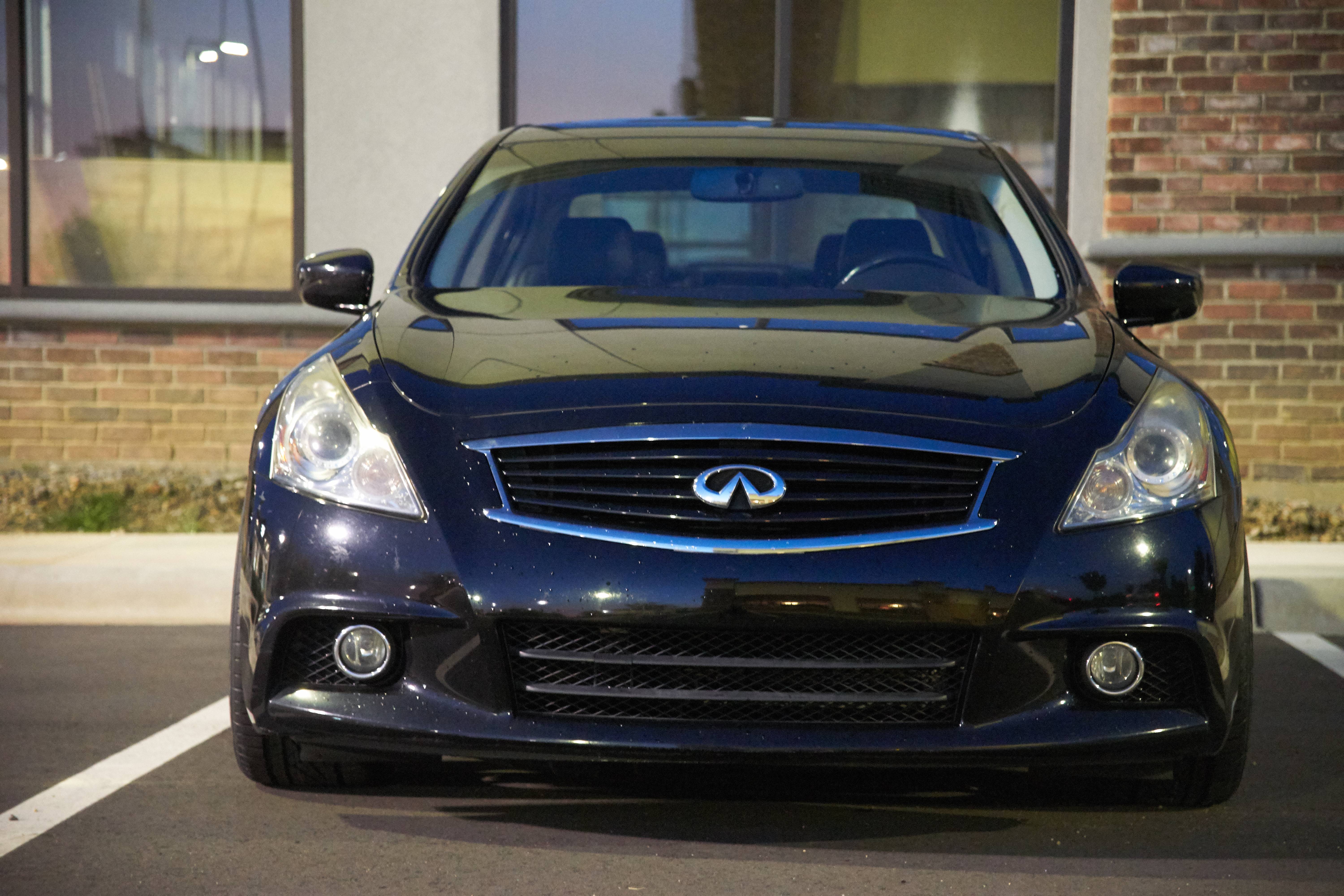

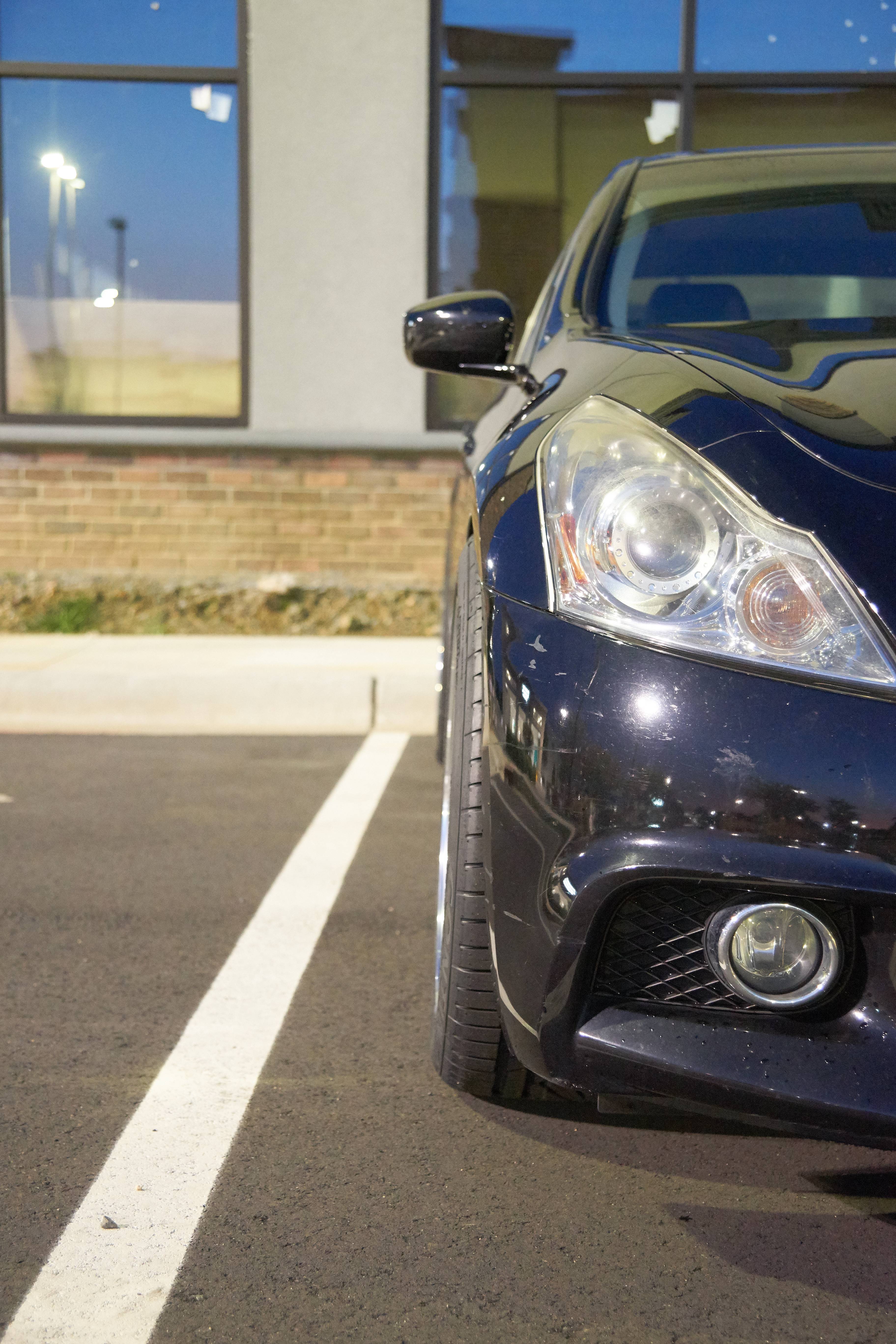

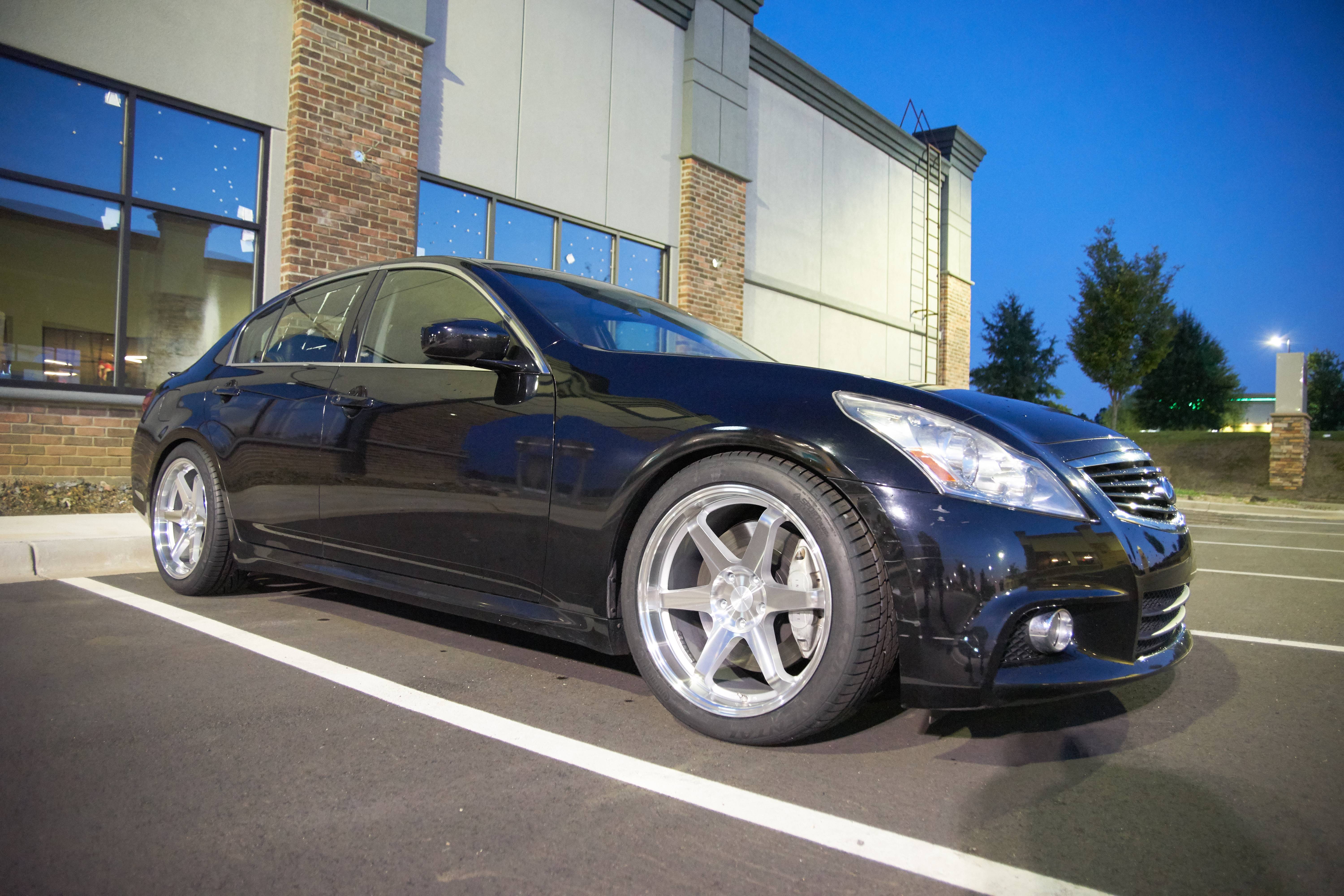

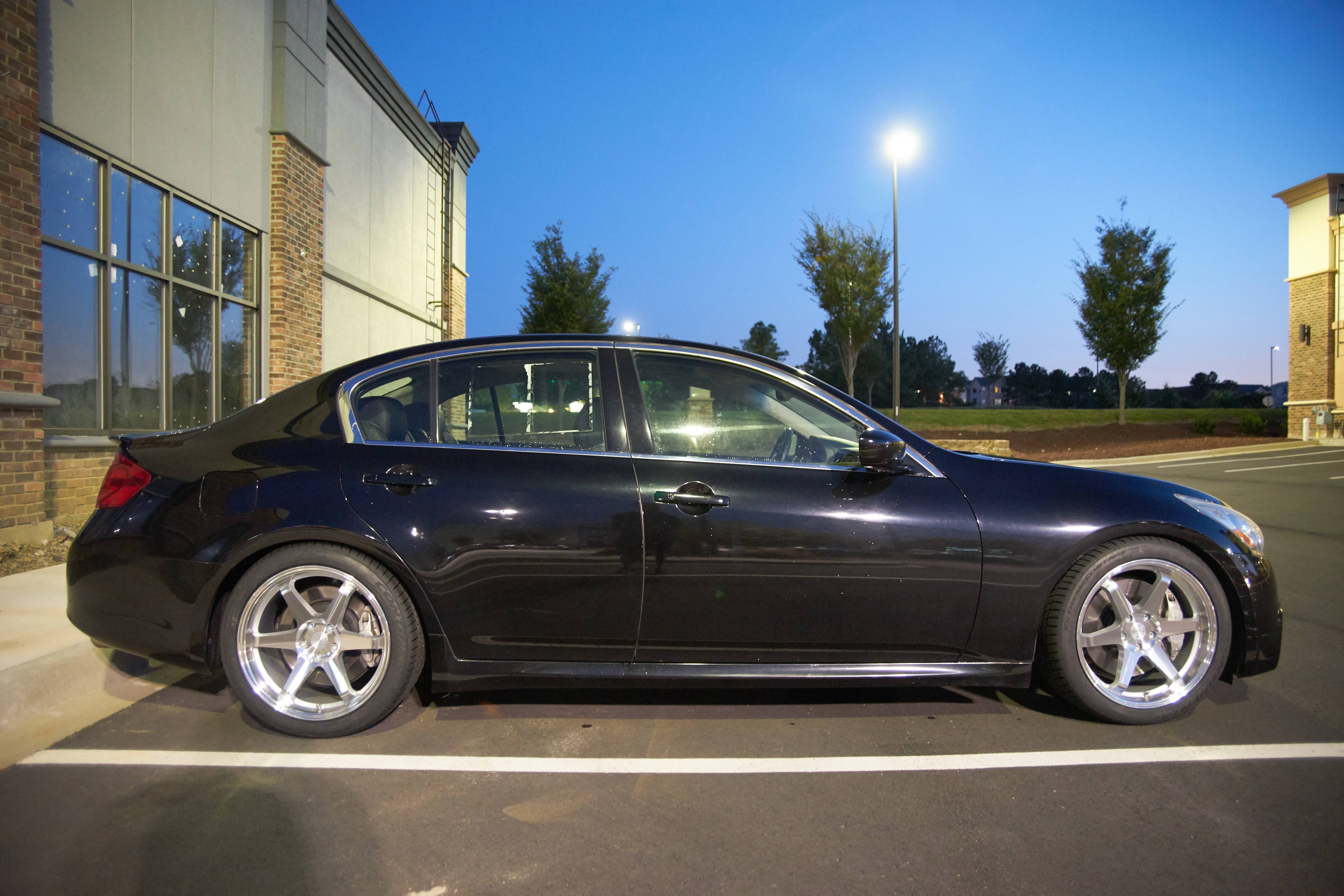

Finally got them on.
ESR SR07, 19x9.5 +35 - 10 from a spacer/+35... these do NOT clear the BBK up front; as is I have like 2-3mm of clearance. Tires are 255/40 Continental DWS06s.

Yea, it was a real adventure. I like the tire size, and I think the wheel size is OK, but a +35 or even +40 offset would have been perfect. +25 is too much. It does seem like my front fenders clear, which is the main thing. I'm gonna check clearance more thoroughly with some masking tape inside the fender.... if there's contact the tire will chew it up.
