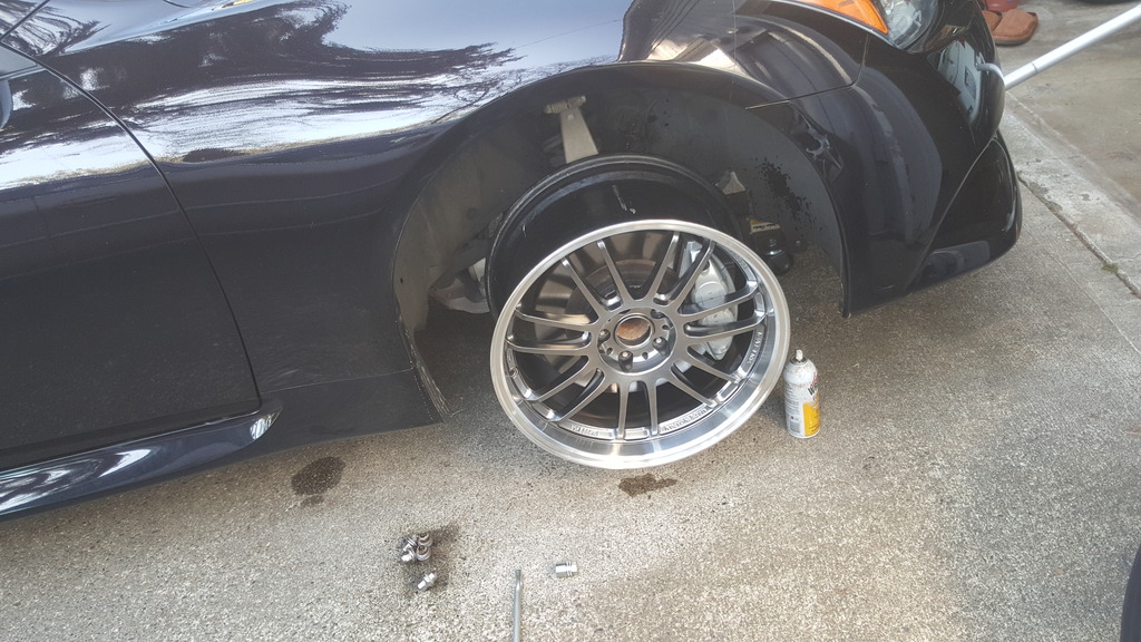

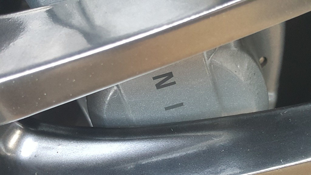

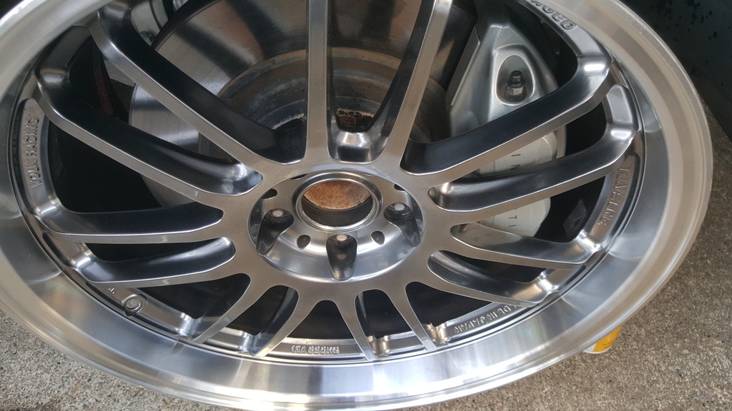

19x10 +30 re30 clears oem akenbono
Update to my situation. Wheels and tires arrived so i decided to see if the front 19x10 +30 clears our oem akenbono. It does with ease 2-3 mm clearance. I found a website that says it does and its face type L1 which gives the most bbk clearance as opposed to L2 which has the most concavity of the re30 lineup.
Thought id share since people run gtr wheels it might help since these are gtr sizes.
Size:  221.8 KBName:  20160407_104517_zpsxltofwvp.jpg
Size:  192.4 KBName:  20160407_104544_zpswar6hfn3.jpg

Yummy^^^
