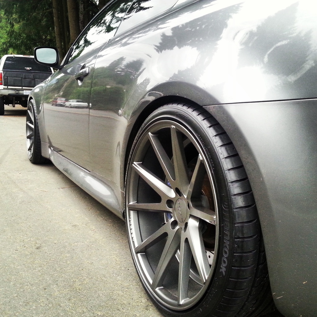

Take a look at this setup then add/subtract to see if it's what you want~
https://www.myg37.com/forums/brakes-...ml#post3891573
Running 10.5 +25 square, so your plans would be~
Front (19x10 +30) 6mm further in for 10" width, 5mm in for offset for a net +11 mm inside from above setup (and this is with a 275 tire)
Rear (19x11 +20) 6mm further out for 11" width, 5mm further out for offset for a net +11mm further out (again, with a 275 tire).
If you like the look of Simpsons fit but less of a chance of rubbing I'd run slightly stretched 255/40 in front
Back could also run a 255/40, this will result in approximately the same fit in back as Simpsons assuming you're running a 255 that doesn't run wide. You could always run a bit more camber in back for a little more tuck.
This pic really shows how close his setup is
