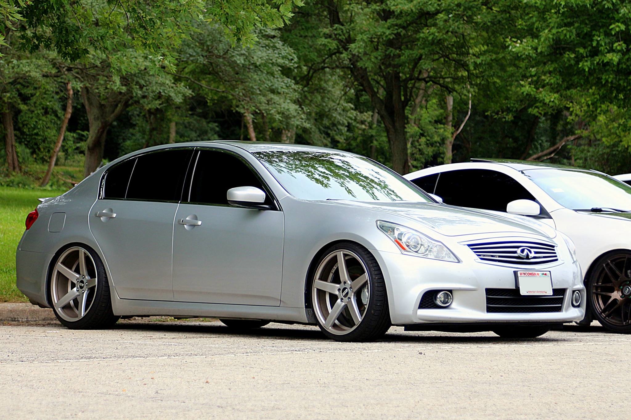

Hi there, i have a question here. I have a '10 G37S Sedan, lowered on Tein-S springs.
Currently, i am sitting on STR607 20x9 (+30)F/ 20x10.5R (+45) , with 245/30/20 and 275/30/20, front has 20mm spacers on.
I am looking into a set of used wheels. They are 20x10 +20 square set, with 255/35/20 tires mounted on. Will the rear fit?

So your current front w/ spacers is a 9 with a net +10 offset, that should have crazy poke. If that's the fit you're looking for then the 10+20 will fit, but IMO it's quite a bit too aggressive, the tires might just tuck but the wheels will be quite a bit out from the fenders.
I might have it mix up, the Front is net +15 offset with 245/30/20
Im not sure will the rear fit at all, being +20 instead of +45. It is .5 inches (12.7mm) shorter overall, i guess.
Im looking for a similar setup like below. see attachment for my current picture.
Thank you sir

If you want that exact setup with those STR wheels they have offsets that are much easier to fit. The 5 spoke STRs in that pic you can run a 9" +35 on 245/35/20s and in back a 20x10.5 +40 on 285/30/20s
Here's those wheels
STR Racing Wheels ? STR 607
