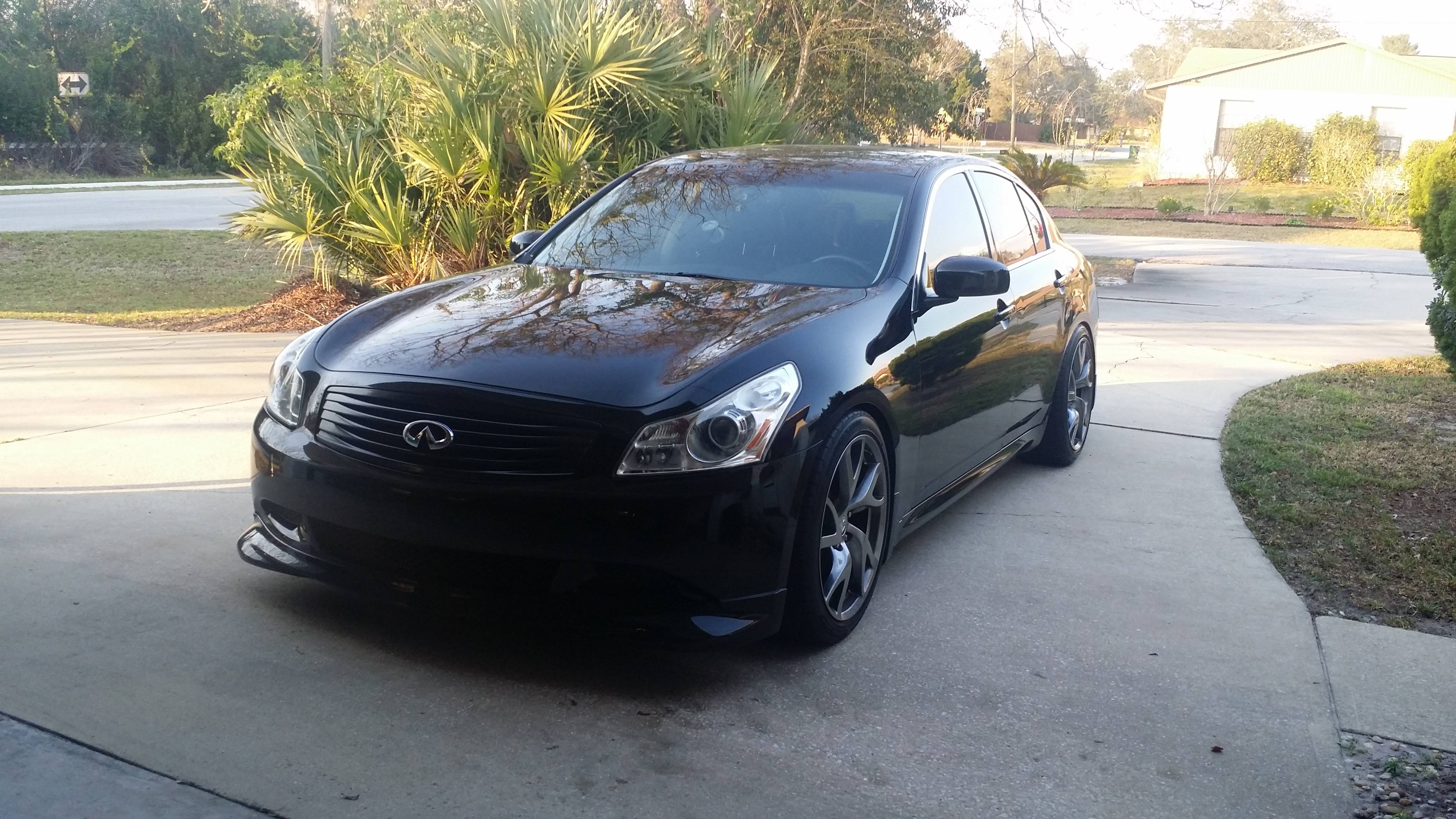

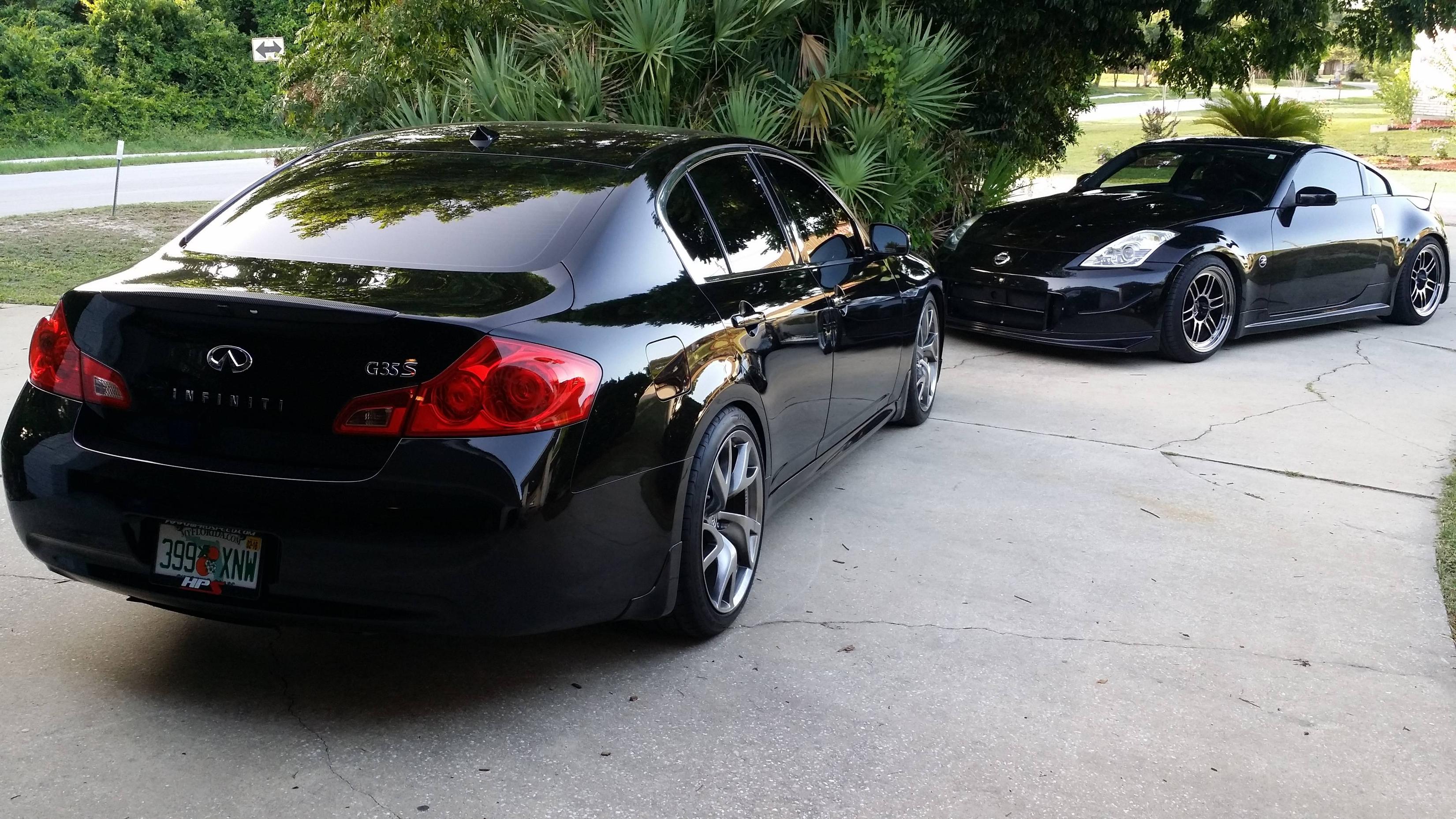

Here's the poke of the 370z in the rear... Everyone i've talked to love it, but i'm still unsure.
[IMG/]https://cimg5.ibsrv.net/gimg/www.myg37.com-vbulletin/1340x2000/80-rear_poke_bcd74d869b162aa8af4f163ccf24887933e338f9 .jpg[/IMG]
12 G37x Sedan w/ 370z Sport Rays 275/35/19 +30
