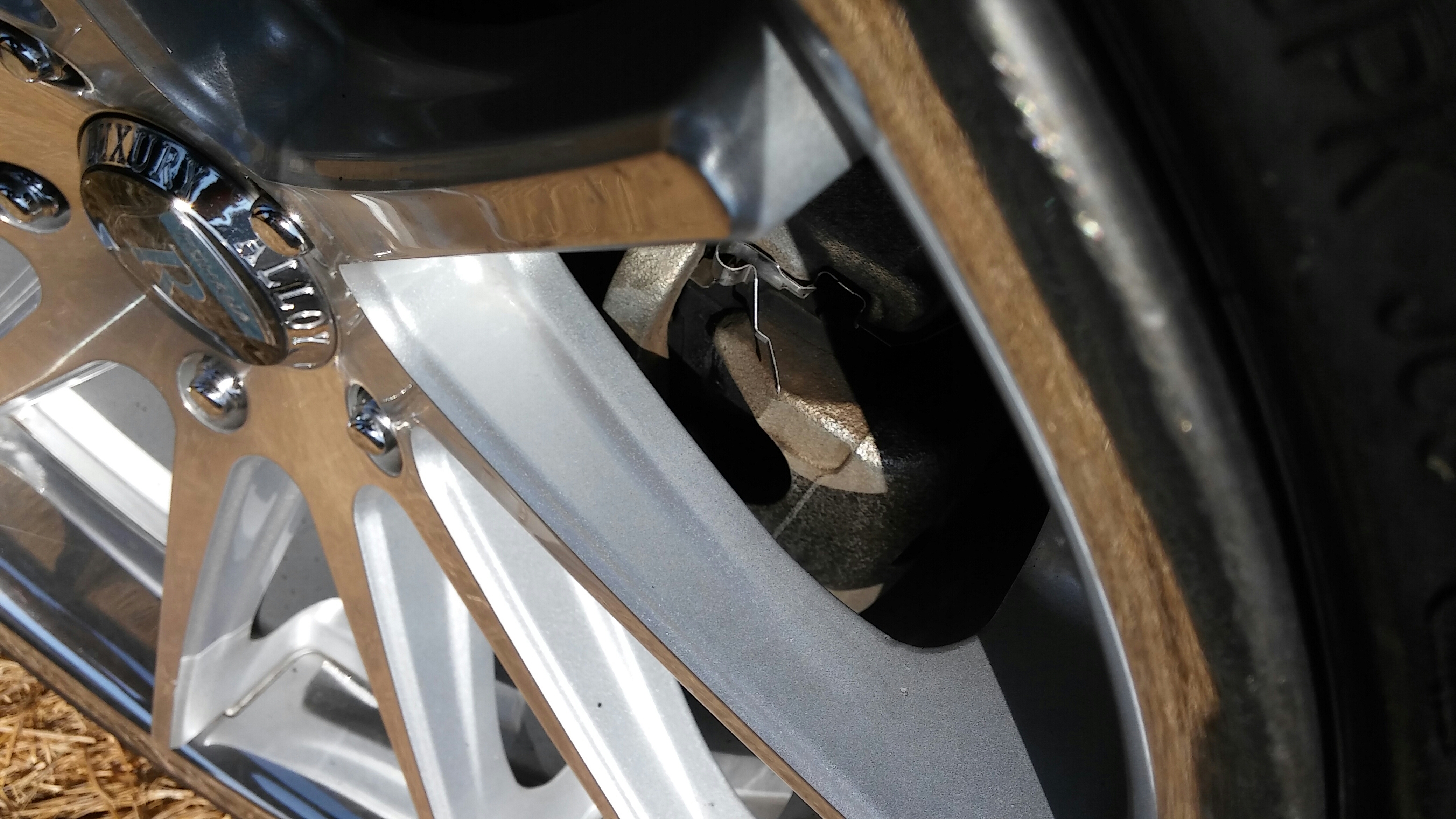

So im running a 19x9.5 setup square with 255/40..im planning to run 265 35 but i feel like the rim is too close to my brakes..maybe im paranoid but it bugs me..question is can i run a 255/35 setup and maybe buy 3-5 mm spacers for the front?
Attached Thumbnails The OFFICIAL "I have a wheel offset / tire fitment question!" thread-20171015_125048.jpg
