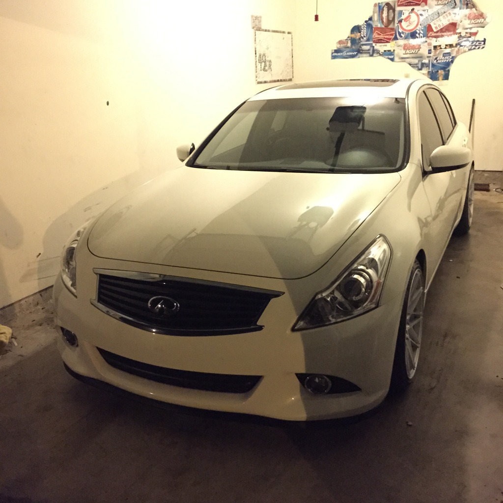

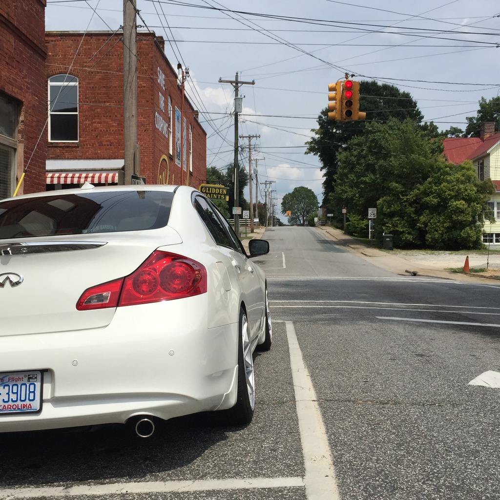

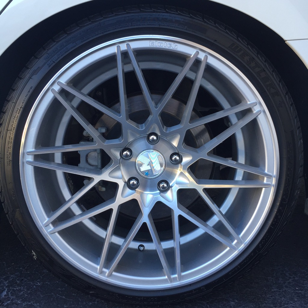

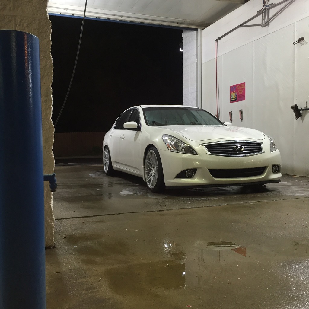

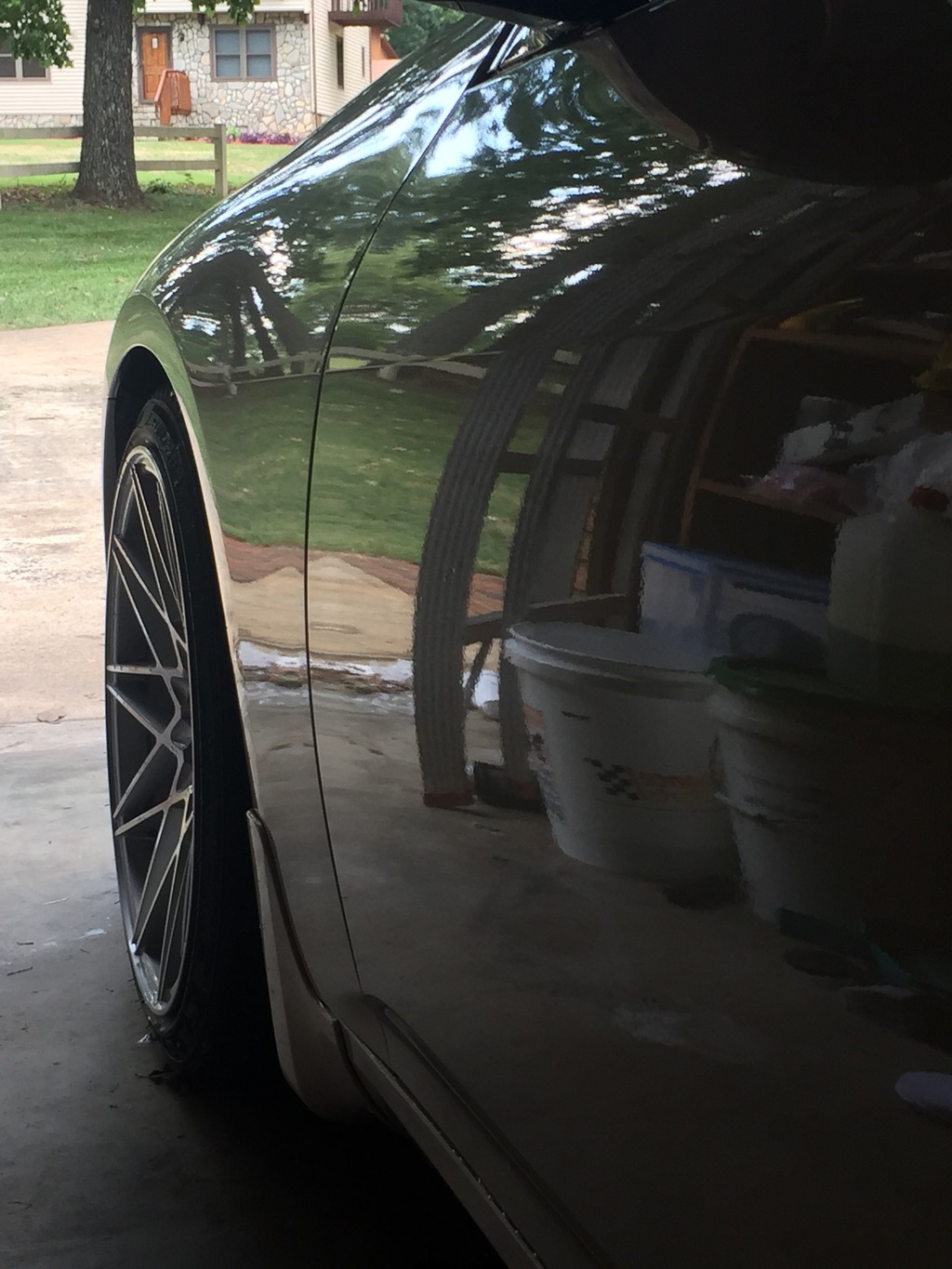

19X10 255/35/19 SQUARE
staggered offsets: (+45 front) (+45 rear)
